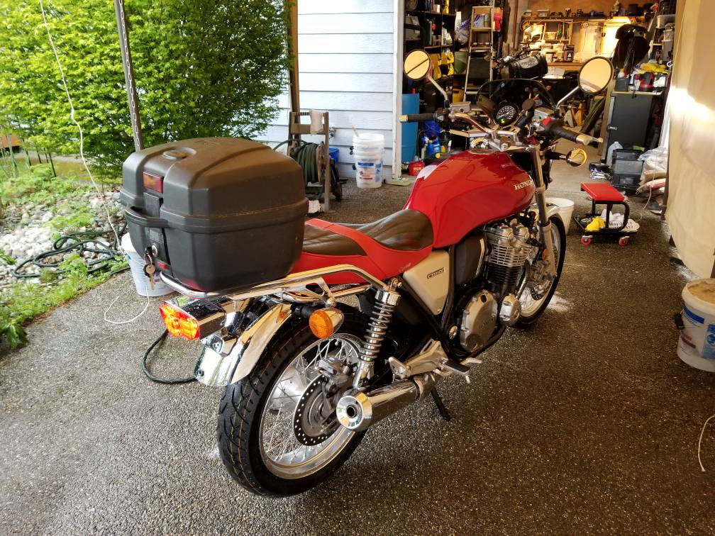

I went with the Emgo top box for $70. It offers an adapter plate and keyed release though. But it is waterproof and durable. Plus it is big enough for one helmet if needed. It carries my camera bag and other gear very well. [Image: 3115fcc5b84d1e22793146707dbe986b.jpg]

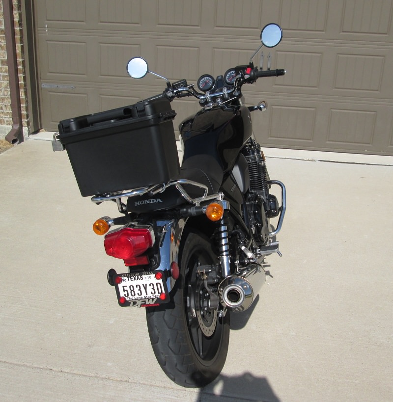

Here's my install of the Harbor Freight "Tactical Ammo Box" item number 64113. I bought it with 25% off coupon for $7.49 + tax. I've seen them advertised recently on sale for $6.99.
Harbor Freight has a variety of box options in different sizes, materials and prices. I'm waiting for my Hepco & Becker 42-quart monster to arrive from Germany via ebay -- meanwhile I wanted something just to carry essentials for day trips without the previous hassle of cargo-netting a little backpack on and off every time I stop to use the bathroom, grab a drink from a gas station, etc.
The install on a Hepco & Becker rack:
1. Get the box using a coupon (pretty easy to get their coupons ... they email them to me, so I had several the cashier was able to scan off my phone).
2. Go to Home Depot and get #308 3/4" pipe U-bolt clamps for $0.98 each. I used two -- four is also an option. These are zinc but they also have stainless steel ones for three times the price.
[Image: 884337323b9edbef5304d838d535022b.jpg]
3. I centered the box on the rack, used a bungie cord to hold it in place while I positioned the clamps at the bottom and marked where the holes go with a silver Sharpie.
4. I rechecked the hole positions, used a drill (small starter bit, then larger) to drill the holes, then smoothed them out with a round file. My largest drill bit was the correct snug size for the clamps.
5. Insert clamps from the bottom and tighten then up using a 7/16" wrench. A long socket will be the next investment for popping it on and off quickly. These will be "snug" tight as the plastic and clamp long washer will deform as you tighten it down.

Took it on a 65-mile test ride, speeds from 30 to 80 mph. No issues. The usual clunk of loose contents rearranging on hard bumps, but that happens even with the most expensive top cases. Here's a side view ...
[Image: 0265bf908439de6b1400fcc128554034.jpg]
