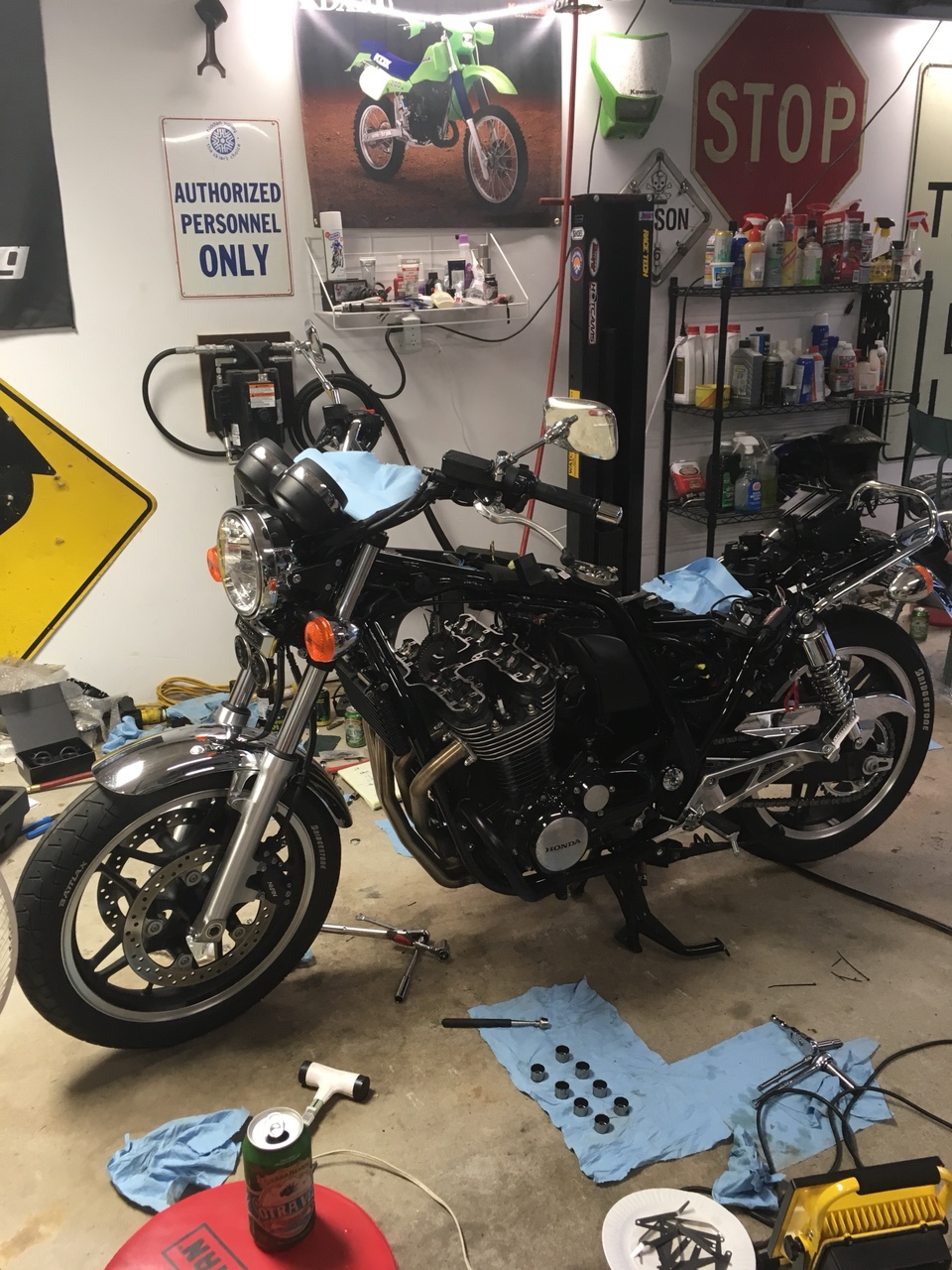

After measuring the clearances several times again on the new cams last night– I just uninstalled them and the buckets and now I get to do more math.
Gee whiz thanks, fun.
Really hoping for good results. Anyone want to take a guess? Start a pool?

Well- just sat down and did the math. Another delay as I will be ordering more shims.

Just ordered 9 shims from Honda online as I needed higher resolution than what the Hotcam kit can provide.
..so we wait again.
Hope my measuring is good- or we may wait again again on more shims even after this. I'd buy a bunch of izes to be safe- but they are not cheap, which is why I originally bought the hotcam kit trying to avoid all this- not knowing it does .05mm steps instead of .025 like Honda does.
