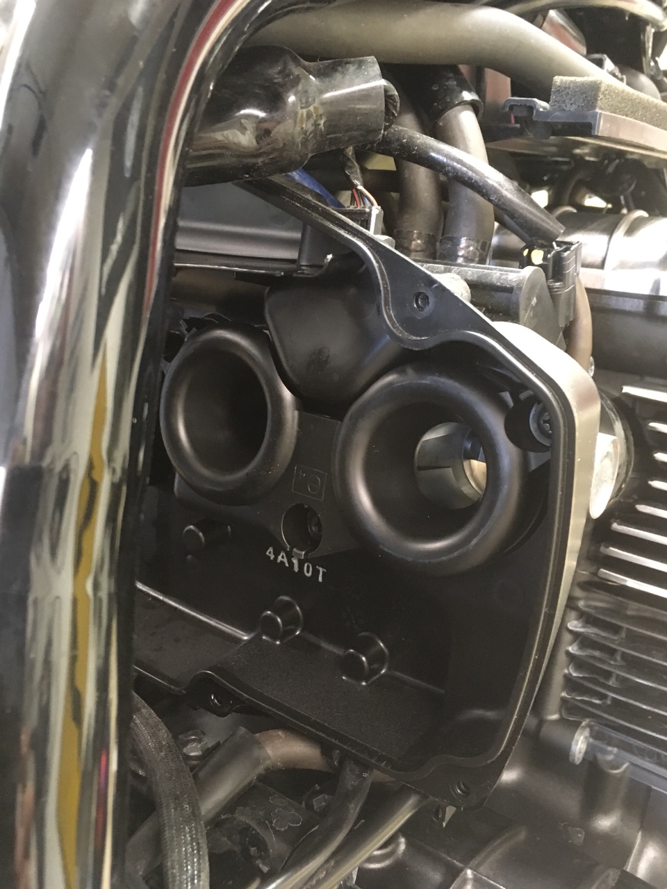

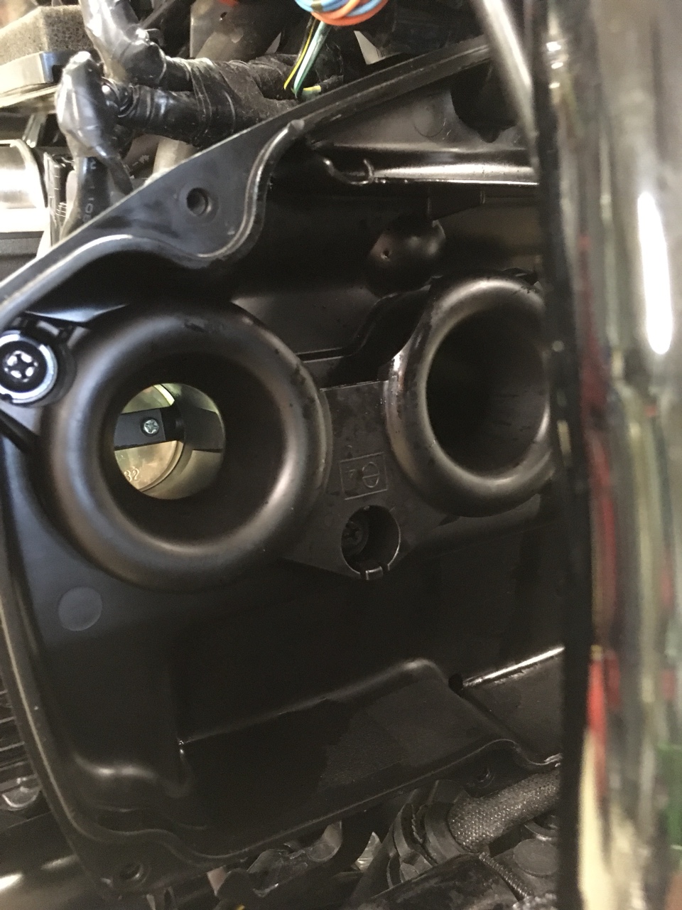

SOOO- the headers are on- and yea, when I fired it up to check for leaks there is definitely an increase in decel popping. Currently installing the power commander and auto tune. Will block pair.
Modified velocity stacks will go in at cam install time.

So... while waiting for my cams to ship to me, I went back to the local dyno again for a final baseline before cams #, and more importantly curve.
The difference between these runs is I added a arrow header, my modified velocity stacks, and fuel with the power commander / autotune that I am still playing with.
Amusingly I am running a little leaner 7k+ now even with my (clueless) tuning.
I will be fixing that once my POD300 shows up and I can see what the real world data is while riding.
Going to try to get the number closer to 13 across the board, but not concerned about fine tuning now as it will all change once the cams are installed.
Anyway- the best modifications are the ones with no losses (wot)...
