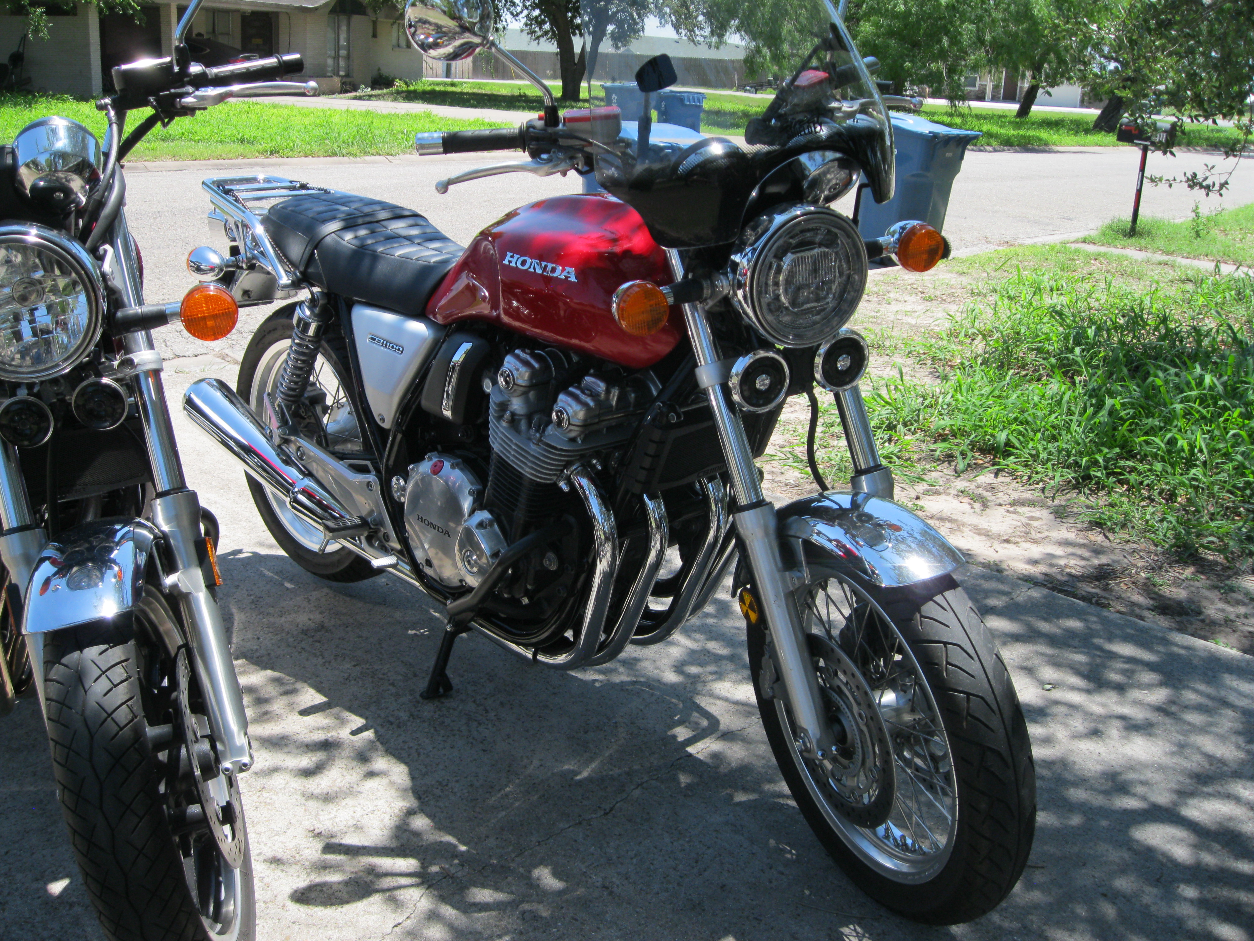

I am going to re-post this picture of the back of my 2013 CB on the right with SW-Motech Crash Bars, and the 2017 EX in the Middle. I have posted before how, in my opinion (and the photos) how much better the Crash Bars from China protect our bikes. They cost about 1/2 as much as the SW-Motech, and almost look as good.(fit)
My only complaint with the ones from China (bought off Ebay), is that they do not provide an acorn nut to cover their bolt. Sold I bought a few from Home Depot.
Blow them up and take a look.
[Image: ecef1f09067cf0a6cfe7616ad5235811.jpg]
This is an excellent viewpoint to show just how close the SW-Motech Bars are to the engine, and how small of an impact would be needed to smash them right into the Engine casing!
[Image: 81044f8cd5164c1dd95d9825890e5b45.jpg]
I bought OEM Crash bars for the DLX. Just not on yet, because I wanted chrome ones to go better with the chrome features of the DLX.
