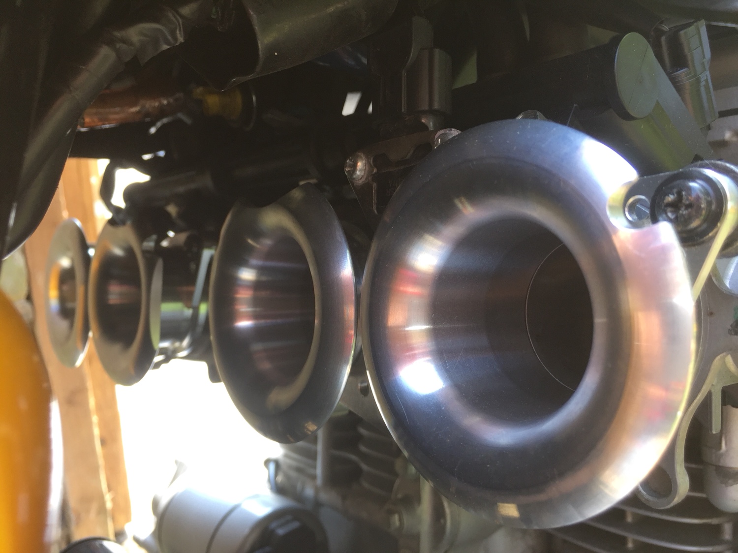

![[Image: 6c62c62ae347130f515b5ff84e2f96b0.jpg]](https://cb1100forum.net/forum/uploads/imp/201805/6c62c62ae347130f515b5ff84e2f96b0.jpg)
You asked for it really....
Also... it goes really well! I took it for a long ish run, 150 miles on Sunday morn. Thru fog and high speed motorway as well as sunny, country lanes and she ran great. Fueling was spot on. Pulled well from nothing in any gear and the top end rush felt really strong.
I’m leaving it like this for a bit

If I remember correctly, you have the auto tune? If so, I’d let it run and see what the changes are. If it adds fuel, you’ve added air- which is power.
Looks great - I’d just rubber band some pieces of nylon stockings over each to keep out debris.
How does it sound? Should be louder and more aggressive in tone as you will hear individual intake pulses.

Sounds demonic at full tilt and you can hear it gulping air low down.
I checked the Autotune when I got back and the trims were +fuel. It's also running a bit leaner I think as I'm getting more MPG.
I'm going to run it a while longer then maybe apply the trims and see what happens.
I must say the bike just keeps getting better...

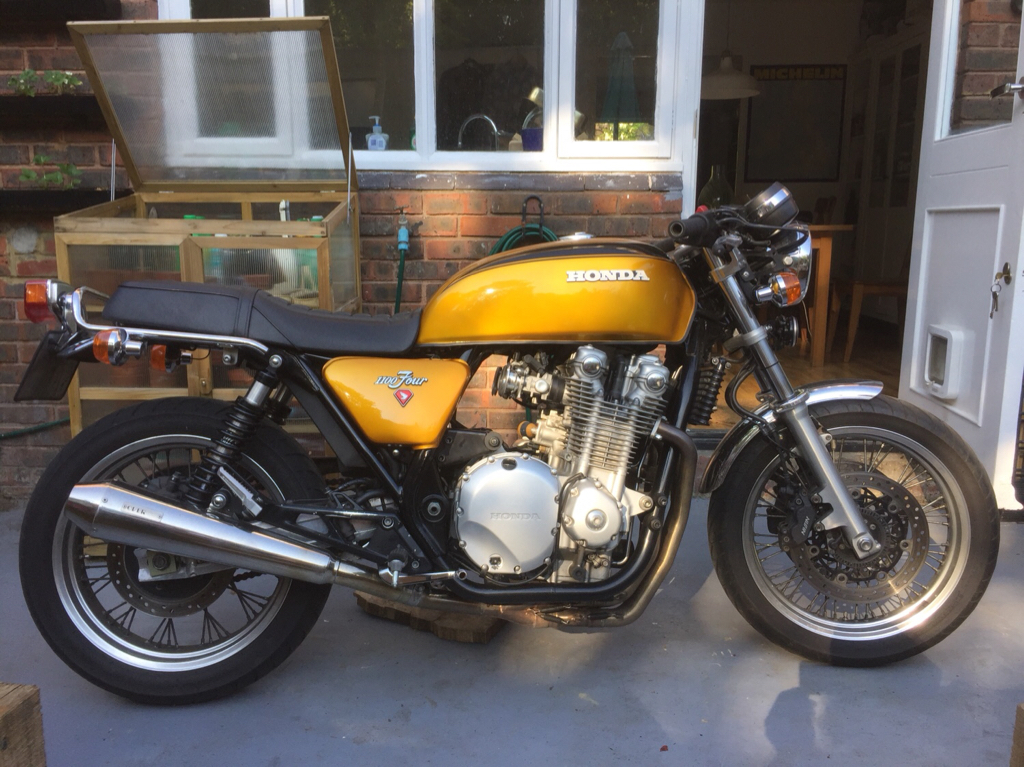

![[Image: aa758df6315b89a8f1d1abdd679f4fd7.jpg]](https://cb1100forum.net/forum/uploads/imp/201805/aa758df6315b89a8f1d1abdd679f4fd7.jpg)
I was going to put something over the mouths but was concerned that they might get pulled into the throttles. Thought about some foam filters but seems such a shame to cover those beauties up...

You say you are running a little lean after taking the air box off? There is a setting in the autotune for how much you will allow it to adjust the mix. I'm wondering if you need more fuel than the setting will allow until you apply the changes and run again.
2014 / 2017 airbox snorkels - PowerDubs_imp - 05-23-2018
Running lean is bad. I’d adjust the trims immediately after any major changes affecting airflow.
Cams are still being made. I’m currently on a tour of several countries in Europe so I in no rush.
Sucking anything into an engine is bad, but I’d definitely have something. There- oiled foam socks would be best, but for short term I would be ok with pantyhose.

It's the duck's guts..... If anyone will get the Mad Max Interceptor ref.
(If not, you can see it here: https://www.youtube.com/watch?v=8bQzkdK2ha0)
