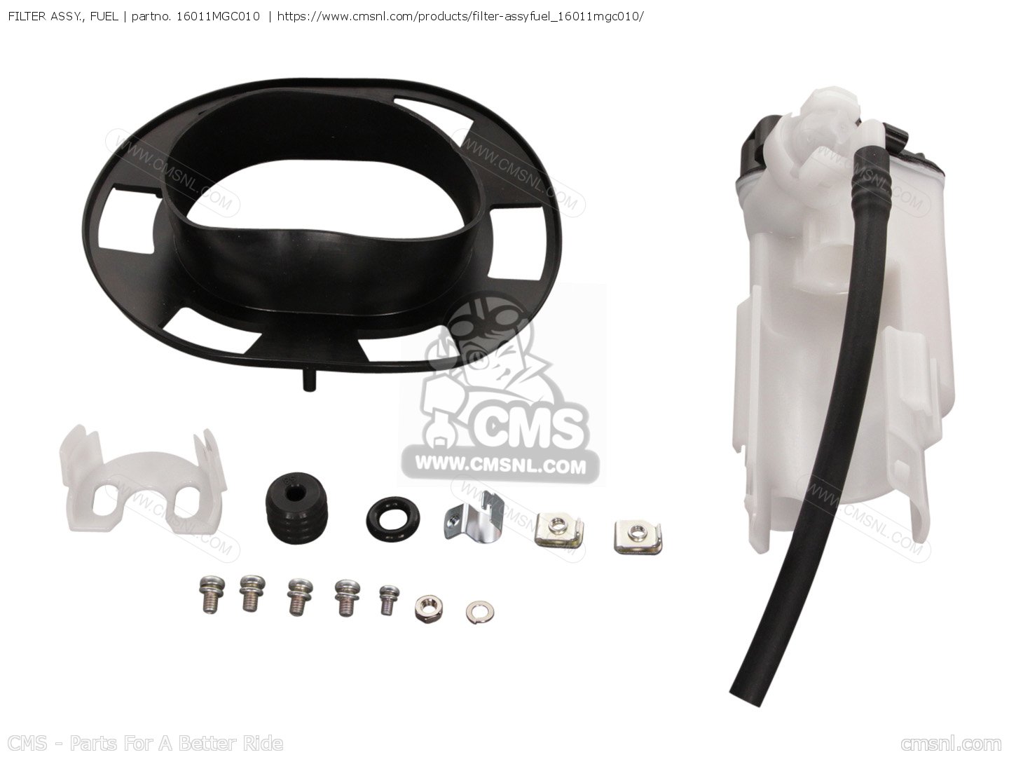

(02-08-2023, 01:46 AM)Lord Popgun_imp Wrote: Looking at the fiche it appears it isn't just a filter, but includes the motor.
I think that it's just the filter.
[Image: f5776cdf787e59c93bb50ab9b2c0c6de.jpg]
