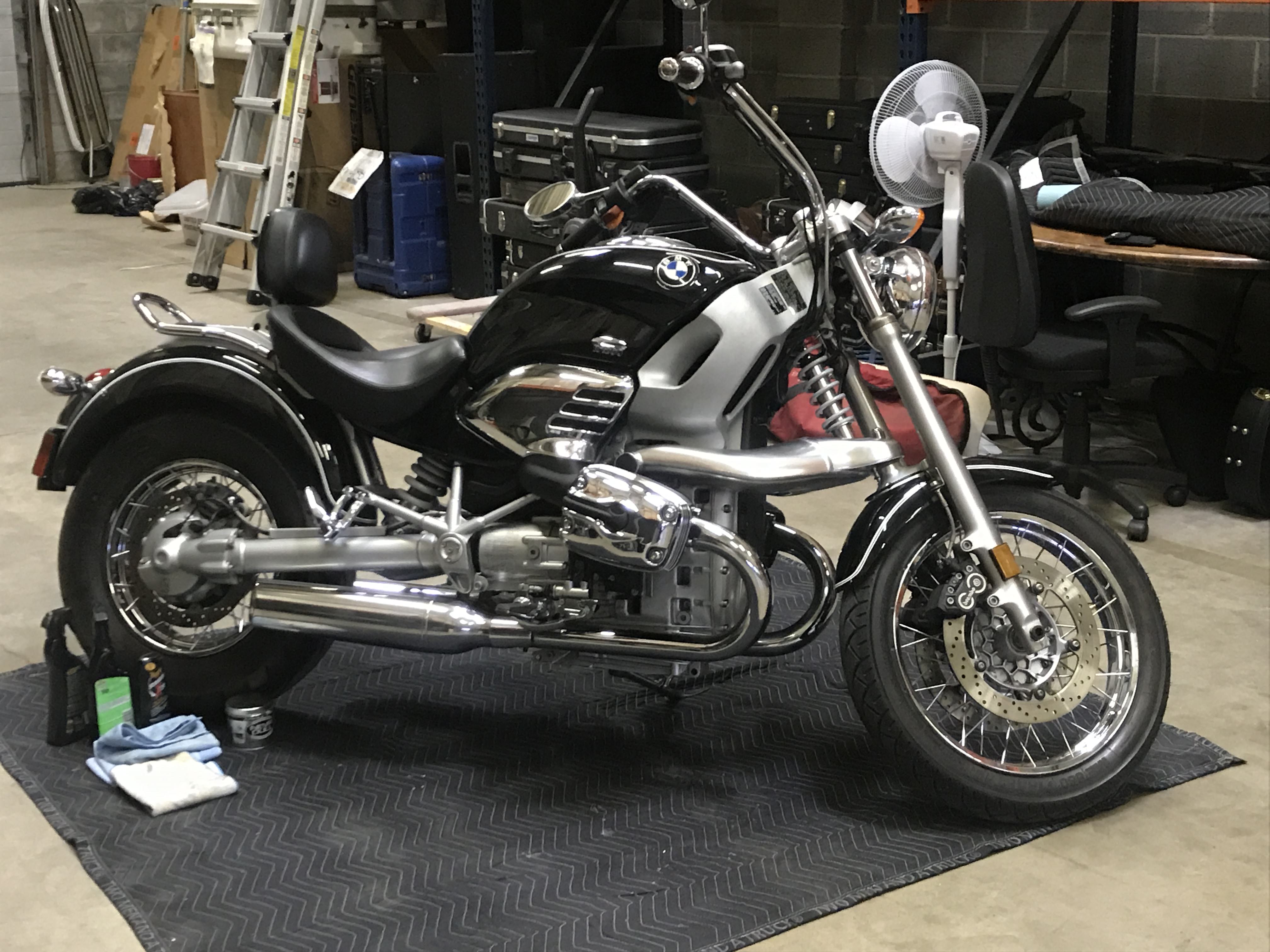

(05-10-2018, 10:51 AM)The ferret_imp Wrote: Good deal. Glad you are back on the road.. With both bikes. THose 1200c Beemers are certainly different. i've heard they are pretty nice bikes though.
Different indeed, but I've had the cruiser since new over 20 years ago and it fits like a glove. It's really a nice complement to the CB1100. While both have roughly the same oomph, the Beemer is much heavier (and feels more stable at highway speeds) The CB is definitely the more nimble of the two.

RE: Dropped Bike / mirror issue - Nortoon_imp - 05-11-2018
At first glance I thought what an odd looking machine. But looking at all the features of the bike changed my mind.
Modern Earles style forks
Single arm swing arm
Shaft drive
Chrome heads on the boxer engine
Chrome exhaust headers
Comfy seat with a back rest, when it's not the passenger seat
Ape hangers with bar end mirrors
Frame blended into the motor
Somebody had fun designing this machine
