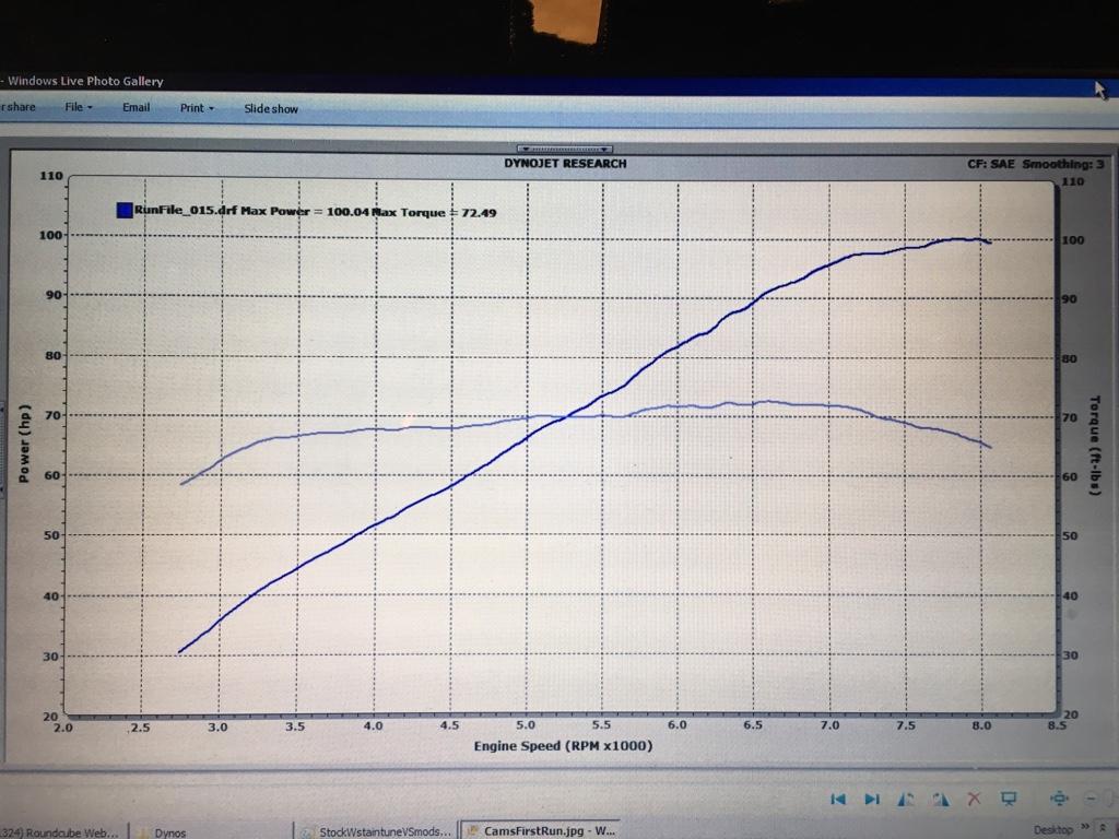

Finally got to actually ride it. - PowerDubs_imp - 09-26-2020
I’m at 100whp and 72wtq on the dyno with stock ECU, so neutered ign timing and redline. Could have used a little more fuel.
I then put the Guhls ecu in and crashed the bike on the first ride afterward - only a few miles from my house.
Bikes fixed- I just haven’t been back out on it yet. Need to re-register and insure.
Should make better numbers now.
Also have Ikon rear shocks and ‘17 DBV forks. Both are excellent.
[Image: 0bd42fc8c3ce89346d7a9bc280e55564.jpg]

(09-26-2020, 01:03 PM)PowerDubs_imp Wrote: I’m at 100whp and 72wtq on the dyno with stock ECU, so neutered ign timing and redline. Could have used a little more fuel.
Which Ikons did you get? I wrote them complaining that their website provides little information on the differences between 7610 and 7614. Also where is the spring rate chart? They responded telling me a few more specs and that they are revamping their web presence. It appears for the extra 50%, you get more PL instability and gas charging. They said the springs are chosen at checkout. I am giving thought to the 7614's. The DBV is the Delux?
Can you summarize what were the total mods done?
