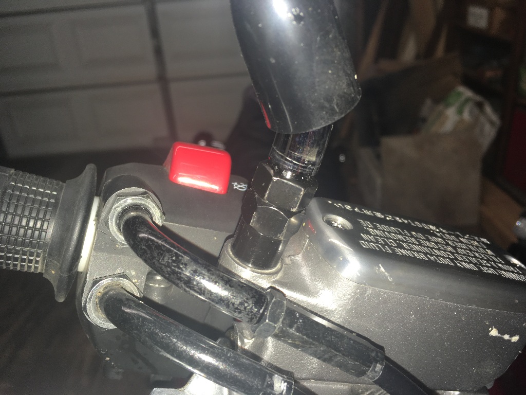

It'll look like this when all snugged down...

Yep, that's what mine looks like and you only need to loosen the top nut. On one mirror it turn clockwise to loosen, the other side counter clockwise to loosen.
RE: Dropped Bike / mirror issue - tommymck - 05-08-2018
That's what mine looks like also. Thanks for the pic! The issue on mine is that the nut on the stalk is backed off all the way to the top of the thread and won't turn. It's probably tight enough that it just didn't want to loosen up. I'll try a piece of cloth on the stalk with plyers as I try to back off the nut.....

Just make sure you are turning it the correct direction. I think that is a left hand thread, try turning it the opposite direction of the way you did when you couldn't loosen it. Pliers are a good way to scratch things up, even when using cloth.
RE: Dropped Bike / mirror issue - the Ferret - 05-09-2018
ok just went out and checked.... 14 mm box end wrench (open end) on both mirrors.....lift rubber, turn jam nut (the top nut) clockwise to loosen...adjust mirror stem to where you want it and then hold stem and turn jam nut counter clockwise to tighten. Dooesn't have to be gorilla tight, just reasonably snug.
even though 1 mirror screws out and re installs in opposite direction. If jam nut is really tight, you may have put hold the bottom nut with another 14 mm box end wrench to break the top nut loose.

I managed to sort it out. It turns out that the top nut was tightened all the way to the very top of the threads on the stalk. So hard that there didn't seem to be a way to loosen it (it wasn't even clear that it wasn't somehow welded in place.) Knowing that it was possible made all the difference. It's all adjusted perfectly now. Thanks for the help.

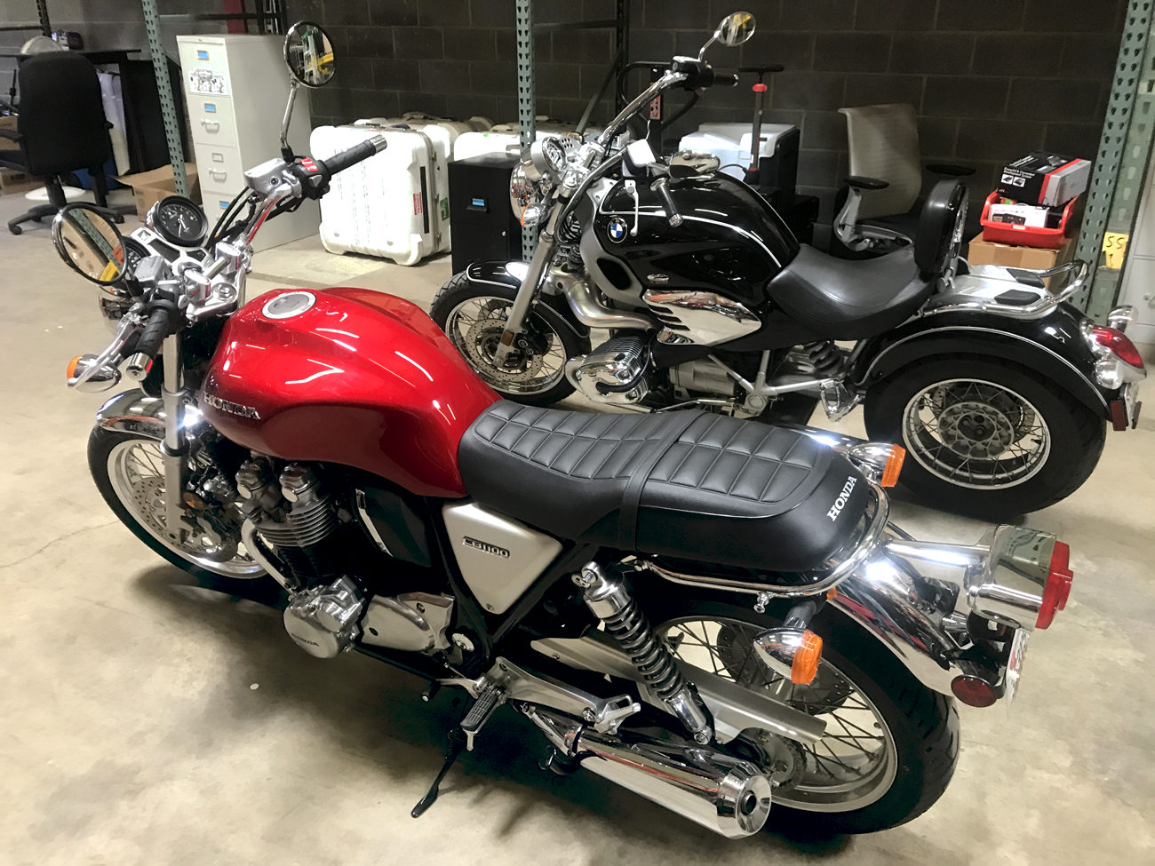

I also spent the time replacing the intake manifold on my R1200C. It's back on the road now also. First time I've ever had two bikes co-located at the same time. Having options is nice.
In any case, I'm still shocked at how well the bike took the drop...
