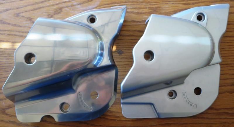

Picture of 2014 aluminum cover vs. a plastic 2013 cover in silver:

CB4ME,
I bought this aluminum sprocket cover and mine didn't come with any bolts. I mounted it with the stock bolts and swapped the rubber grommets from the plastic sprocket cover to the aluminum one. After tightening those two top bolts my cover wasn't solidly mounted at all. Because those bolts pass through rubber mounts that cover moved a lot. Did you do away with the rubber mounts?
In any event I fabricated a simple aluminum bridge that makes the bottom hole bolt to the engine like the top two, keeps all three rubber grommets, and uses all three stock bolts. Now that bad boy is rock solid with no dummy bolt holes.
I'll put up a new "Chip Beck Spec" thread with pictures and instructions in a couple days. Cheers.
Chip
Chip - I had asked Mr. T to provide 3 silver bolts to match the aluminum cover (not knowing only 2 bolts lined up). I didn't use the rubber grommets from the plastic cover.
I may be the first one to steal your new innovation with the aluminum bridge. While my sprocket cover is very solid, I never liked the idea of a dummy bolt on the CB.
I'll look forward to your post explaining the third bolt mod Chip. I have the aluminum cover on my 2013 with the dummy bolt and I'd rather have a more solid mount.
