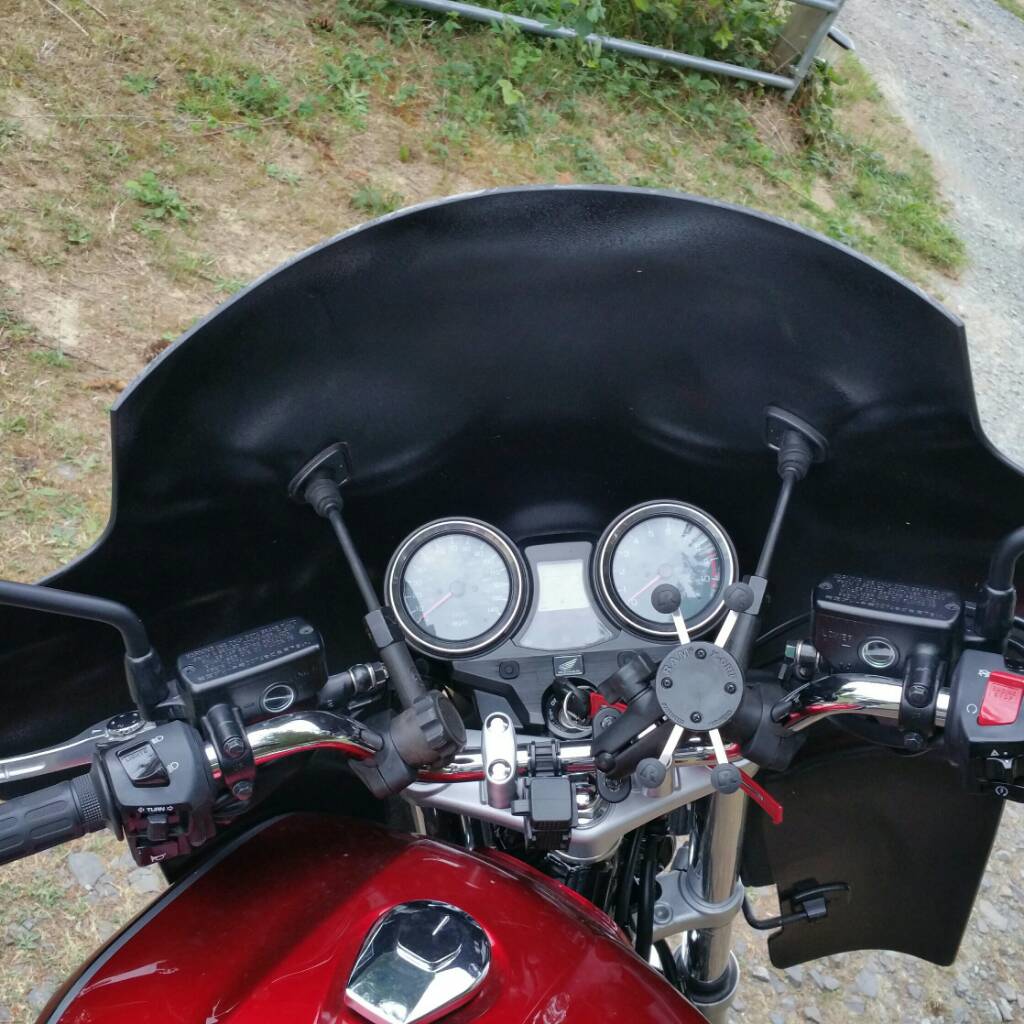

I mounted a usb socket to the handle bars next to a ram mount for my phone or gps.
[Image: b6d73ec4c04fda8f300ca6157ea8d518.jpg]
Here is a link to the outlet:
http://www.amazon.com/gp/product/B00SIKV...ge_o00_s00

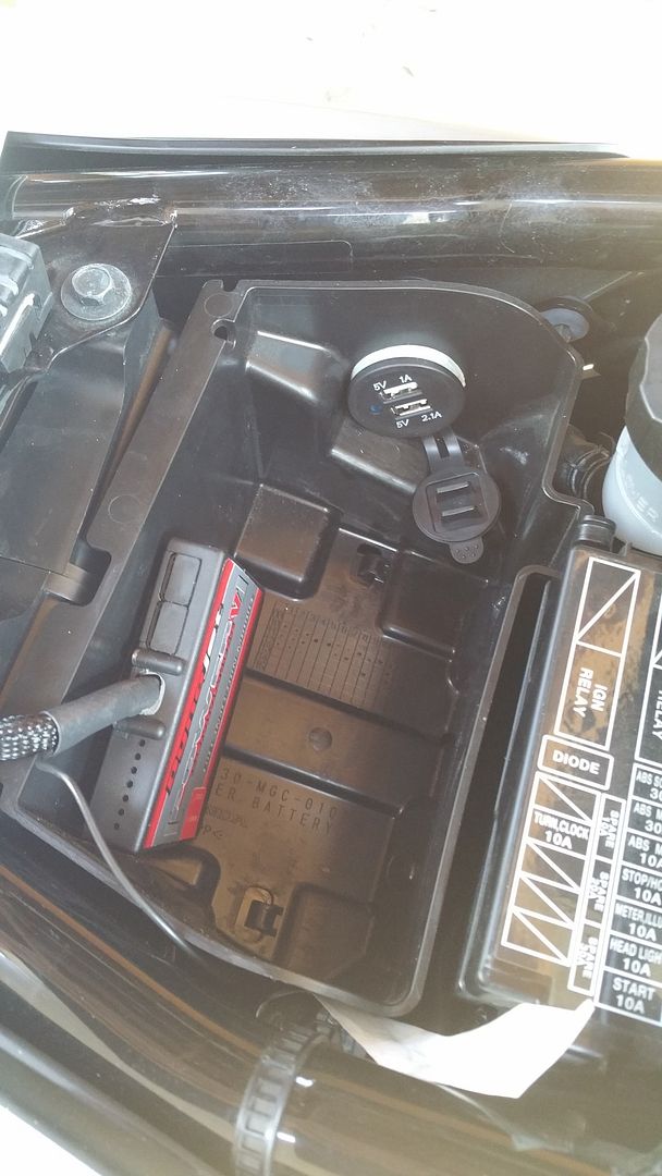

Put a USB dual head charger under the seat, wired to the red accessory plug. It's probably not as handy as on the bars, but I like that it's invisible when not in use. And stringing a usb cable from the seat to my tank bag isn't that hard.
[url=http://s276.photobucket.com/user/mkehl/media/20150812_171608_zpsemmgqzyn.jpg.html][Image: 8d1f1062bfe1c3809dd8d31adda0f3dc.jpg]
Great idea Kmoney. I like it.
