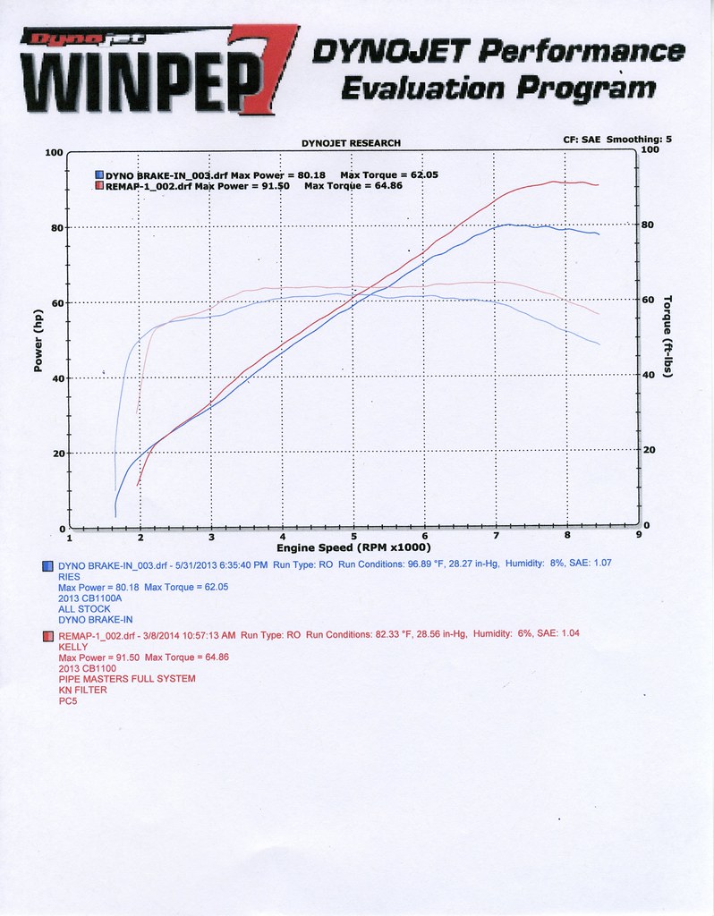

Dyno results with comparison between Pipemasters/mods and a stock CB1100 (not mine).
