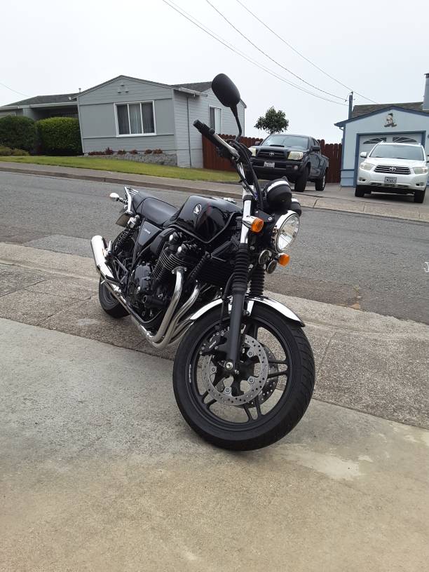

Photos below. [Image: 532d88be5a29d1fb2339cb8869542c39.jpg][Image: 57b729f72a281a3482cc61cda8a7731c.jpg][Image: 417a63c35ccef0769a2cd465fa606020.jpg][Image: 5746ba0ae36f0adba41c5a9548017ca7.jpg][Image: aae10953781175078ca932977b0a1df9.jpg]

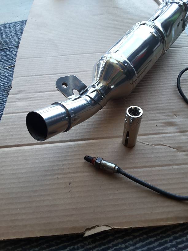

I had to make the tool for removing the oxygen sensor. I just used my angle grinder and cut a slot in a 17mm socket. [Image: ffedc8c9d49c1d53acc93ce60ca3e466.jpg]
Overall I am very happy with the service and results. The color is closer to a polished aluminum than chrome, I am good with that. There are minor flaws in the finish. Just have to realize it is a paint coating so any physical flaws in the original surface can be seen. I am okay with this as well.
wow those look really good. Daggone Honda should have double walled chromed them in the first place imo
