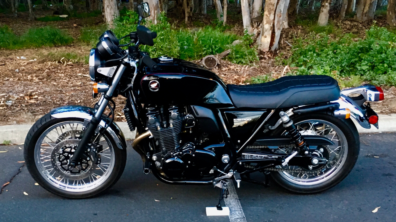

You need to finish off the seat install with the correct OEM brackets to reposition the grab rail. As it sits right now the seat is sitting on the grab rail,the OEM brackets will reposition the rail to clear the seat.
[url=https://postimg.cc/S24bqhtP]![[Image: 1e5bc0f88f2f4e67473d8316511973d0.png]](https://cb1100forum.net/forum/uploads/imp/202004/1e5bc0f88f2f4e67473d8316511973d0.png)
This is my 2014 Standard with the 2014 Deluxe seat,notice the gap between the bottom edge of the seat and the grab rail.

(04-03-2020, 08:42 AM)FLYTYM_imp Wrote: [ -> ]You need to finish off the seat install with the correct OEM brackets to reposition the grab rail. As it sits right now the seat is sitting on the grab rail,the OEM brackets will reposition the rail to clear the seat.
That is in the plan, still trying to figure out which parts can be re-used and what exactly needs to be ordered, as to part numbers.
Thanks

(04-03-2020, 12:23 PM)gman_imp Wrote: [ -> ](04-03-2020, 08:42 AM)FLYTYM_imp Wrote: [ -> ]You need to finish off the seat install with the correct OEM brackets to reposition the grab rail. As it sits right now the seat is sitting on the grab rail,the OEM brackets will reposition the rail to clear the seat.
Thanks
Thanks
Find a an OEM parts supplier that’s got a parts diagram,there are 2 brackets,one for each side,some bolts and spacers. I’ve done it so if you need a hand let me know.
I just took a look at my bike,you have a small collar at each mount for the grab bar,a bracket at the back of the bar and one button head bolt.
