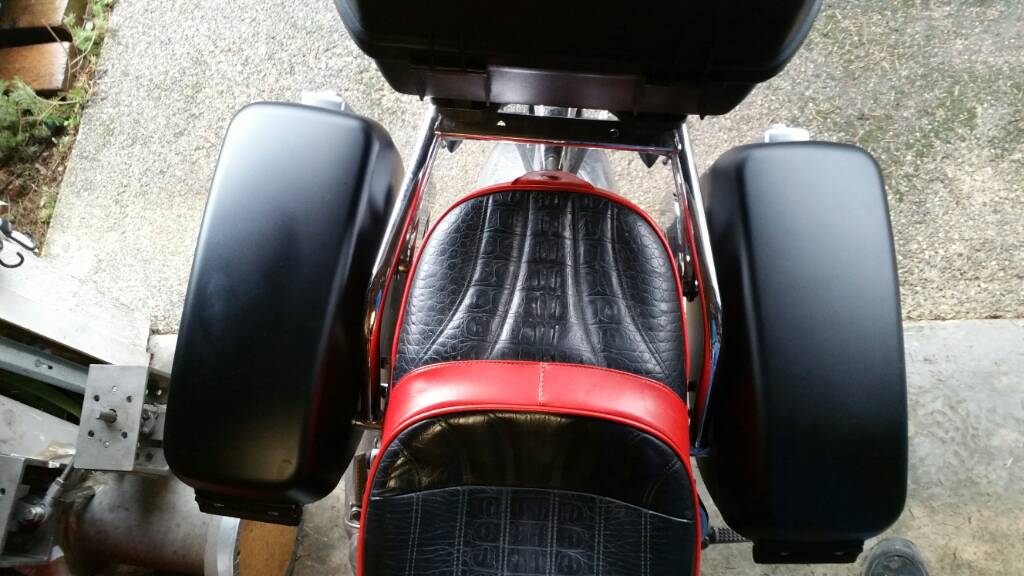

I was going to design and build my own brackets and use ammo cans but these came up for a good price and I couldn't pass them up. However, they are not designed to work with the Honda rack. But I am not easily deterred either.
After a little fiddling I was able to mount the brackets by replacing the rear spacers in the Honda rack hardware.

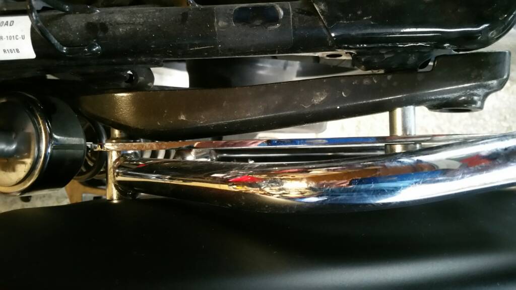

This is the spacer that made everything fit. 3/4" long.

Nice job Kenny! They look great!
If that spacer is all it takes, you would think the manufacturer could have figured that out and included them.
They are mounted a little tighter to the bike like this and could rub on the rack a little. Nothing bad, but enough that it could make a mark over time on the inside, non visible side.
The rack fitment is also not ideal but it goes together if all 4 bolts are installed loose before tightening anything. The rack then conforms to the spacers when tightened and has plenty of flex to accommodate the needed spacers. I don't expect any issues with it.

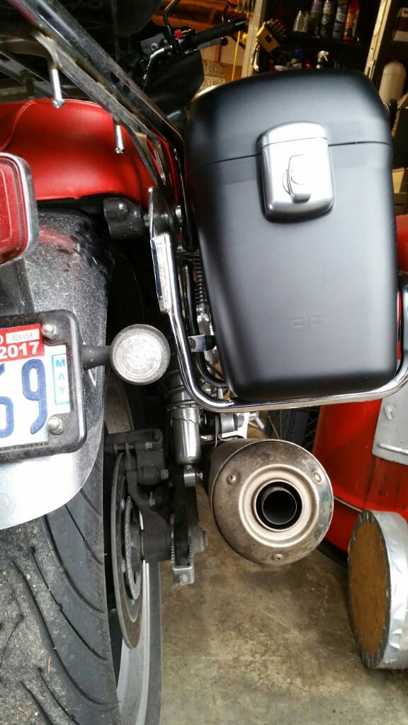

Any plans for the turn signals?
(03-15-2017, 10:15 PM)Lord Popgun_imp Wrote: [ -> ]Any plans for the turn signals?
I already had them relocated to the license plate.
