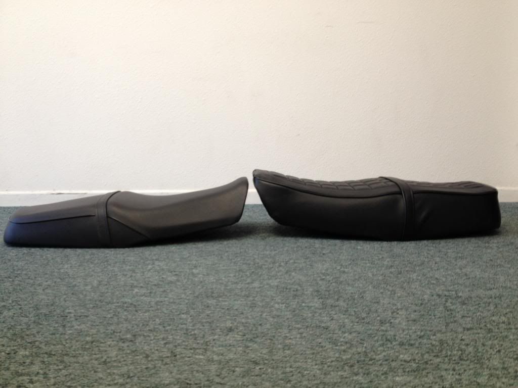

I am almost of the same dimensions as you.
My first impression when I sat on this bike was how low the saddle was. With both feet planted squarely on the ground my bum was at least 2 inches off the seat. This in itself was not a problem, but within 30 minutes of riding my knees were! The other problem was the aforementioned bum was numb after an hour.
I phoned some guys who advertise in the UK motorcycle press who are a couple of hours down the road and whilst I waited they took off the saddle cover and built up the dip at the fore end by about an inch with some special foam they use. 45 minutes later, original cover back on and £50 lighter I was on my way.
The results IMHO look good and have improved the ride ability (for me) by leaps and bounds. Definitely more bum comfort and it is now 2 hours before I have to stretch my legs.
Just another way to go.
Cheers
Dengie

A picture is always useful

edit:
![[Image: 4f01577bbc9f37e3d1d3c5df99ab8757.jpg]](https://cb1100forum.net/forum/uploads/imp/201406/4f01577bbc9f37e3d1d3c5df99ab8757.jpg)

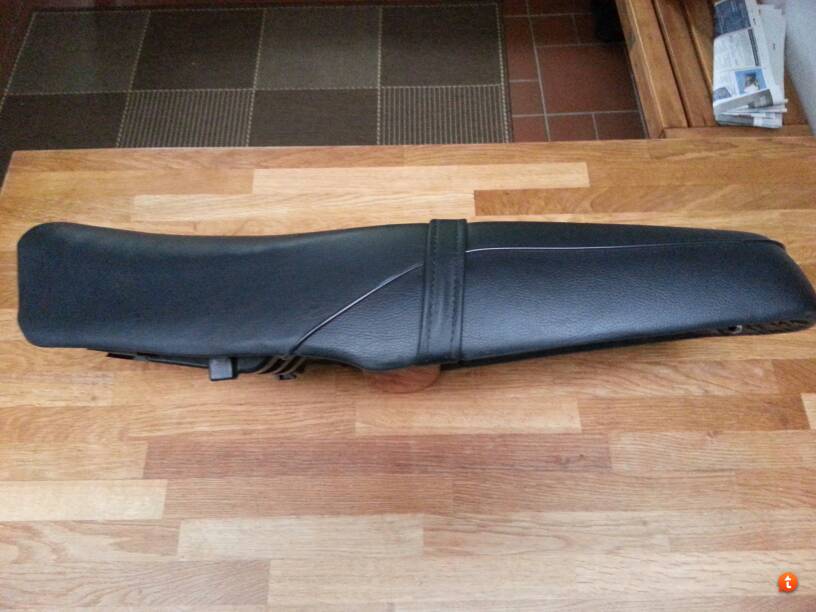

I'm about 6' and had similar issues.
The Tiro KO style seat was a game changer for me. Noticeably taller, and extremely comfortable. Totally changed my riding experience. A MUST-DO mod for any taller rider, in my opinion.
[url=http://s157.photobucket.com/user/mustangfeverrr/media/2014-5-13020_zpse0675fdc.jpg.html]
![[Image: a0871da1758e10b6e545d9f6c3052391.jpg]](https://cb1100forum.net/forum/uploads/imp/201406/a0871da1758e10b6e545d9f6c3052391.jpg)
On my 13', I got the K&H High seat and 1" risers from Genmar, and It made a big difference. I tried the lower Buell pegs but when I snagged my foot leaning into a corner, I went back to the stock Pegs. The 14' Deluxe seat is a big improvement over the stock seat on the 13', so I just got the Air Hawk seat pad for long rides. In my opinion, finding the right saddle style will make all the difference.
I forgot to mention that the quality on the K&H High seat is the best. Worth every penny. Like The ferret said, if you get the high seat, I would also get 1" risers to keep the same reach to the bars.
