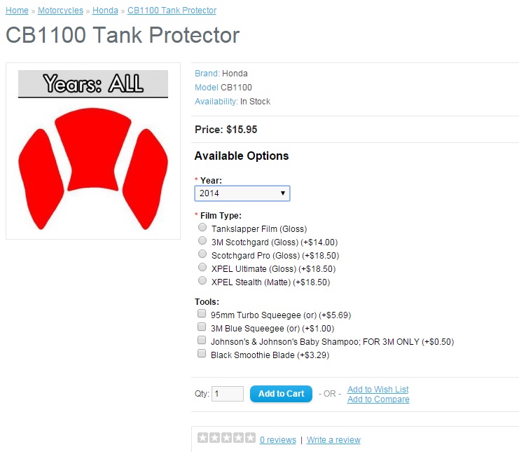

OK, it's not much money, so I'll order a kit. Metal, here are the options for the CB1100. Since you have some experience with this product, I just wanted to see if you had any recommendations as to what to buy. You recommend the straight up tankslapper product or an upgrade - I was leaning towards the 3M upgrade. Thoughts? Also, what about the "squeegie" model - any recommendations on that?
Love to get your thoughts on this. I'll order one up and when I give the install a shot.

I went with their standard/basic product. It held up nicely for a few years but then discolored a bit. It's so inexpensive, I just ordered another kit once that happened. The 3M version may be better but I was being cheap. And, seriously, the standard stuff does a great job.
I'm not sure what you mean by the "squeegee model" but you're supposed to use a mixture of isopropyl alcohol and water that you spray onto the film and surface of your tank then squeegee out the alcohol/water mixture and any air bubbles. I know they sell a squeegee for this but I simply used the felt side of those Velcro strips with adhesive and trimmed it to fit around the edge of a plastic hotel key card I found lying around. Works perfectly as a squeegee.
I'll take a look at the website again and see if you're referring to something else. I hope this helps!
Edit: Oh, I see now that they sell a squeegee for $5.69. You'll need some form of squeegee whether you buy theirs or just make one like I did.
