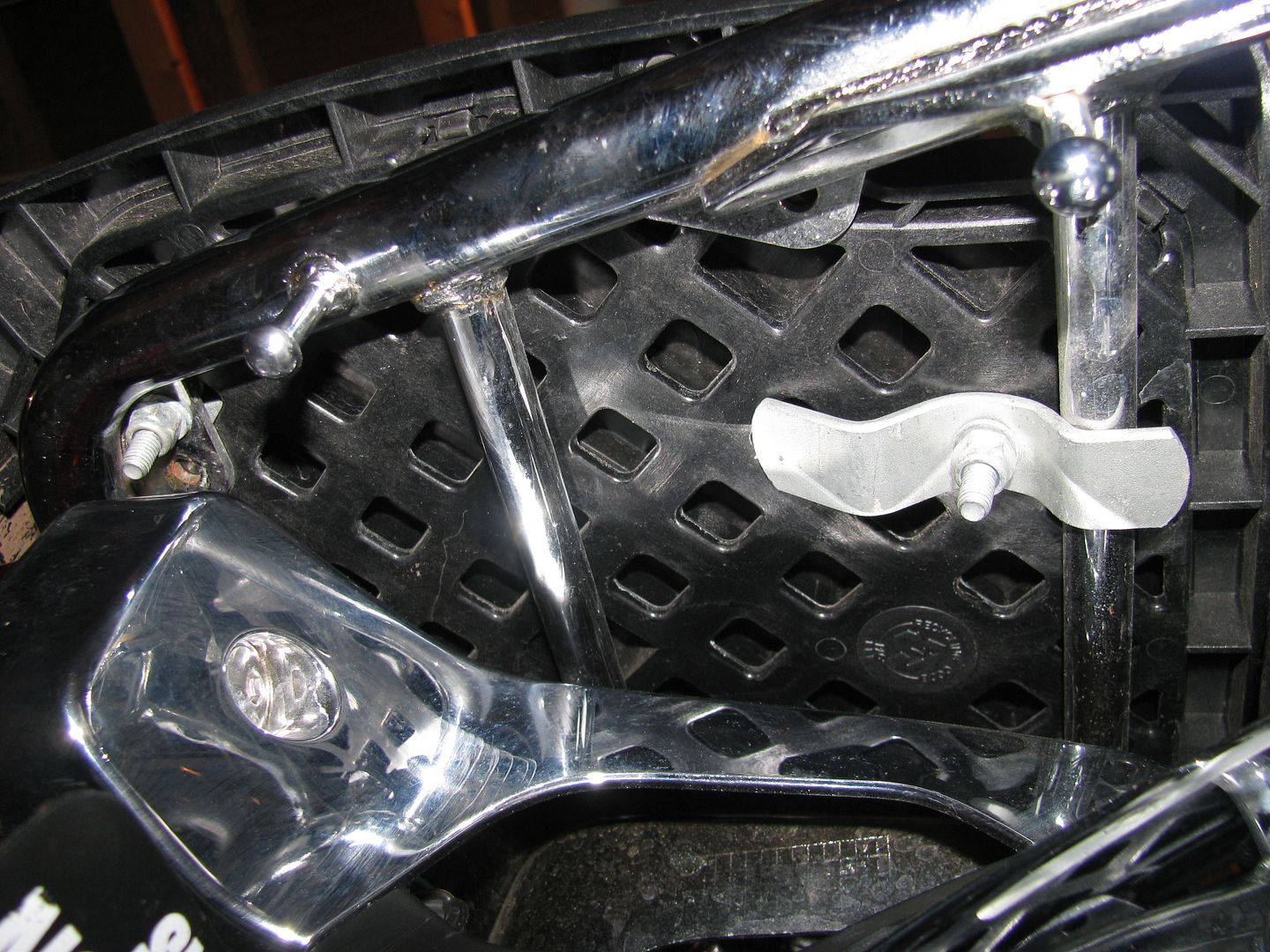

xmike I first have to say I am not a very good photographer. I suck. I do have a GIVI universal Monokey plate mounted to the Honda luggage rack. I did drill two more holes in the tabs on the Honda rack. The holes Honda had already there did not work for me. So I drilled two more and used two of the butterfly clips for a grand total of four very substantial mounting points. That sucker is mounted solid!
[Image: a819dd8a7ca679deddd70c8f8f6ac106.jpg]

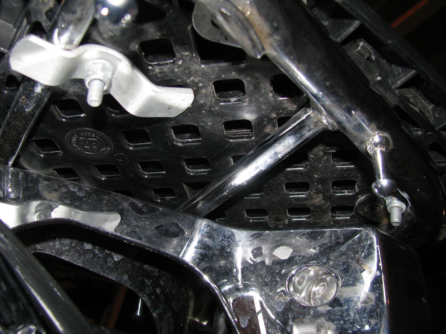

GIVI's hardware is well thought out and I think galvanized to prevent rust.
[Image: a3fb921fd3085fef383f13158a360ef5.jpg]
If you look real close you can see the holes Honda provided. I drilled right next to them. If I was to use the Honda holes, getting my seat off would have been difficult.

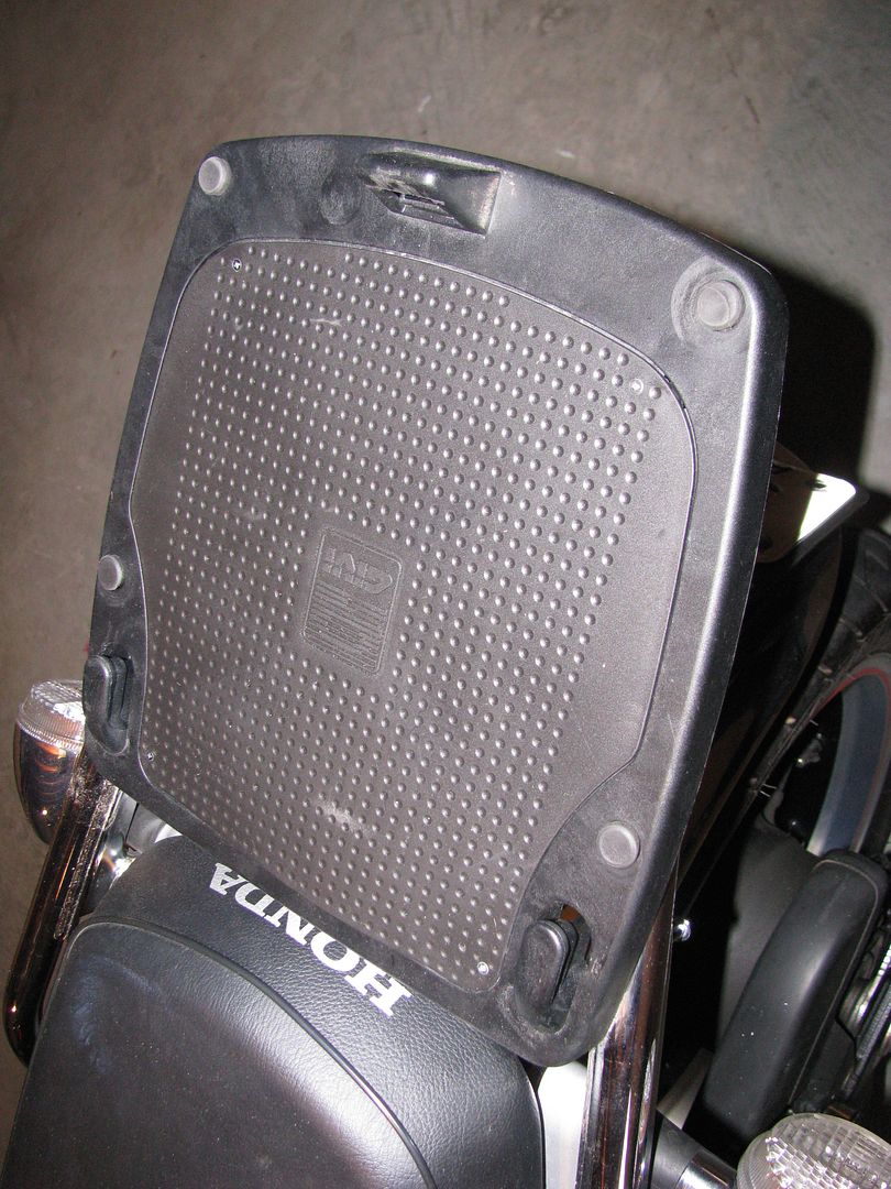

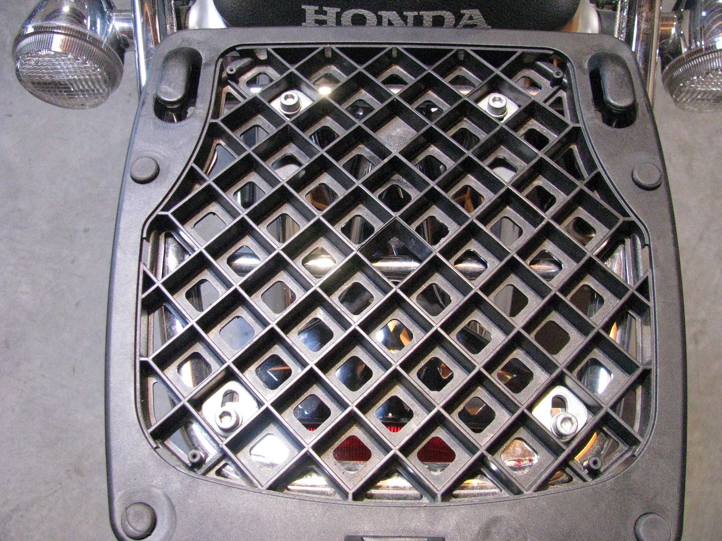

[Image: 8da6ef5eec7ddef3881252b7005fd3a1.jpg]
[Image: 73983d817ae6350d3a054d267fe83ae7.jpg]
It is my hope that these pics will help you in your decision. It was not very hard to mount this plate. It took me about 20 minutes and half of that was making sure I drilled my new holes in the correct spot. Measure twice cut once?

And I didn't drill any holes, just used the clamps. It mounts very easily. Its just not that big of a deal. A number of us have it.
That round circle you see in the bottom pic is a knock-out for the connector if you install a lighting kit.
