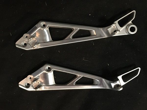

Curious if the 2014 standards have the muffler mounting hole on the left side? I had to purchase a new foot peg bracket when I converted my 2013 to duals. Picture below shows their differences.

No, the 2014 standard doesn't have the mounting point. That is why Moriwaki supplies the adapter I spoke about. Go to this website: http://www.moriwaki.co.jp/global/product...del=CB1100
Scroll down to the Twin Megaphone and click on the "Manual" button. That will bring up the illustrated parts break down page. If you look at the top of the top of the page, #22 is the adapter I speak of.

Thanks for the link, WhiskeyUSMC1979. Interesting option to buying the OEM foot peg bracket. I should have known Moriwaki would supply everything you need.
