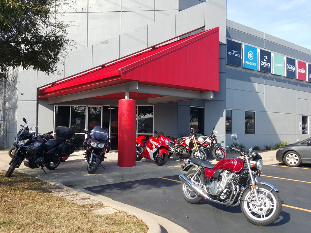

I went w/ Metzeller roadtec z8.
mainly b/c they're avail in stock 18" dia sizes, 110/80 & 140/70
& they're radial tires, 2 things I was looking for to match the OE dunlop d205.
I bought my tires locally, through AF-1 racing.
[Image: bccd3343c690e489610e024f3c7136fe.jpg]
They opened up the parts unlimited catalog, ordered right out of there, and w/ purchase, they mount and balance for free while you wait. Plus, at that time, metzeller was giving a $60 rebate on purchase. Excited
Bonus... when they finished, I saw right away that my bike got a free wash and quick detail. Then after I got home, I noticed that they adjusted my chain too.Clap
