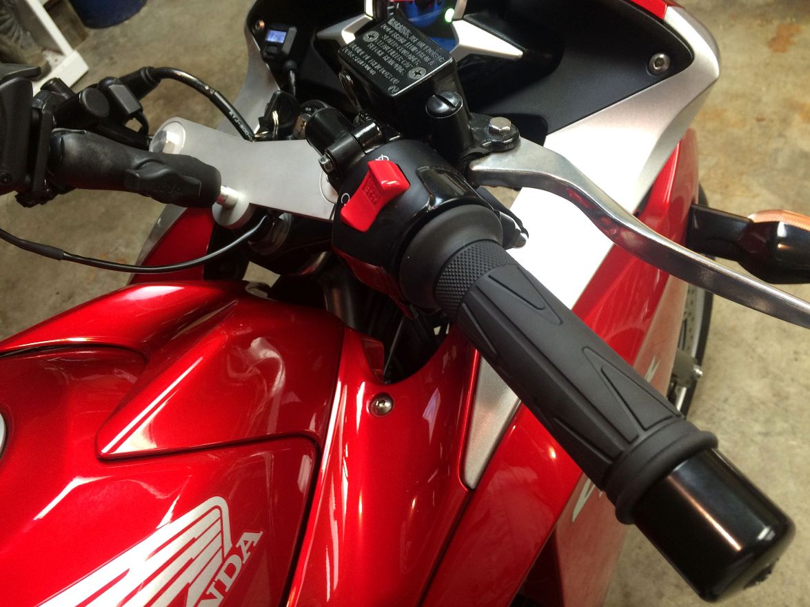

Is there really a dearth of good-looking open-ended grips out there? So many street bikes have bar-end weights; seems like there'd be a ready market.
I put the Bikemaster heated grips on my CBR250R. I think they look like OEM, only mo' betta.
[Image: f4dfde8a3e97f6ba071c200388bd83ba.jpg]
[Image: 79cf4e14835cf3be5110d6b8f73018f9.jpg]
