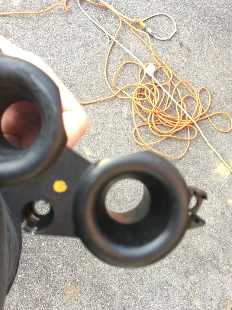

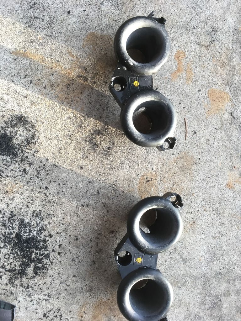

I was tooling around on Ebay looking at parts and came across a set of velocity stacks off a parted out bike.
What caught my eye is that I could see a lip midway down the throat. This is confirmed in the picture of the reverse side where you can see the notch cutaway gets thicker towards the middle.
So I bought them...and confirmed- yes, they do neck down in the center. ><
[url=http://s164.photobucket.com/user/powerdubs/media/IMG_0201_zps4qr4dudf.jpg.html][Image: 381bec2cd423a9b7af87860fcf3d1183.jpg]
[url=http://s164.photobucket.com/user/powerdubs/media/IMG_0203_zpsfzwyzmzs.jpg.html][Image: 4b31ea4652784d463760ddf4b8810254.jpg]

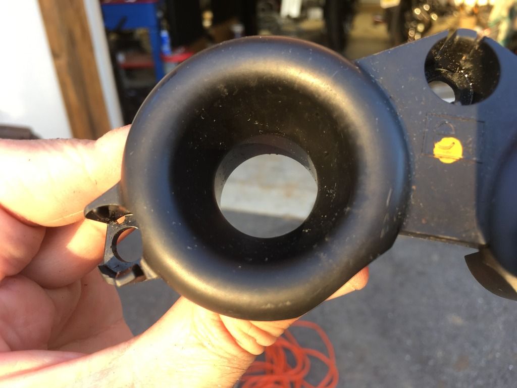

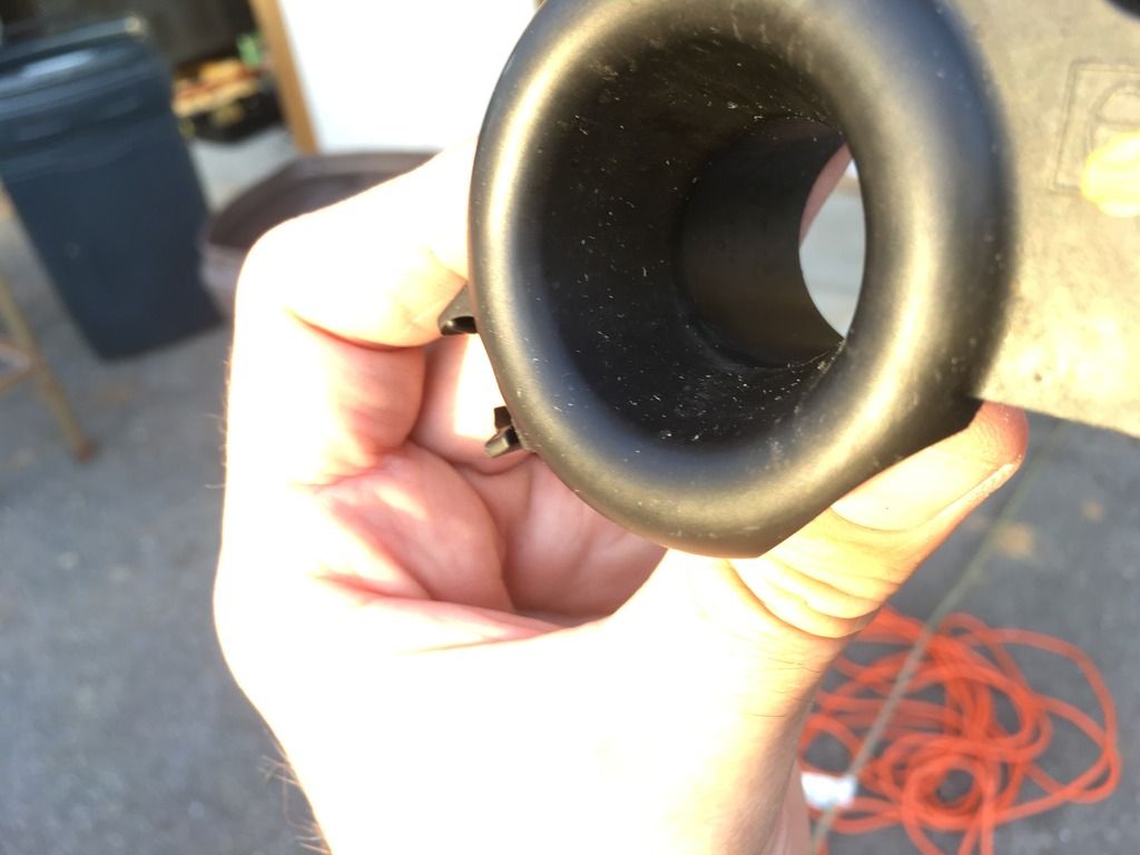

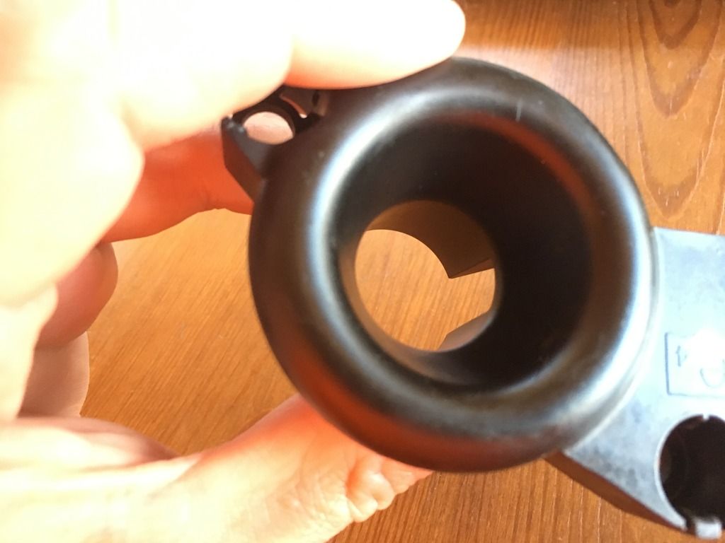

Soooo...I did a little work on them. Hard to see from the pictures, but it is much better now. Here is comparison to a stocker.
[url=http://s164.photobucket.com/user/powerdubs/media/IMG_0233_zpsgesdnxxe.jpg.html][Image: 203805a978ef6409f189ae6d51951983.jpg]
[url=http://s164.photobucket.com/user/powerdubs/media/IMG_0236_zpsacot92co.jpg.html][Image: fb91469e1c56f50eb06ef63ab680d267.jpg]
[url=http://s164.photobucket.com/user/powerdubs/media/IMG_0237_zpsxzny9ap9.jpg.html][Image: 1a407dbf06935d505fc57aa144d092d2.jpg]

I generally am in favor of allowing more air in, but I wonder if this particular "restriction" is for increasing the velocity of incoming air rather than the volume? Interesting though, please let us know what you think. Good old "butt dyno".
There is review on Motorcycle.com of the 2016 Triumph Street Twin where the reviewer says the bike runs a single 39 millimeter throttle body for "increased velocity at lower rpm". Possibly contributing to torque output? Let us know how it feels!
Ben
02-26-2017, 11:41 AM
jimgl353_imp Offline
Posts: 98
Threads: 4
Joined: Dec 2016
RE: Improved the velocity stacks
that restriction would increase velocity, but having a sharp edge on it like it does would most likely cause turbulence. so some give and take going on here possibly.
02-26-2017, 11:53 PM
Ben70_imp Offline
Posts: 519
Threads: 23
Joined: Aug 2016
You are correct, sir. The I.D. at the inner end would stay the same, and turbulence should be reduced. I imagine mpg improvement might be a way to gauge the success of this mod. Good luck with it PD. Also how much of a PITA to get those off?
