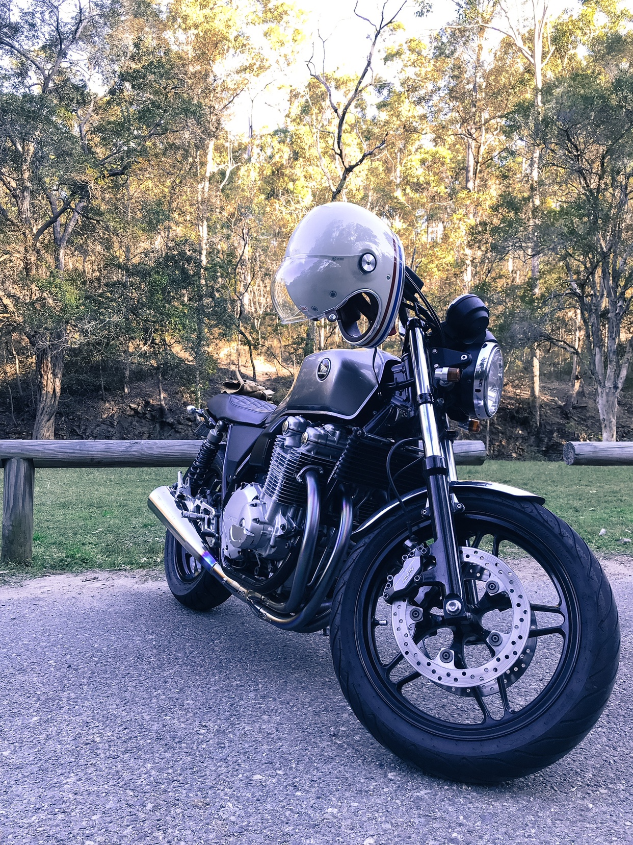

I have a 2010 CB1100 with a PCV, full titanium yoshi exhaust and K&N filter.
The bike seems to be running rich, and is burning too much fuel. I’m getting 150kms to a tank of 98 octane in Australia.
I want to remap the PCV, but can’t find a list of suitable maps.
Could someone please point me in the right direction??
Thanks!!
[Image: 6df0814bc3e7bb2d50a336ee208193bf.jpg]
