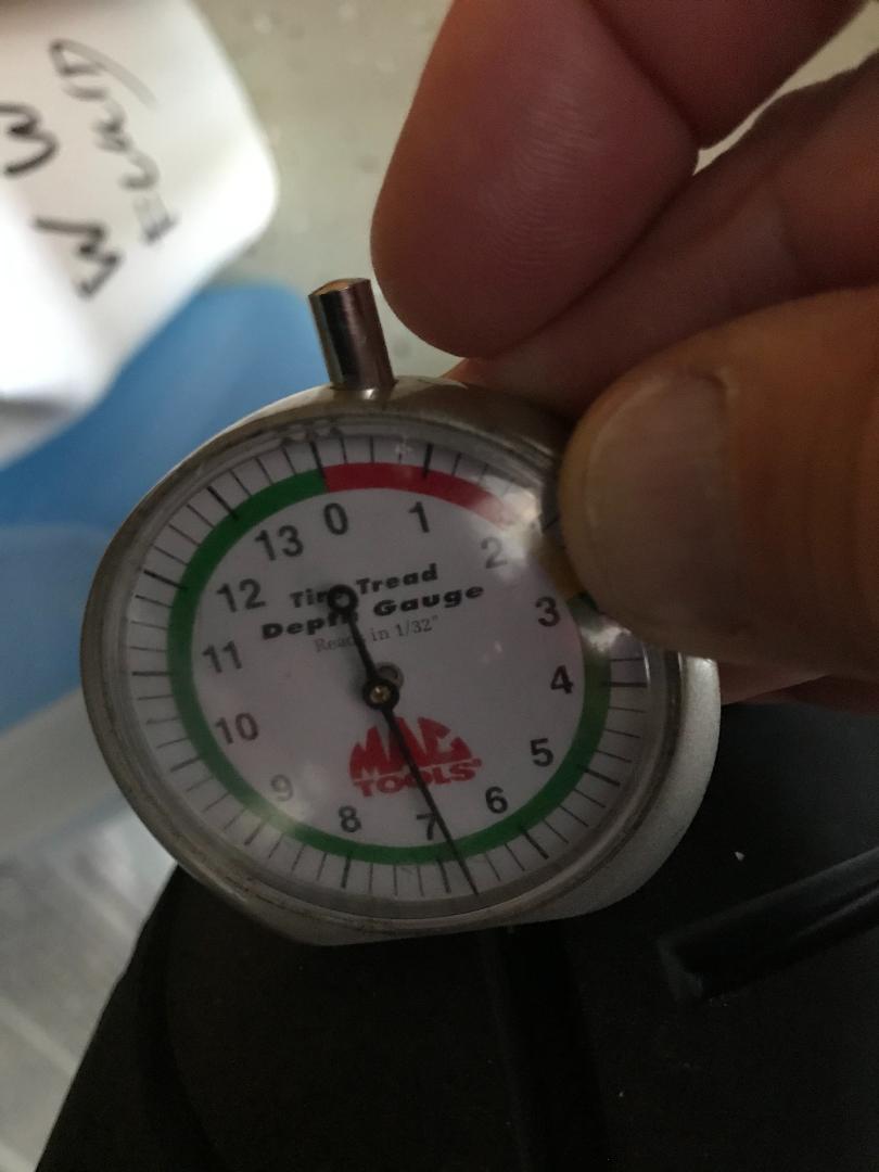

Brand spanking new OEM size Metz Z8::
[Image: c45c5549795b45c28d87c4cf98899bc4.jpg]
Front - 5/32

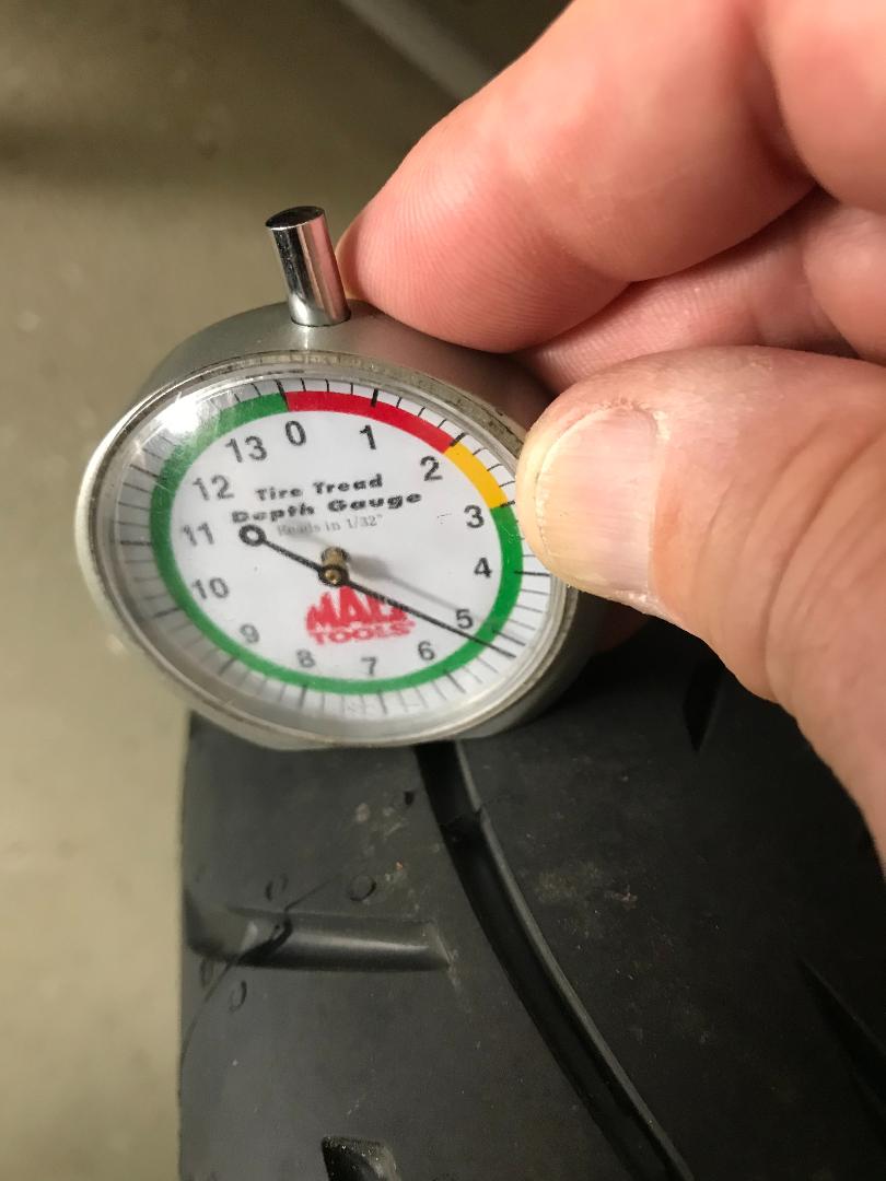

[Image: e514f91ea9309d5879be241aaabff8cb.jpg]
Rear - 7/32
