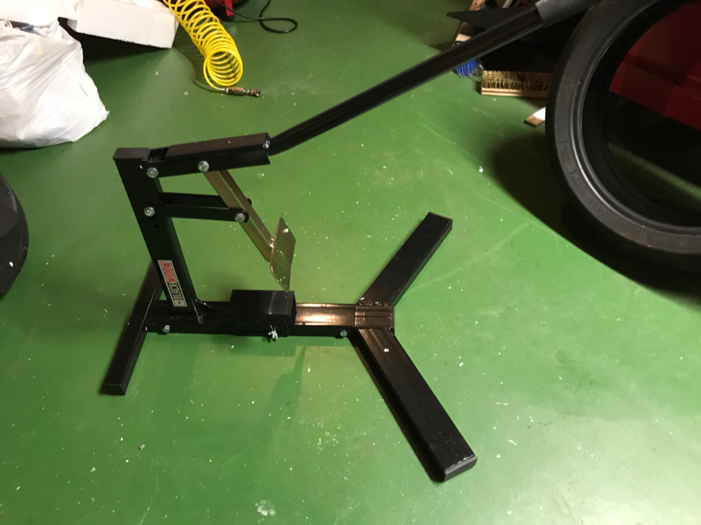

Also got a new bead breaker. Best $80 I have spent in a while. The Michelin Power RS tires wouldn’t come off without it.
