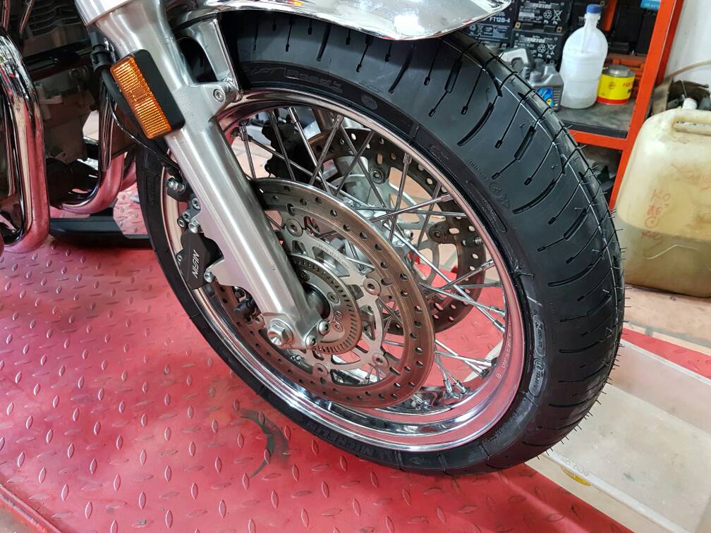

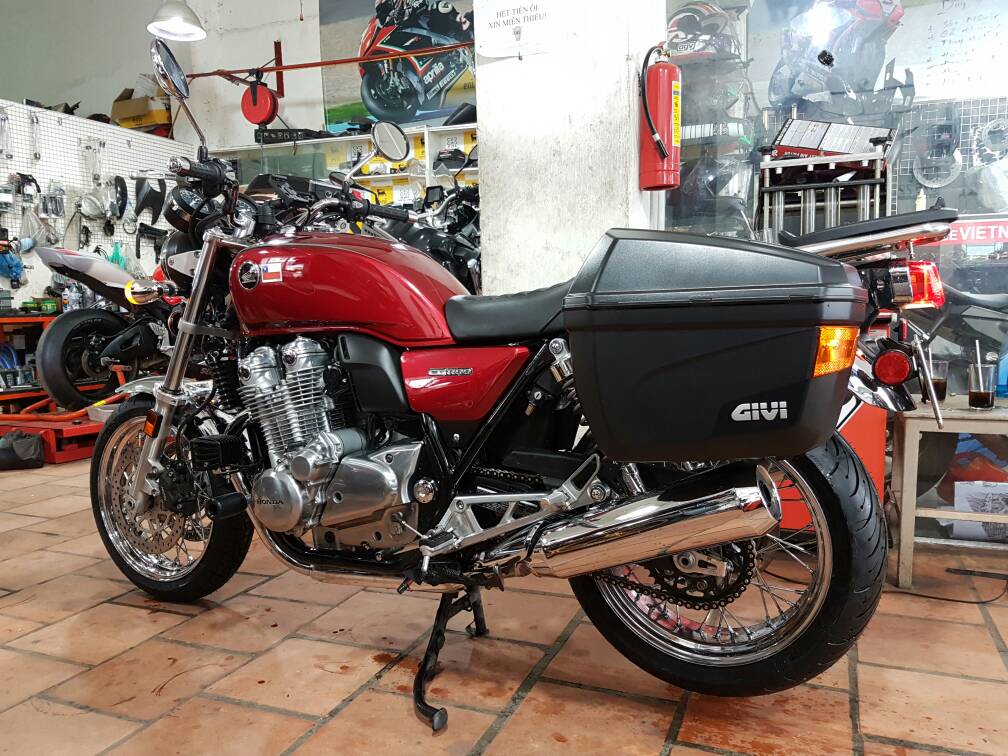

Hello Howdy Quang and welcome to the forum. I assume you mean Ducati GT 1000 spokes since the Yamaha GT1000 had mags. I imagine either would be hard to find used. Was the installation difficult? Require machining of axles or spacers etc?

Yeah exactly! That's the Ducati GT1000. It wasn't easy to find. And lots of works to fit them on... It took me 2 months

do they not have EX's in Vietnam or did you just want different (wider) wheels and sport rubber?

There are plenty of ex and dlx but you are right. I want a wider wheel with 17" diameter. The 18" stock rubber is quite hard to find and not much choices of style. The sport rubber you see in the picture are just for testing for fitting on the bike. When the mechanical work is finished I will use Michelin Pilot 4

you did not have to change a lot?
I see the part that carriers the rear brake is different.
But even the swingarm looks stock?

Are those tubeless?

Thanks mates! It actually was a hard work. Looks better for the bike and the stock swingarm fits well. My mechanic had to redesign the spacers and caliper holders. The hardest part was fitting the ABS disc on because it needs total accuracy. Anyway, I'm satisfied with the modification made. Will post the pics soon

(07-31-2016, 09:38 AM)Frulk_imp Wrote: Are those tubeless?
No it's not. But I'll use the tubeless kit for them soon!
