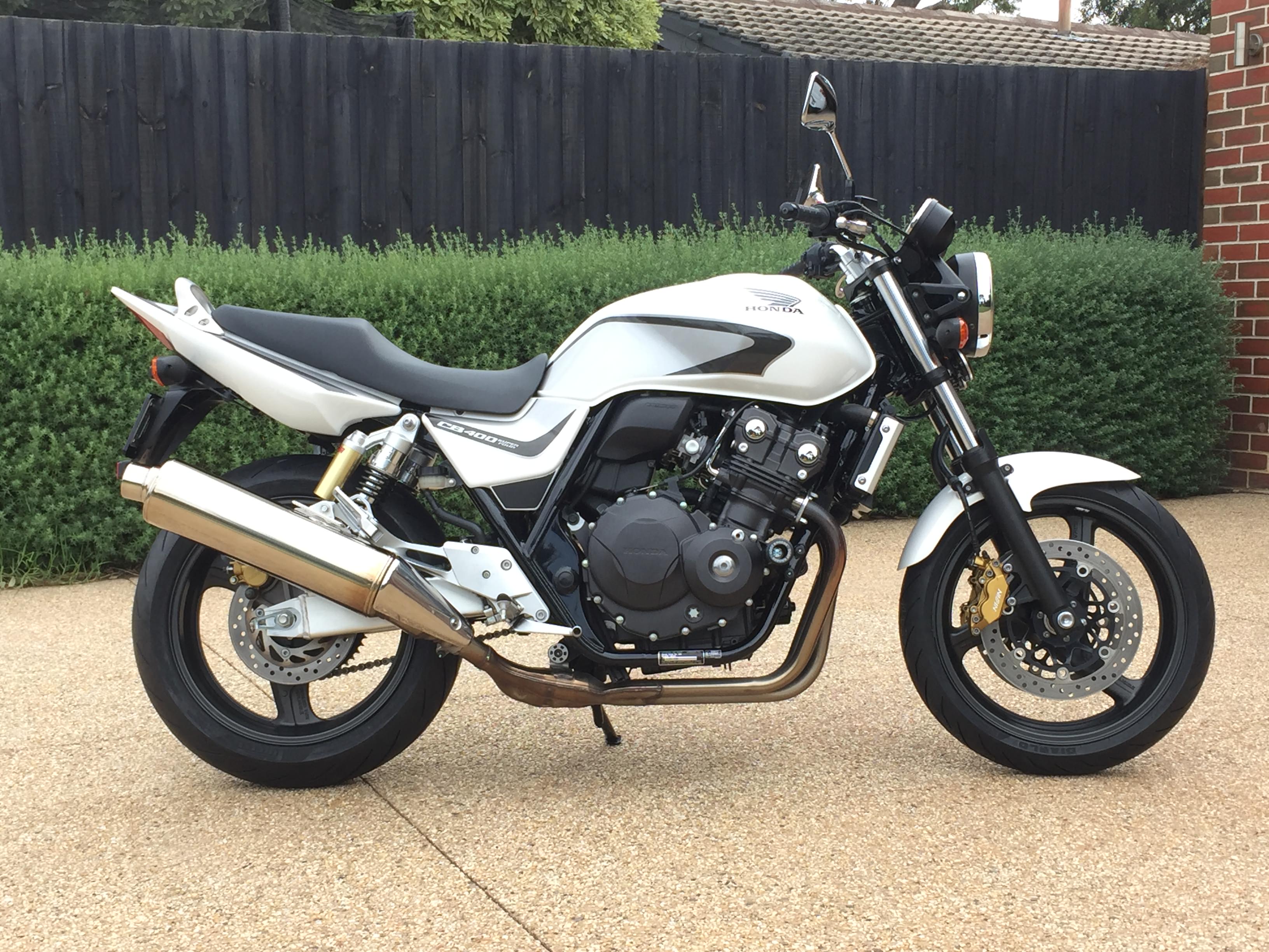

Last year I added to the fleet a 'one owner' 2008 Honda CB400 with 11,000 Km that had been unused for the past couple of years. Although it had been garaged its entire life it needed a spruce up and a bit of work in the tank to remove some surface rust. This is how it looked when ready to ride.
[Image: 8633ccf9d97e1e65b04d17259cef498f.jpg]

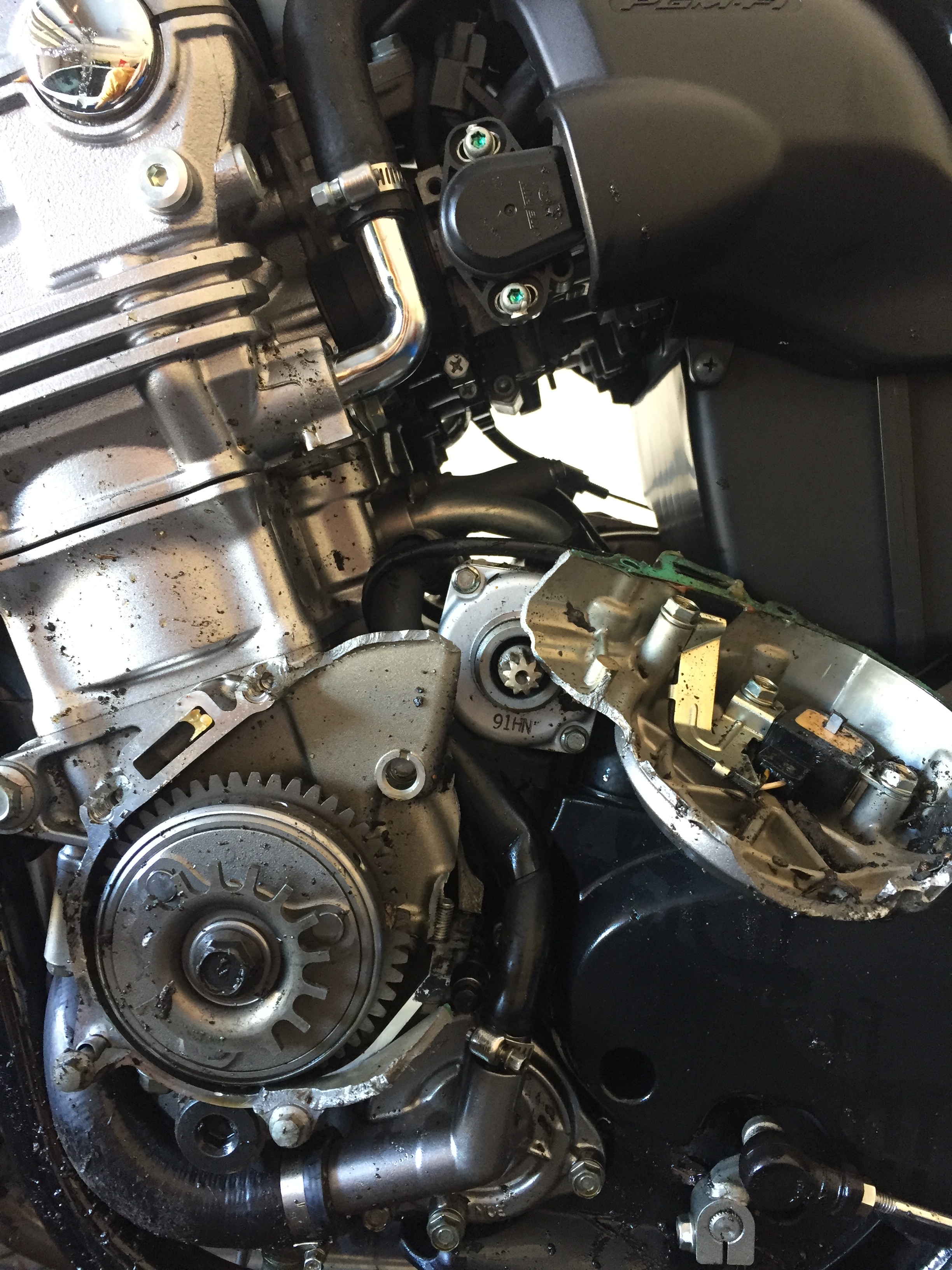

My eldest son developed an itch to ride a motorcycle and promptly worked through the rider licensing system to get his Learner's permit - wish he'd show that much enthusiasm to help me around the house! Initially we scooted around the local streets together and gradually extended the riding distances until he was more comfortable on the machine and ready to head out into the hills. We ventured up to Lake Mountain, I posted a Seat Time thread of a ride I took up there last summer. Well the young fella came unstuck on a tight left hander resulting in low-side crash. Normally not too much of problem, just pick it up and keep going, but this time the bike found the only segment of concrete kerbing within 12 Kms. Unluckily that kerbing ripped the LHS stator cover off taking a chunk of the crankcase with it. Now the once pretty little CB400 looked like this Sad:
[Image: 987e6f93dfb3de5d9e3ab6ff406a4b2f.jpg]
[Image: c3fe5a9376172133a052368bfb5e5bfb.jpg]
The list of damaged components includes:
Bars, headlight, mirrors, instrument cover, fuel tank, engine, front fender, tail piece, foot pegs and frames, gear and clutch levers, muffler, ...

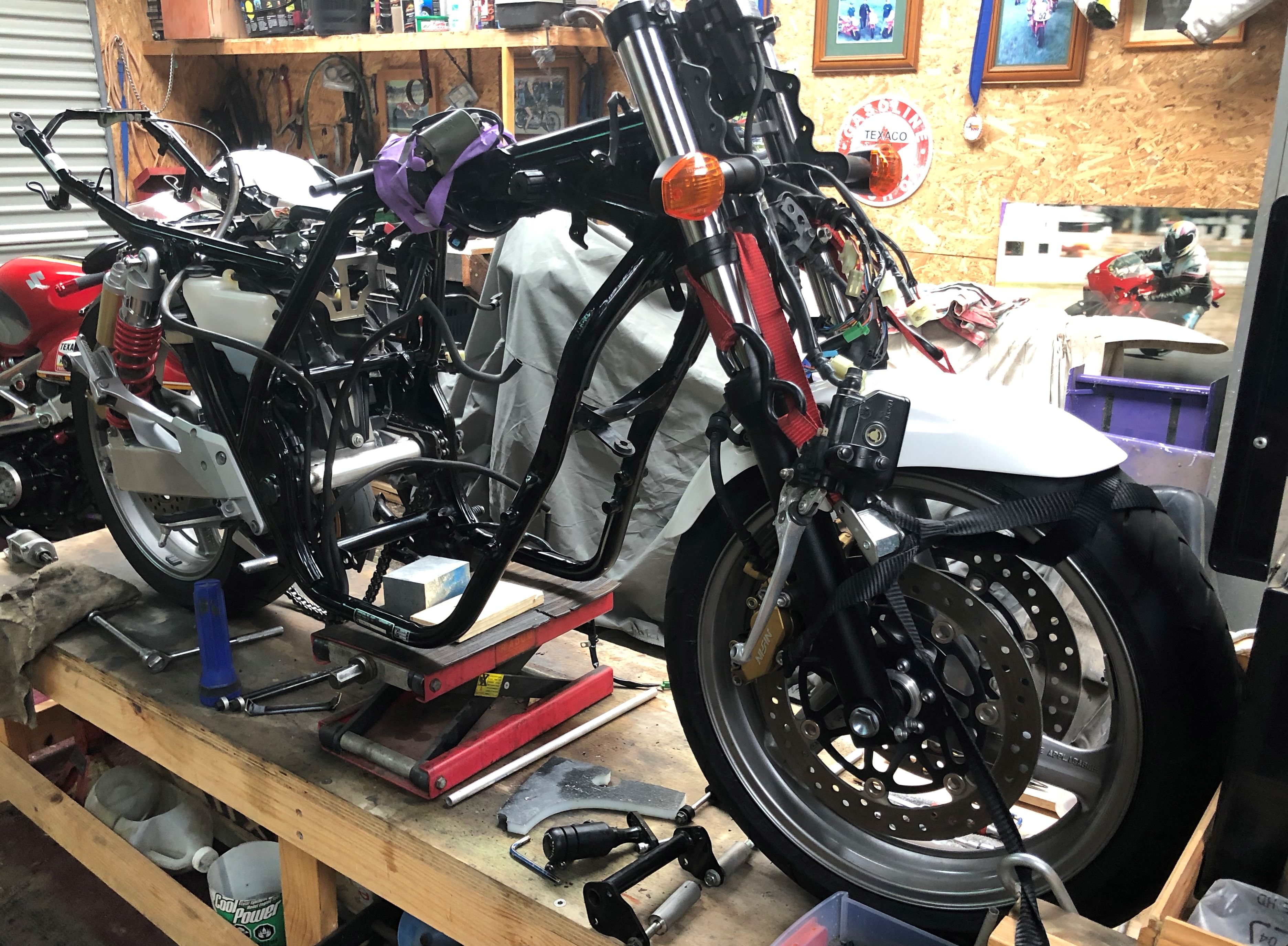

Then up she went onto the bench for removal of the unnecessary bits and broken stuff including the engine.
[Image: a4abb5804cf15e80676527782e19dae2.jpg]

Honda engineers did a lot of work to make this bike as compact as possible. Trying to shoehorn the correct engine into the frame was difficult and resulted in few scratches on the frame and on my knuckles. After a healthy amount of perspiring and the necessary cussing we had the engine, air-box and a few other bits in place.
[Image: 9a8099eca446db308473ef007be466fc.jpg]

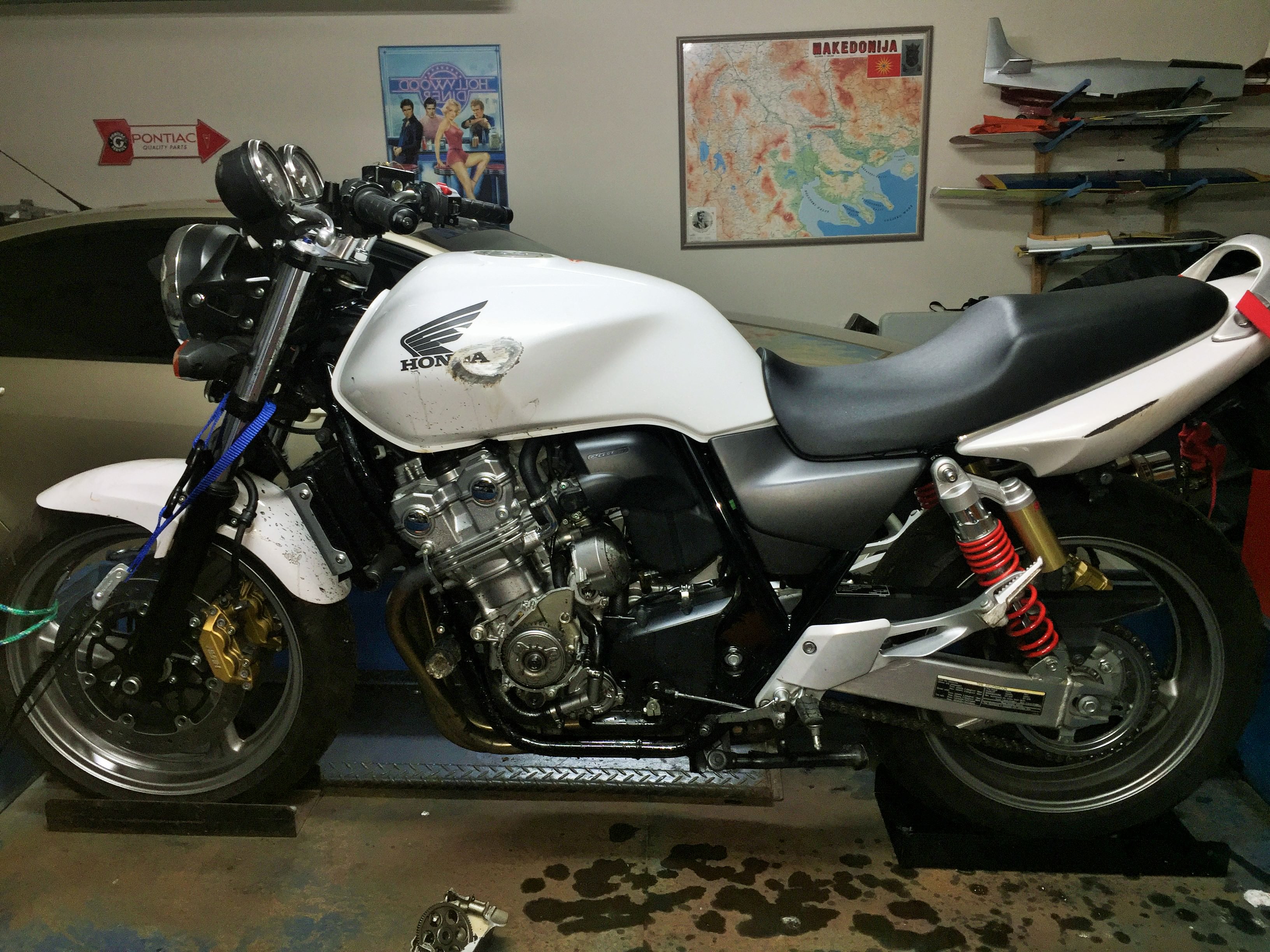

Now is the time to refit only what's needed for the track application so that meant no lights, a set of clipons for a more aggressive body position, a front number plate to hide the wiring that is normally in the headlight bucket. The instrument casing was glued back together, gear and clutch levers straightened, and Mick made a slight modification to the muffler by way of chopping it half! I took it for a sly blast around the back streets to make sure it worked but found that the engine wouldn't pull. After much head scratching and navel gazing through the bottom of an empty glass we swapped the TPS and and the manifold pressure sensor connectors. These are the only two identical connectors on the entire bike that could be incorrectly fitted ... which is exactly what we did Dodgy
Well, that chopped muffler is way too loud and crackles terribly but now with the correct sensors plugged into the loom the motor is pulling nicely Celebrate
[Image: d458b8f9cd78f6878c6d47d69a3d1281.jpg]
Next steps will include: installing fork emulators and springs from my CB1100 which should be about right for this bike, fitting sticky Dunlop Alpha14 tyres, a set of cheap rear-sets, a fork brace and steering damper although it probably doesn't need it 'cos the CB400 isn't strong enough to power wheelie even over bumps in the track, but they do look good! I'm going to keep an eye out for a reasonably priced set of adjustable rear shocks which are an essential.

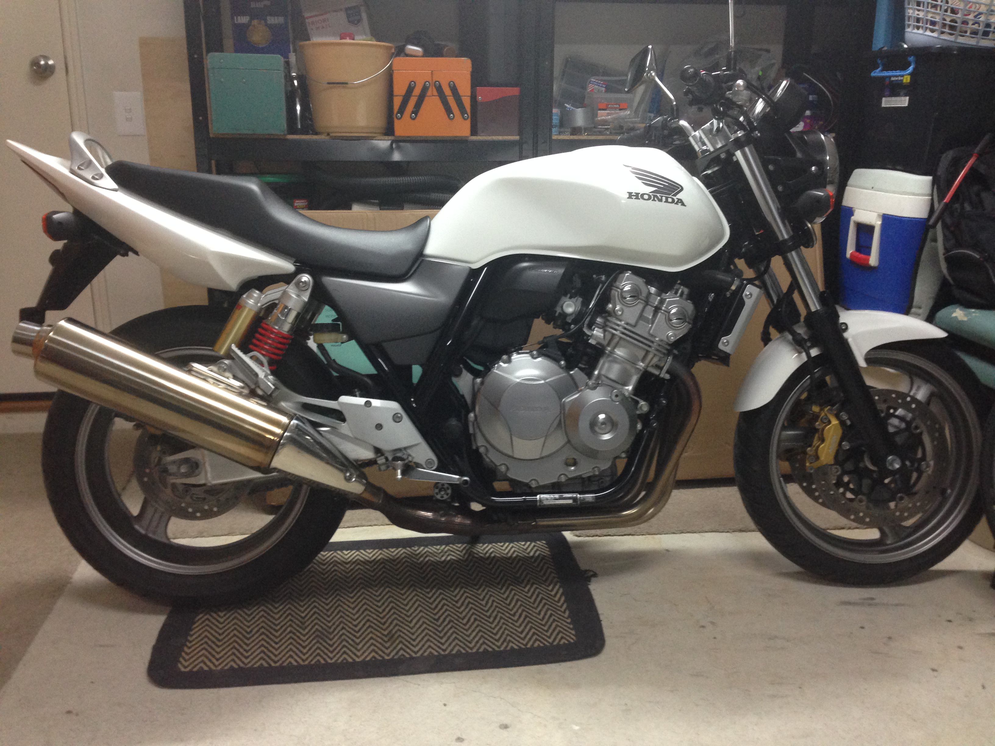

I'm very slow with some projects, you know how it is, other stuff gets in the way. Finally have the little 400 rolling on it's own wheels again ... here's a few pics.
The 99% finished product needs just a few tweaks here and there to finish it - new or rebuilt rear shocks, front brake pads, perhaps braided front brake lines. The bike now includes a second hand engine, reworked fuel tank with longer cuffs for taller riders' knees (son and I), reworked Ducati tail (had to cut the rear sub-frame), upgraded front suspension, cheap muffler, clip-ons, sticky Dunlop track/road tyres, removal of all lights, and a simple paint job.
[Image: 774936cd954e90d1a55e8ff58db83979.jpg]
