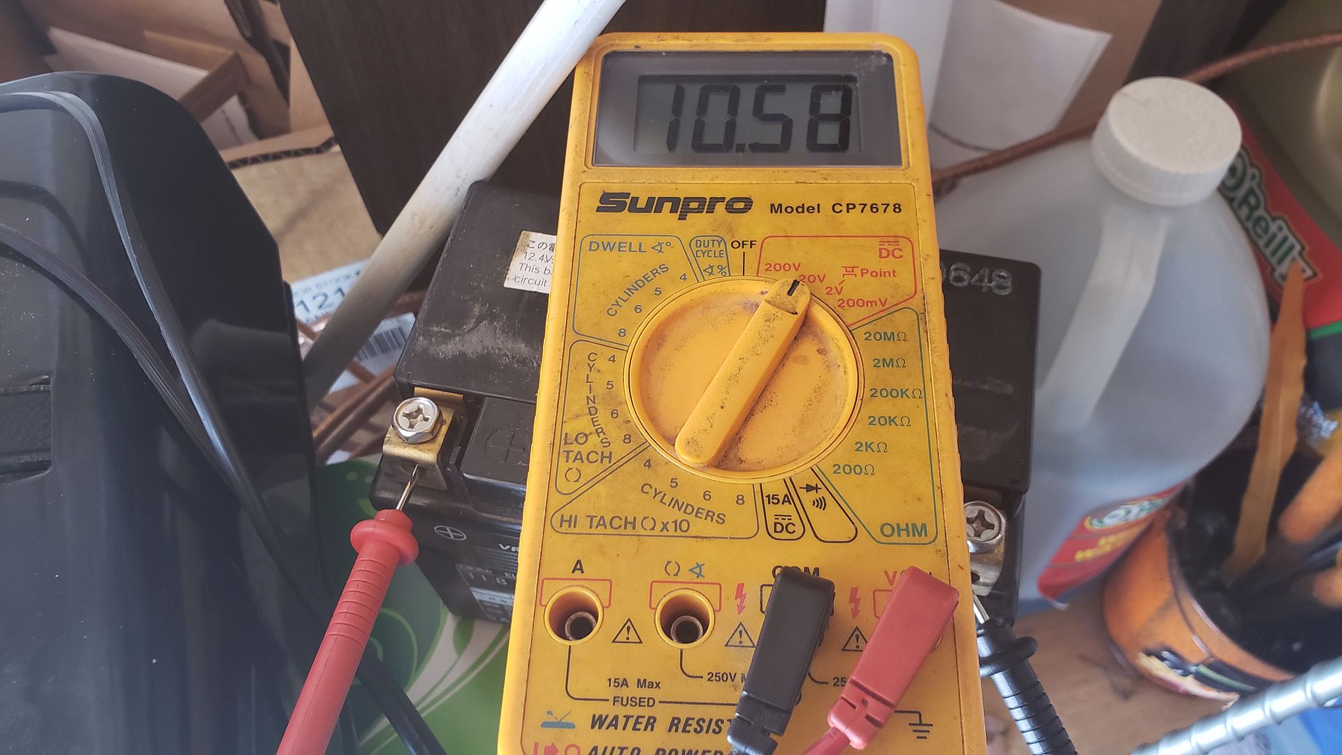

Bought new April 23rd 2013... never needed anything but a start midwinter to prove things were ok.
[Image: 4a4e169600718b3c2f1f2c4cd94dbeb4.jpg]
Voltage of new battery right out of the box.
[Image: a9ee3024ce58ea3a631698be61d0bd7d.jpg]
Voltage of the old battery after being on a 10A charge for 6 hours and then left to sit overnight.

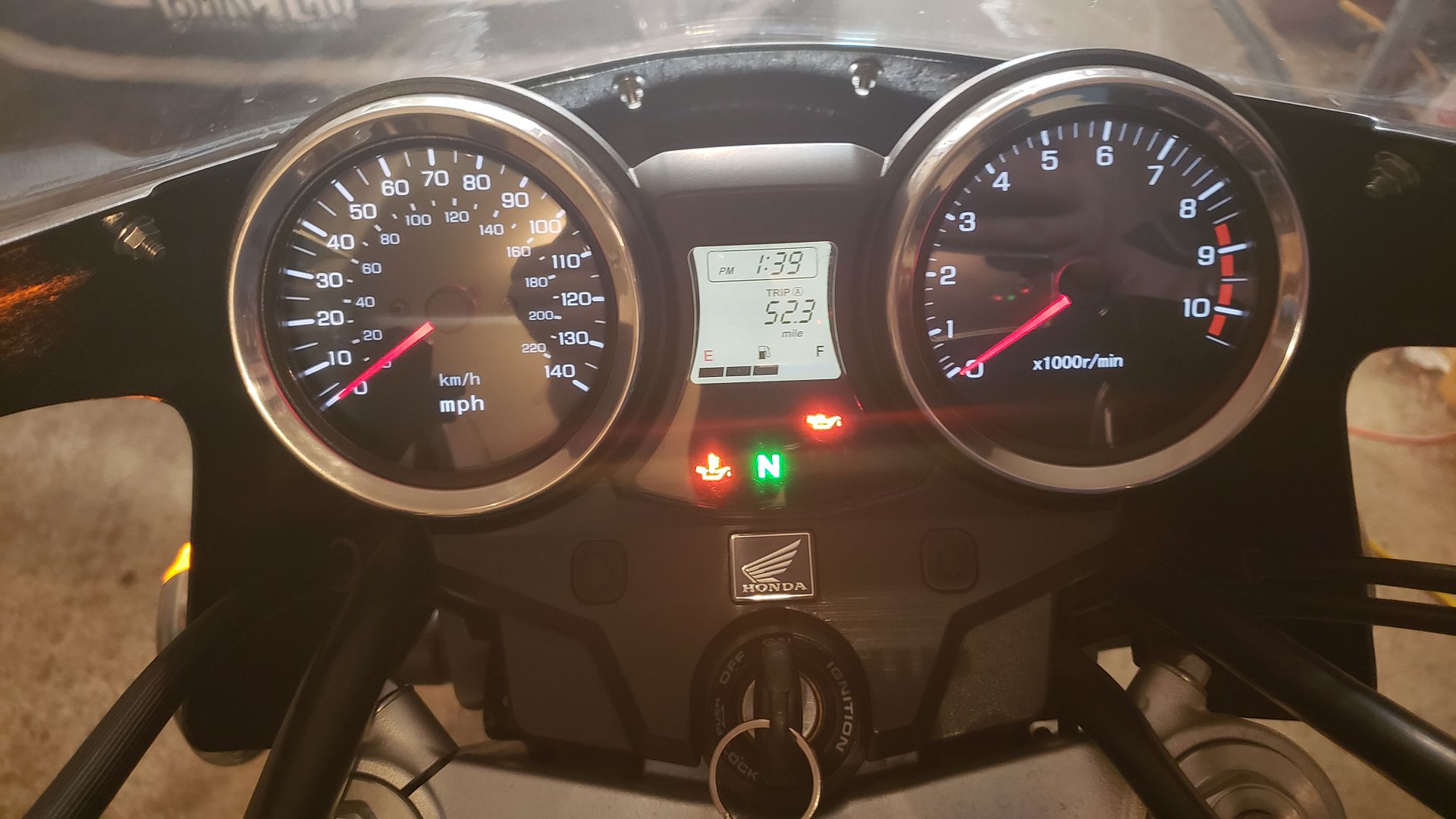

[Image: b9119ff7731f7373917de913a119de8f.jpg]
All done. Big GrinBig Grin

Congrats Randy. I assume you mean a 1 amp charger and not a 10 amp charger. Motorcycle batteries are low amperage units. That would be a lot of voltage going into that battery if you used a 10 amp charger.
(06-19-2019, 10:39 AM)The ferret_imp Wrote: Congrats Randy. I assume you mean a 1 amp charger and not a 10 amp charger. Motorcycle batteries are low amperage units. That would be a lot of voltage going into that battery if you used a 10 amp charger.
Voltage is constant, a lot of Amps you meant...for sure not 10A for this battery Tongue
Beer
yes amps, typo. Thanks for catching that PB
The battery will draw the current it needs to charge the cells to their full voltage potential and then drop to a trickle.
Using the 10A charger means a partially discharged battery will draw too much current and "bake" itself. Using a 1A charger will limit the "bake" to a maximum of 1A. Best to use the so called "smart chargers" that regulate and cycle the charging for you so the cells to not prematurely fail.
