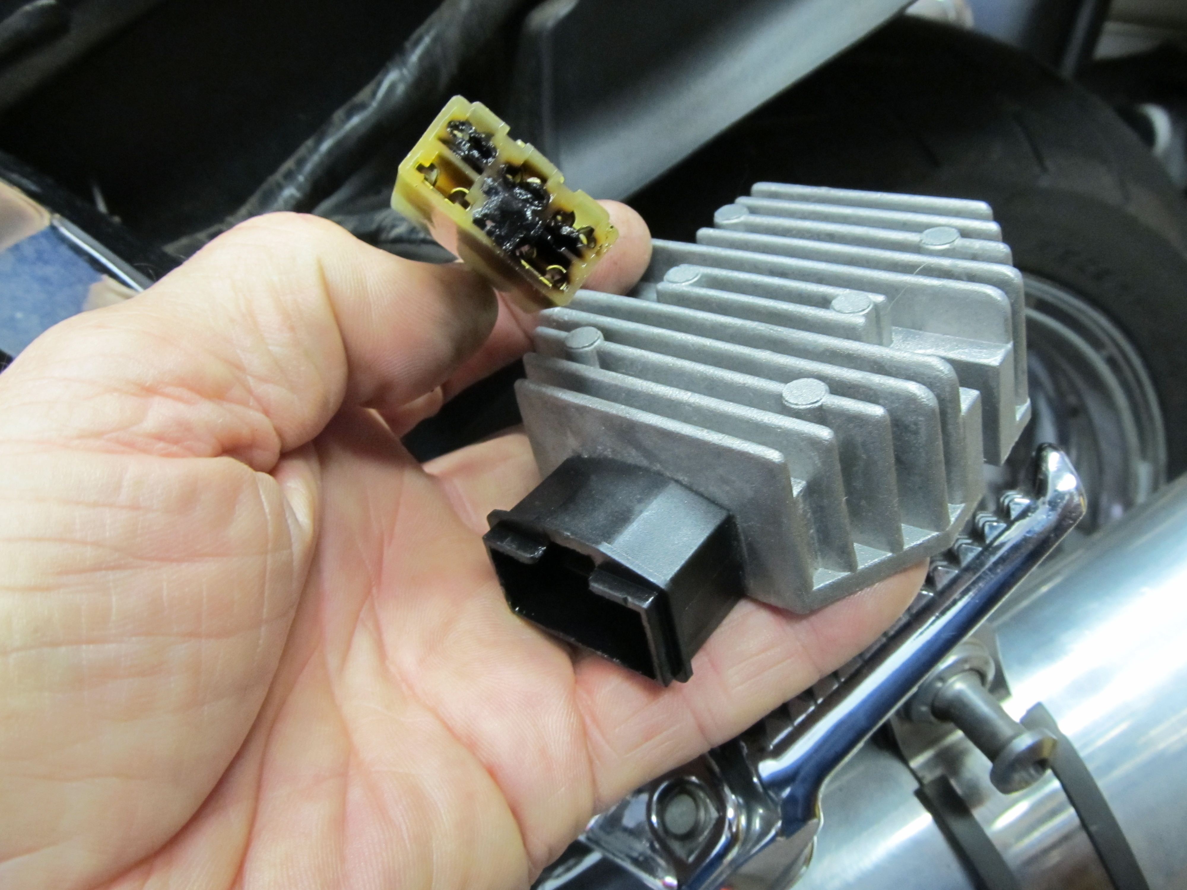

when faced with a battery emergency, where the battery cranks very slowly, stop !! .. pull the headlight fuse located under the seat.. that is a big drain on the battery.. then bump start the bike, keeping revs up once it starts.. ride the bike home or to a shop without the headlight drain..riding very defensively .. if at night, this plan wouldn't work .. I am speaking from experience.. twice I had charging failures.. once with my CBR 1100 blackbird, once with a Honda VFR.. connectors got corroded, then acted like a toaster.. there was just enough charge going into the battery, to keep up with the demands of the engine.. this is just a little positive thinking.. it might not work for you, but when stuck some where, a bit of positive thinking is just what the doctor ordered.. this pic of my yellow blackbird was interesting.. after I took this pic, my bike wouldn't start.. the battery was almost completely dead.. I bump started it after pulling the headlight fuse and rode 90 miles back to my house.. later, I found the culprit, the bad connector..

Chuckk, thanks for the vivid explanation of the near dead battery, this is indeed good thinking and well done on that subject with the headlight fuse removal.
In your case it appears from the picture that the battery gradually lost supply from the generator, discharged itself in the process. and drained itself during the trip all unbeknownst to you until startup time.
Can you clear up a curious mind by revealing if the battery was still servicable after the charging system was repaired?
( it seems from the picture that the connector to the regulator had cooked the three phase connectors in an equal way but not the dc connectors, did the regulator still work ok after that? ), someone i know had smoke pouring out of his alternator connector so it's something to be aware off in some designs and worth checking when servicing by disconnecting while checking for corrosion and good contact, once they start heating up it gets worse over time and good to catch it early in the process.
It's funny how a $0.15 connector can stop a $ 20.000 machine?
Posts: 596
Threads: 19
Joined: Oct 2018
to be honest, years have gone by and I don't recall the condition of the battery afterwards.. I do know I had to replace the regulator.. mainly because the connector was built into the earlier regulators.. the later regulators had 6 inches of wire, then the connector, allowing one to just replace the connector and still use the regulator (maybe).. it was pretty common problem back then..
