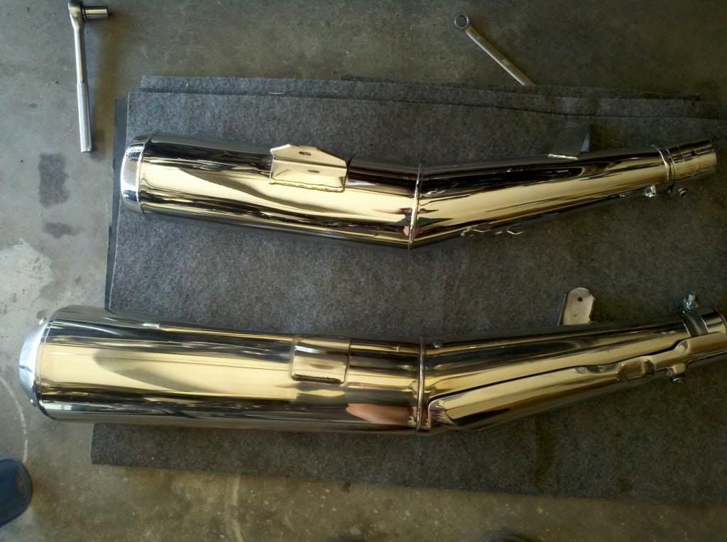

I couldn't wait so I installed the Staintune today. Not a very thorough write up, but it's a very easy install.
This thing sounds awesome. If you want to give your CB1100 a little bit of an attitude, this is your muffler. Despite sounding somewhat aggressive, it also sounds classy. I wouldn't classify it as loud compared to some mufflers, but if you are sensitive about 'noise,' you might not like it. It also burbles a bit when you back off the throttle, not loud explosions like you hear on some Harleys, but, well, burbles. I love it. Anyhow, on to the pics:
This should give you a good idea of the difference in size -vs.- the stock muffler.
[url=http://s173.photobucket.com/user/cyrenus/media/Staintune8_zps216e1450.jpg.html][Image: edf923217da63fad05fa9b489c87be44.jpg]

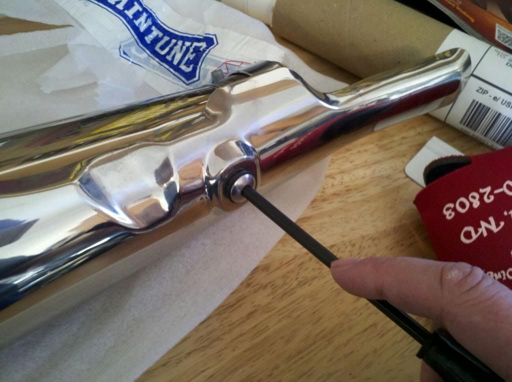

You have to remove the stock heat shield and transfer it to the Staintune, which already has the mounts for it.
[url=http://s173.photobucket.com/user/cyrenus/media/Staintune9_zps4388f30e.jpg.html][Image: 7b5b2e92ed3d25f786b496759af44781.jpg]
There are little rubber cushions on the heat shield mounts that were difficult to slide onto the Staintune's similar mounts. The easy solution was to remove them from their homes (as shown in the picture) and place them onto the new mounts (on the Staintune) and then slide the heat shield mini-brackets over them. Problem solved. You'll have to scroll up to see the Staintune mounts as compared to the stock ones. Other than that little thing, the rest of the install was easy-peasy. You use the same muffler hanger bolt that came with the bike. So, slide the new muffler on to the stock collector pipe, loosely mount the rear hanger bolt, tighten the clamp down by the collector, and then do a final tightening of the hanger bolt. If you're worried about dropping the new (or original one for that matter) muffler during the install, place the box it came in directly under where it is to be installed.
[url=http://s173.photobucket.com/user/cyrenus/media/Staintune11_zpsf7c33848.jpg.html][Image: ca64d56aa2f374e02e5194451ddccad4.jpg]
Installed it mounts nice and tight to the bike. I'd have to say you do gain some cornering clearance due to it being shorter in length and of a smaller diameter. I didn't bother measuring height/distance/cornering angles between the two, however.
