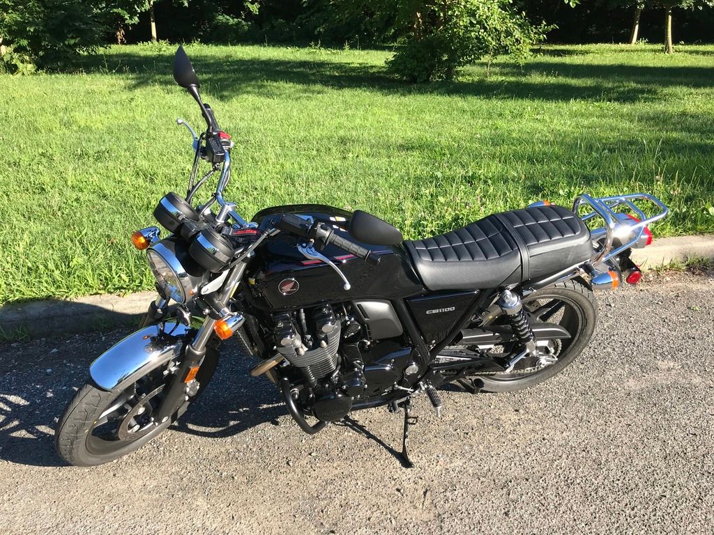

So, here is the follow-up;
When I initially installed the new seat, I had to use some force to get it to latch into place. Also, to remove it I had to pull quite a bit harder on the release behind the helmet holder. This "stiffness" went away very quickly and latching/unlatching feels now the same as with the original seat.
I don't notice any difference in height when my feet are on the ground (I'm 6' 0").
Darn, I wish I could just transplant the ABS too.
Here are some pics;
Original '14 Standard
[url=http://s1064.photobucket.com/user/mmdgn5547/media/IMG_3435_zpsllirhsku.jpg.html][Image: c0d9793e332a2eaaa6bdea2f32f49f39.jpg]
'14 Standard with '14 Deluxe seat
[url=http://s1064.photobucket.com/user/mmdgn5547/media/IMG_3446_zpsircufvmv.jpg.html][Image: 8cb300955d2dba063366078d05c4425f.jpg]
[url=http://s1064.photobucket.com/user/mmdgn5547/media/IMG_3447_zpsxa58dscl.jpg.html][Image: a9f714cc1b5f3ba5a523f7c9533f736d.jpg]
[url=http://s1064.photobucket.com/user/mmdgn5547/media/IMG_3448_zpsrufnfrwu.jpg.html][Image: e99574f2175d9973ab048c07fb6a1f50.jpg]
'14 Standard with '14 Deluxe seat, CB500F mirrors,
Givi SR1118 rack and SW-MOTECH crash bars
[url=http://s1064.photobucket.com/user/mmdgn5547/media/IMG_3528_zpsdbpzfb2w.jpg.html][Image: 8e94998deb0e5315668b3a793ef37ff9.jpg]
[url=http://s1064.photobucket.com/user/mmdgn5547/media/IMG_3527_zpsliftvarh.jpg.html][Image: 9031b84993e61f0b6f0db72d9dc9c7e9.jpg]
[url=http://s1064.photobucket.com/user/mmdgn5547/media/IMG_3526_zpsngf0thj0.jpg.html][Image: df1ffa7135ae2fff9387f01ba8f9c6ec.jpg]
