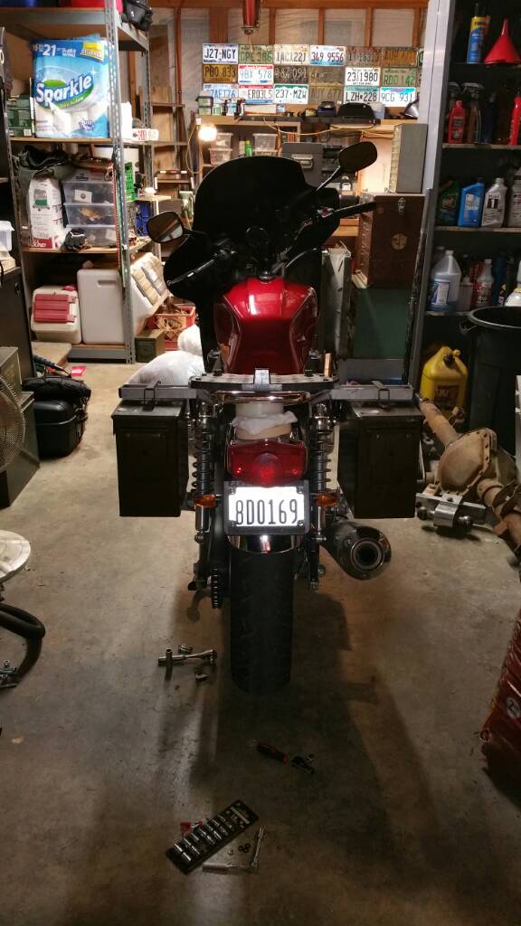

Here is a mockup of the new luggage.
[Image: dc187e36ff9e1e03169559bd4e352cf9.jpg]
[Image: 6630febebd72688bd6ca92040f978b5e.jpg]
Better pic with the rack.
[Image: 5e875cd81f7974152c86f0b588b7fb33.jpg]
[Image: 8496ec749bc31faa612b1751e0fa0862.jpg]
[Image: 0a10a74fd2e9d20c482d66fbe4b929e7.jpg]
[Image: c259bf231041871756dfdf775a533269.jpg]
