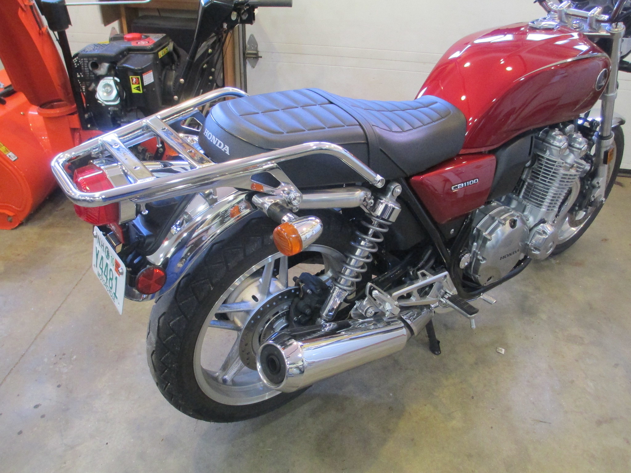

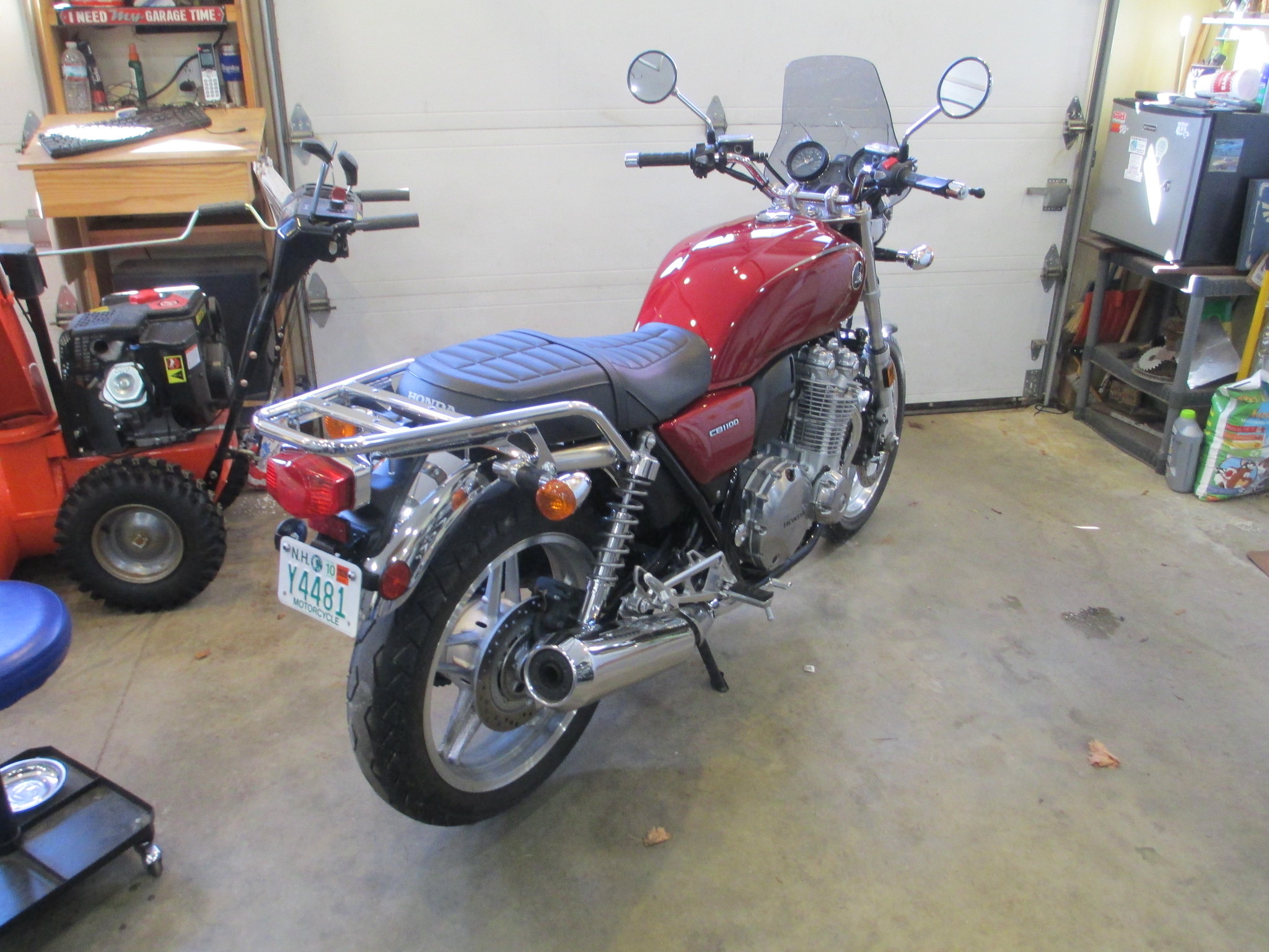

Just ordered this rack from Samurider last week, showed up in 5 days. Apparently no longer in stock domestically (US).
Just test fitting here:
[url=https://flic.kr/p/2hPPPgB][Image: 097066be566170d65d9060e7b263d326.jpg][url=https://flic.kr/p/2hPPPgB]IMG_5434 by [url=https://www.flickr.com/photos/185657922@N07/]Michael Vachon, on Flickr
Replacing rear garnish bracket on both sides:
[url=https://flic.kr/p/2hPPP16][Image: f50313b2047e5764c20162a9809f33d1.jpg][url=https://flic.kr/p/2hPPP16]IMG_5436 by [url=https://www.flickr.com/photos/185657922@N07/]Michael Vachon, on Flickr

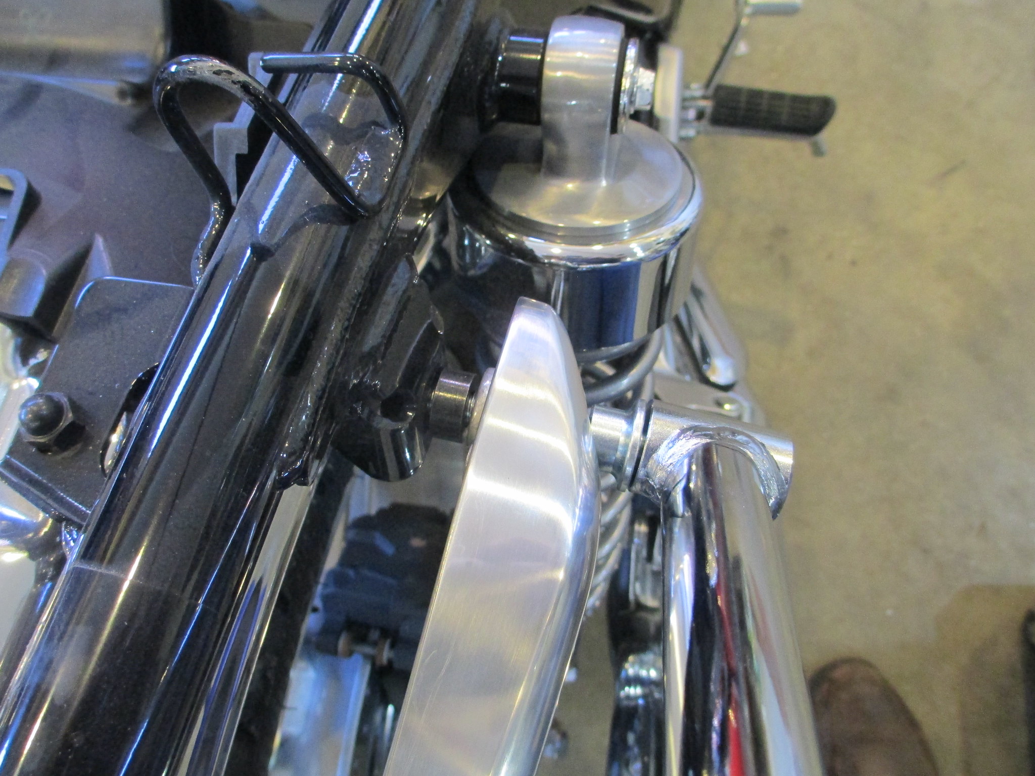

Lining up forward mount hole hardware, rack, flange spacer, garnish, OEM spacer... Trick is to leave everything loose until ALL bolts are in position.
[url=https://flic.kr/p/2hPPNz1][Image: db5aca5dd001c54bec750d07b62b6215.jpg][url=https://flic.kr/p/2hPPNz1]IMG_5439 by [url=https://www.flickr.com/photos/185657922@N07/]Michael Vachon, on Flickr
This was a bit of a PITA - Turn Signal housing interferes w/rear bolts. Figured out how to lift the rack up enough to clear those and start the bolts into the openings:
[url=https://flic.kr/p/2hPMe3Y][Image: b216ec2624c2e2963ccd35031d19361b.jpg][url=https://flic.kr/p/2hPMe3Y]IMG_5441 by [url=https://www.flickr.com/photos/185657922@N07/]Michael Vachon, on Flickr
All bolts loosely installed. Time to snug everything down!
[url=https://flic.kr/p/2hPPNmf][Image: 639a1050ca30b749cda203639586369b.jpg][url=https://flic.kr/p/2hPPNmf]IMG_5442 by [url=https://www.flickr.com/photos/185657922@N07/]Michael Vachon, on Flickr
...and we're done!
[url=https://flic.kr/p/2hPMdMn][Image: 7a4e0fc16697fa4d986dc7545aa8644c.jpg][url=https://flic.kr/p/2hPMdMn]IMG_5443 by [url=https://www.flickr.com/photos/185657922@N07/]Michael Vachon, on Flickr
