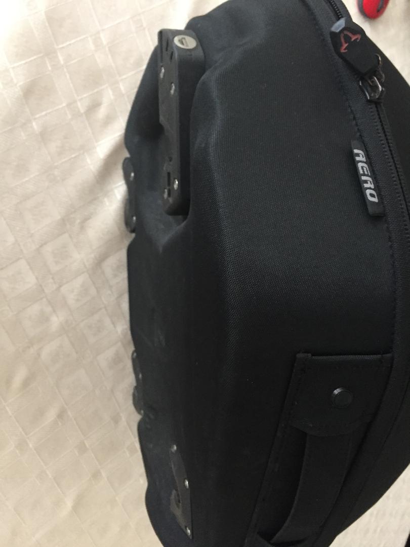

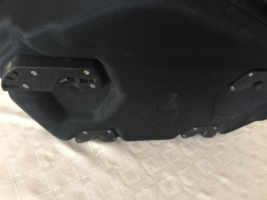

For these ^^ side racks, I use pictured bellow AERO side panniers , also by SW Motech:
[Image: 76c6571cdc395898e79650b13c19a901.jpg]
[Image: 842bcc2d5124932eb18f12c2afb20d54.jpg]
[Image: 8aa5aff96091283512cb773b3c4ae6b7.jpg]

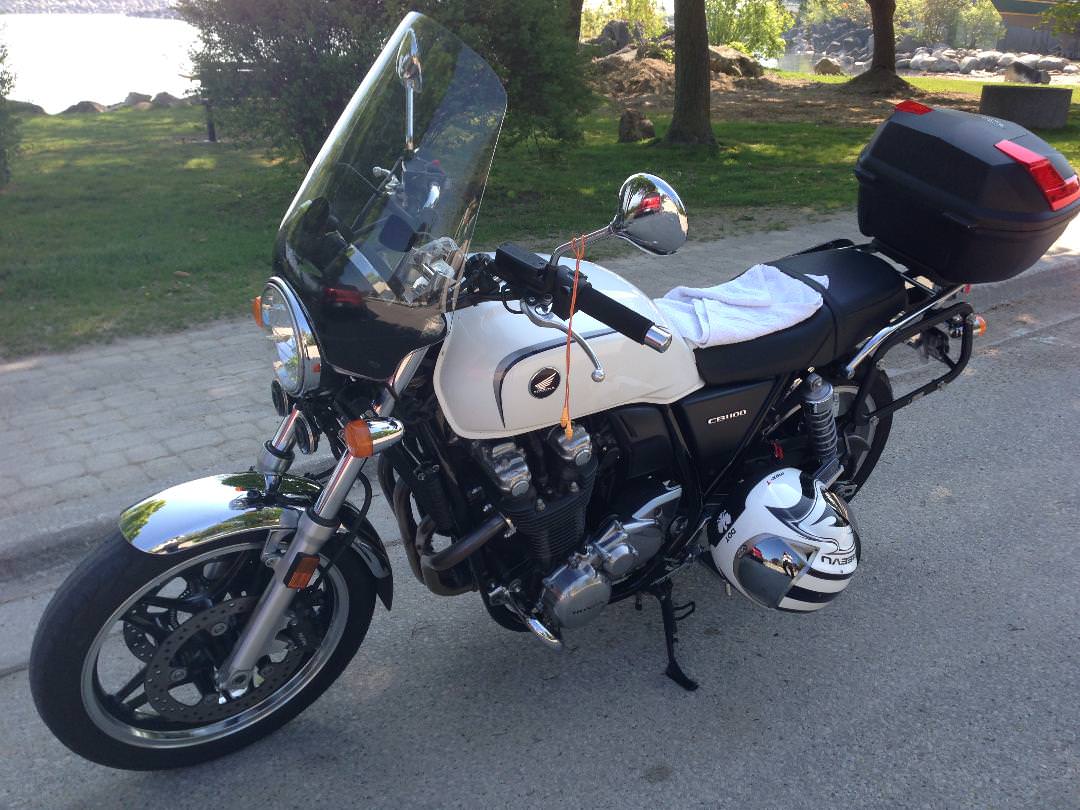

And this is how they look on my bike
[Image: 24d2fea3b7990fdf3a1abbbdcb5c29d3.jpg]
[Image: be02e6c34fac5ed36490f3aaa6eb5f6c.jpg]
[Image: ba22dfc8d1fccd1fc26c87400fcfb136.jpg]
Make sure you get the side racks with hardware matching your side panniers...otherwise may not work together.

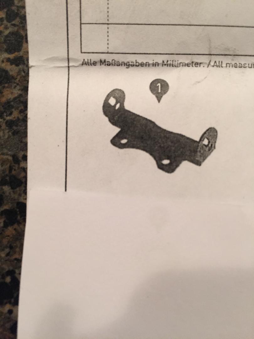

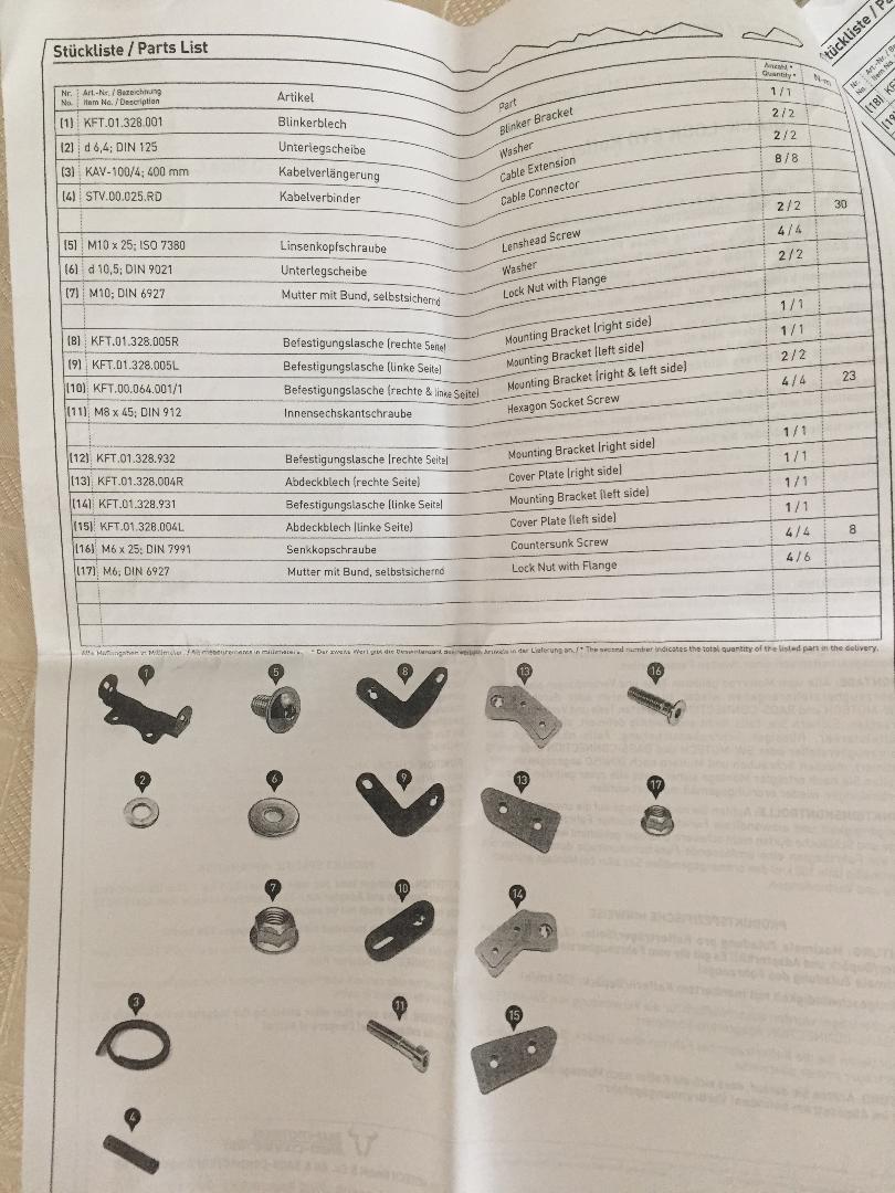

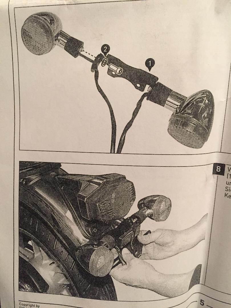

First pic below is a U shape bracket with 6 holes, OEM SW-Motech.
You can easily make it by urself from a nice piece of metal strap, shape it, fold it and drill 6 holes of different diameter: 2 bottom for the U shape bracket holding bolts, 2+2 wing side L+R to accommodate the turn signals. If you chose this design, you'll have to make one side turn signal's harness longer by about 1 foot, and I believe is the R-side, as the turn signals harness runs on the L side of rear fender, then you have to drill a hole below the stop light - in lamp's black housing to run the turn signal wires through it.
Here are some orientation pics:
[Image: 7b3f1ec9637504cb0e55493168dee5f8.jpg]
[Image: 76f2e1bbd756339f4cc86b55d276c6d5.jpg]
[Image: 363a28a1fa29b725a8cf46180e5040d1.jpg]
[Image: 72a33fe645f2123252f5111c8cb17d39.jpg]
This is what I did with my OEM SW Motech.
You may go alternate way and see if lic plate bracket + home made extension can accommodate relocated turn signals + both T-signals harness extension by 1-2 feet
