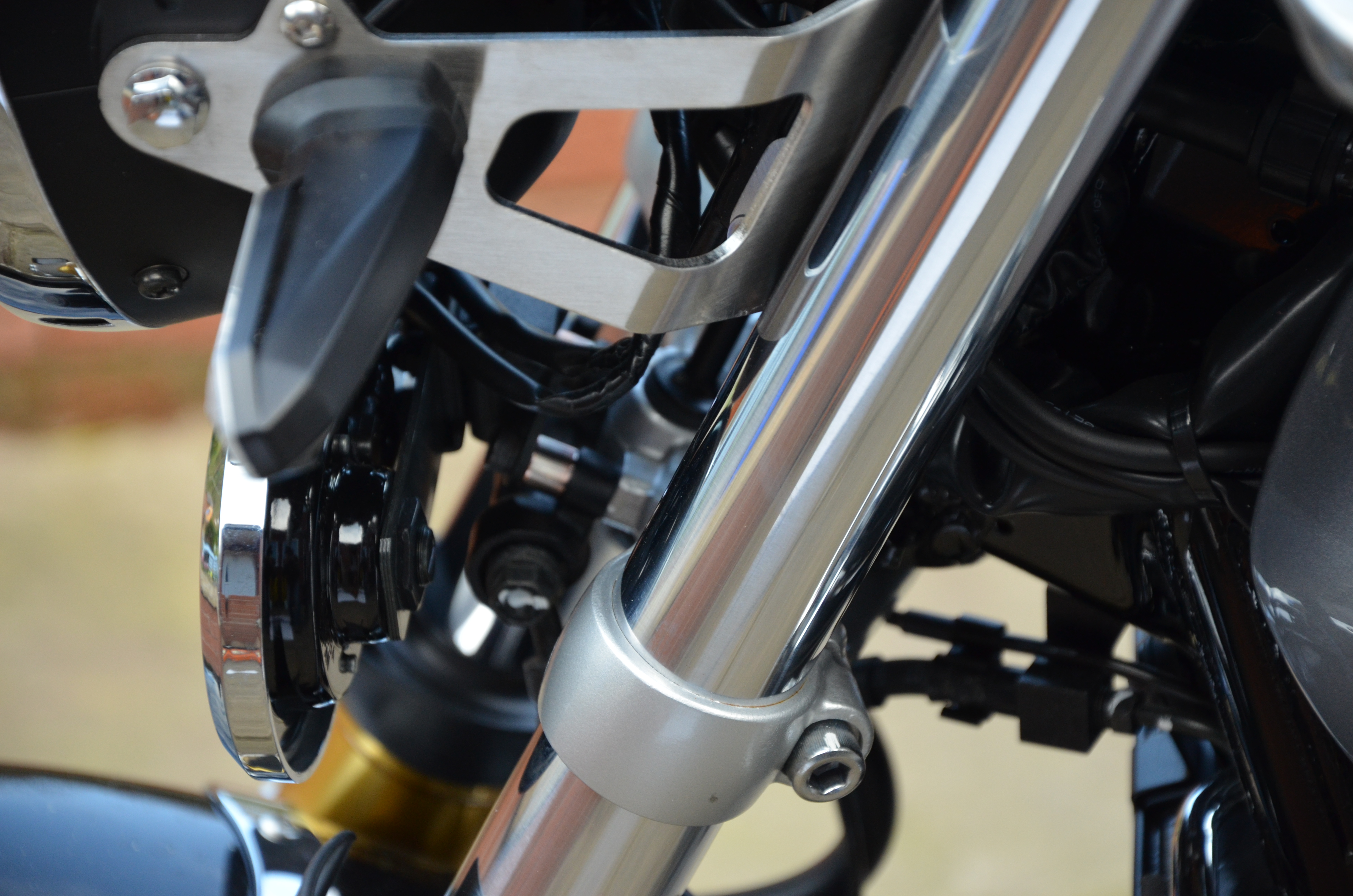

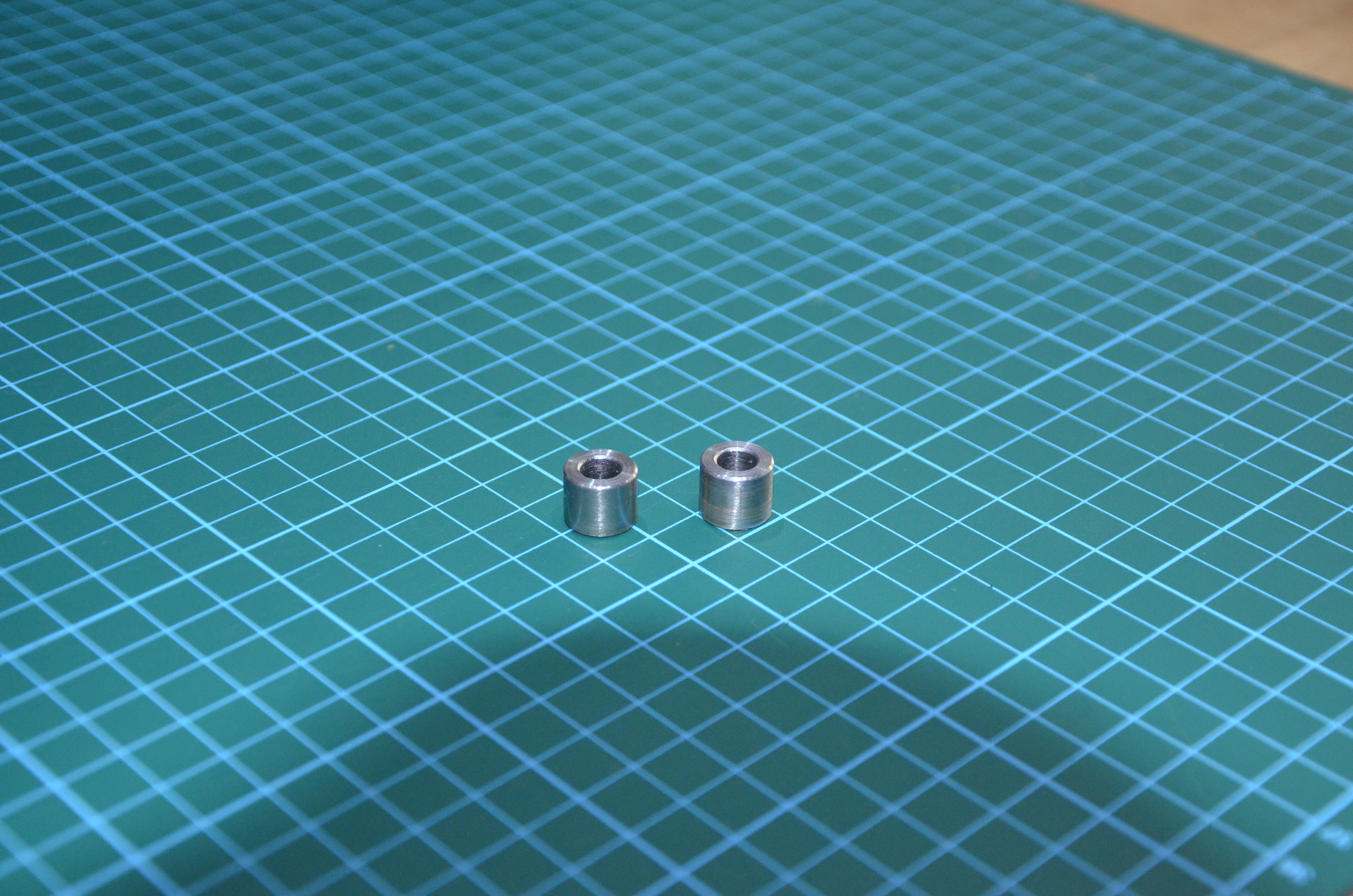

(04-03-2021, 03:39 AM)Tev62_imp Wrote: Addendum - don't do this with these Triumph ones, they just catch the horn on heavy braking. They sit a tiny bit too far forward but other designs may not. There is a drain channel at the base of these at the front and it holds the blade slightly too far forward to clear the horn. Blush
I fitted these on my RS and just fitted two 10mm spacers under the horn bracket, sorts the problem.
I fitted these on my RS and just fitted two 10mm spacers under the horn bracket, sorts the problem. I had thought about this, I might try it too. Beer
I fitted these on my RS and just fitted two 10mm spacers under the horn bracket, sorts the problem. I had thought about this, I might try it too. Beer [Image: 79ebf4b64524e19969f6c2051d2ed981.jpg]
[Image: eabede6d3eb62f6ca4e01e21f2d06110.jpg]
I just swapped out the original allen bolts for longer 35mm items.
If i remember correctly Triumph do actually make a shorter version of the fork protector, i believe for faired models but i chose to go with the longer variant for maximum protection.

Many thanks for the pics.
Yes, I thought they had shorter ones for the faired models too and I had ordered these for my Daytona from the Daytone parts fiche but they are too long for that aswell?
