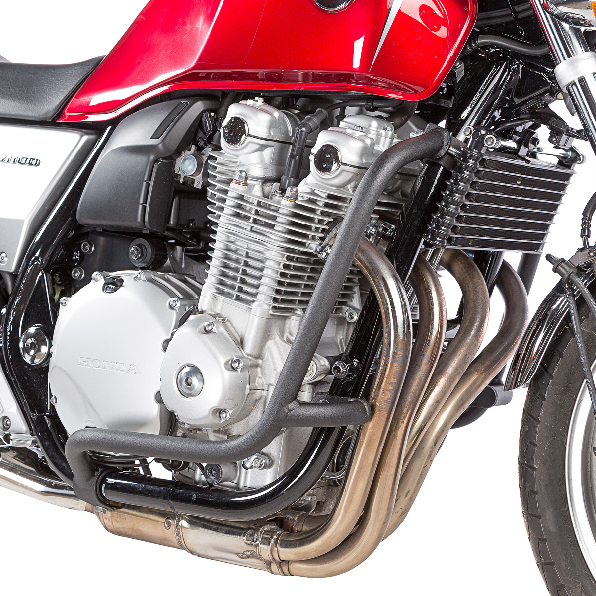

Those have a nice C.H.I.P.S. look to them.
I am trying to imagine them in a crash though-
[Image: cfb48660c0b1c58097782372f6ce96ed.jpg]
My fear is the middle section mounting easily taking out the exhaust header.. the lower mount appears easily rotate inward and take out the engine case, and the upper mount, same thing- easy rotation could take out the cyl head or valve cover, or both. There is only 1 hard mount for the entire bar (center) and it looks poorly located.
I'm no structural engineer..and they do look cool, certainly better than nothing, but compared to the Motech-
[Image: 69fc666db566dd9d0ef915f67f4deae3.jpg]
which have 2 hard mounts, with 3 bolts...and no real potential of rotation or penetration.
Would suck to buy those big ones hoping to protect a side cover and end up taking out the cyl head. For most people that would total the bike.

Wow, those Russian bars look like a proper stunta cage, until you look at the mounting a little closer. Been lurking on this thread, but sticking with my Morawaki frame sliders for now.

I feel the SW-Motech crash bar saved my left leg.
It certainly saved my engine.
The Russian bar has no stable mid-mount and will easily cost you a set of headers on a good impact.
