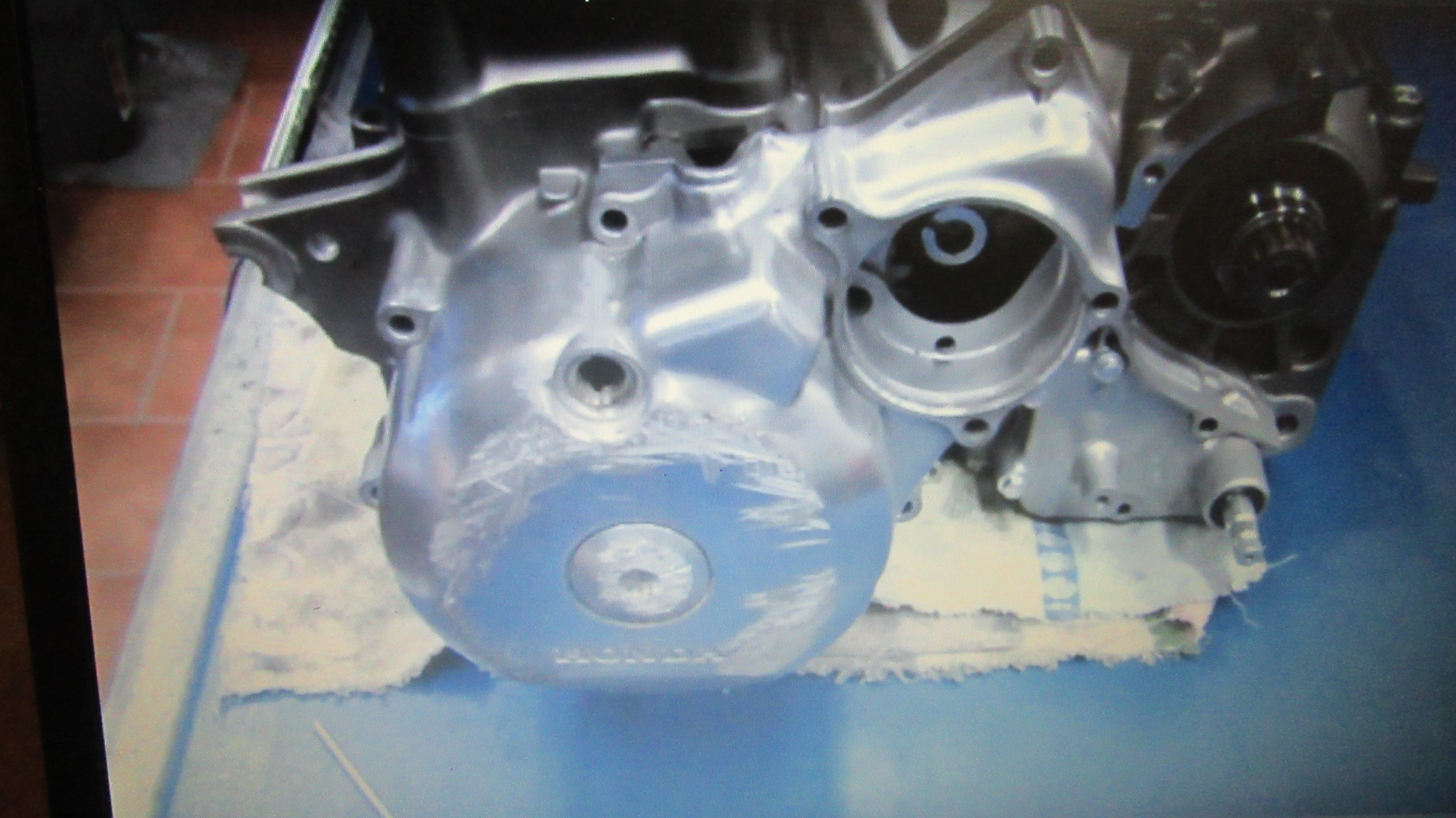

First of all you are all better off with the crashbars, of course, but i did find some info about the damage on the engine mounts.
this is from a cb1300 on" zam's channel " on youtube if you want to have a look yourself, the engine is strikingly similar to our cb1100 and mounts to a similar frame in the same way, and i have no idea why it broke off since he did not mention it but some time later i saw him mount frame sliders on the same bike, they were however plastic by the looks of it, here are some pictures i took of the video;
[Image: a2e3169226c2816685da6792dbcb67bd.jpg]
[Image: a0395f7795845d0c045d6a0cb687d0af.jpg]
[Image: 14334a1f18c6345f81e3bead2a5ed2c1.jpg]
and the video; https://www.youtube.com/watch?v=R2jSb_mxypc
Not to disagree here with anyone's choice but wanted to show the result of an accident.

Well-spotted, Max.
I think these CB engine mounts are disgraceful for thesereasons...
1. They are placed too far to the outer edges of the crankcase where they are very vulnerable to being struck
2. They are grossly insubstantial. If I recall, my '72 CB750 mounts were bigger affairs that went right across the engine from one side to the other, with one big long bolt securing the two sides.
3. This is from a world-leading manufacturer, so you wouldn't expect these sort of errors.
As a result of 2017EX, Houtman and other's observations on crashbars (my preferred protection) I have switched my intentions to buy from Hepco&Becker to the SWMotech offering - very similar bars but with two main differences - an additional metal strip between engine mount and bar mount on SWM, that allows a little flexibility in an accident and reduces "shock", and a different attitude to the mounting bolt - rigid and inflexible on H&B or "sacrificial" in nature on SWM.
