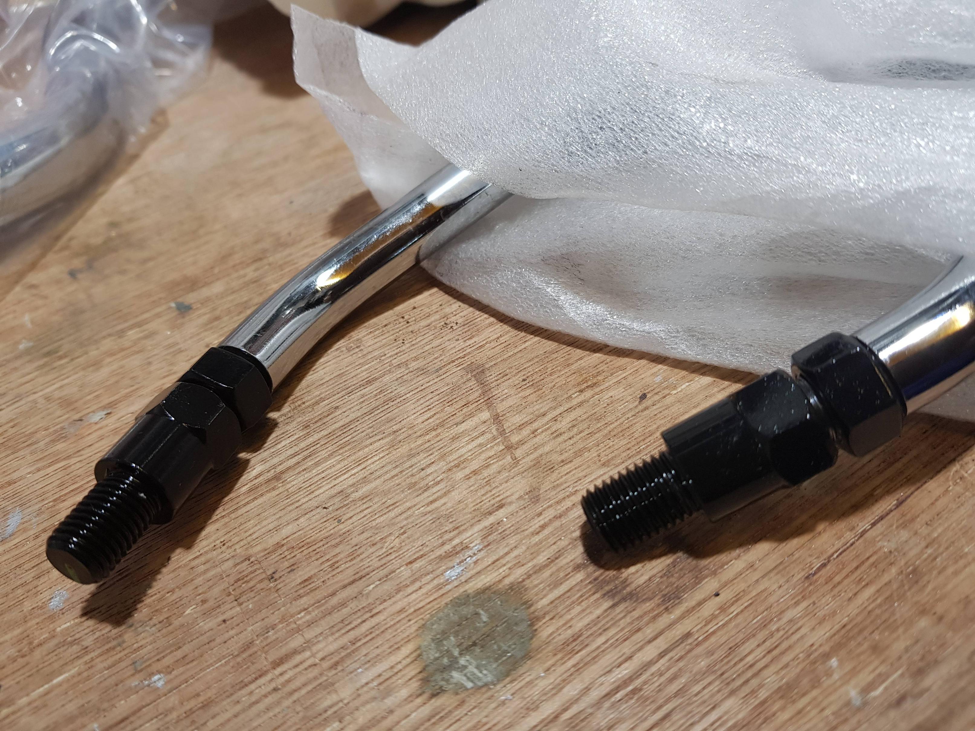

The wing mirrors don't need to be removed, but one of mine is damaged so it's being exchanged; plus it makes the reservoirs less ungainly when taped to the stick. The thread at the bottom of the mirrors was surface rusted - VERY worrying on a 'bike that's just months old! And doubly worrying that this is supposedly a quality 'bike. Both screws were restored to 'as new' with the ACF50, with the knowledge that they'll be well-protected by it in future, under the little rubber boots.
[Image: 36afc2348e41ac6d0dd907f67b50e101.jpg]
[Image: e01cf9ed26ffb539b1a521a2811de0d8.jpg]
The mirrors have a left hand thread to undo from the adaptor that screws into the reservoir (right hand thread!).

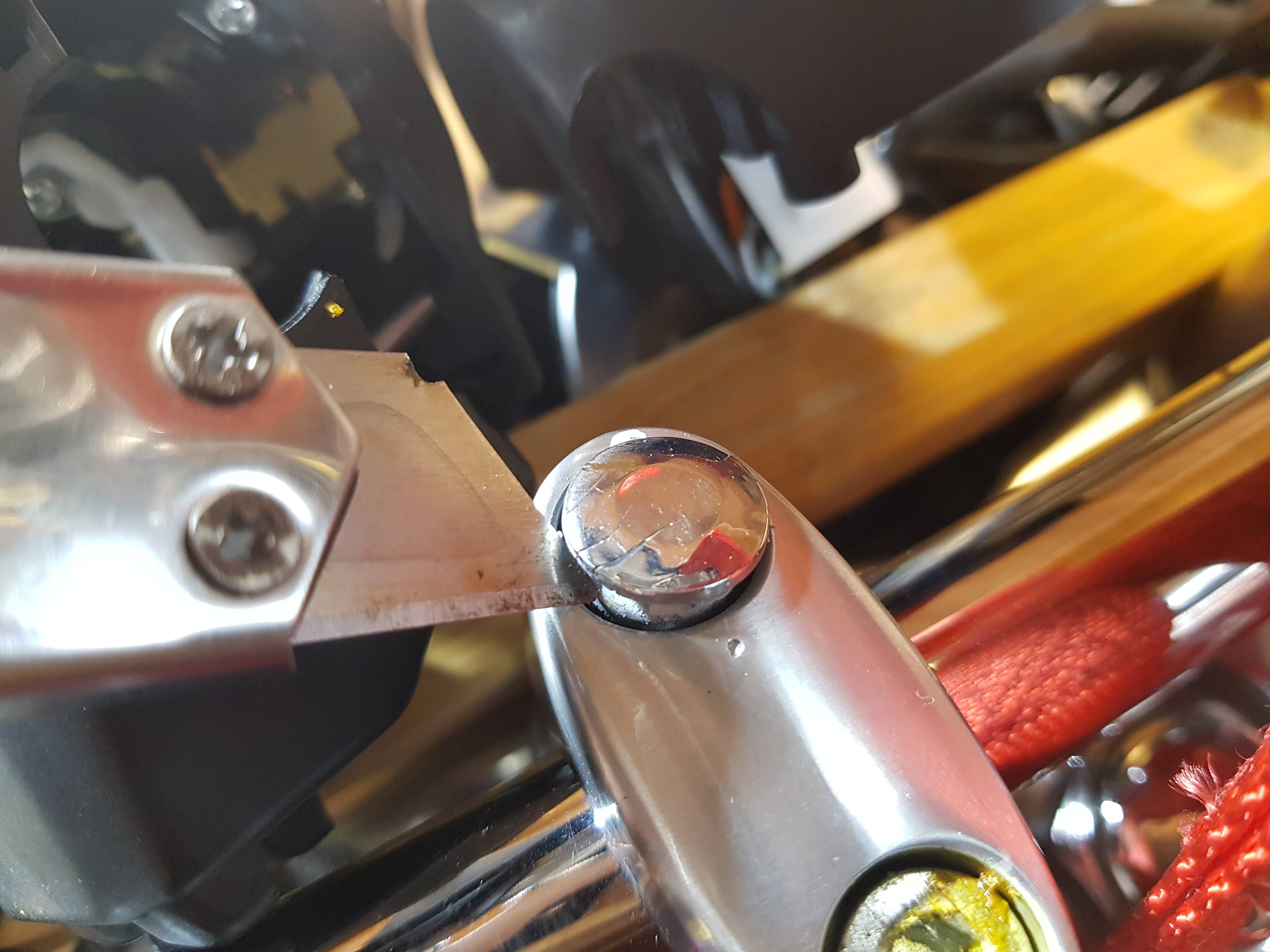

When all parts are removed from the bars (except for the throttle and left grip) lift off the decorative caps on the handlebar clamps, using a craft knife blade - they are just push-on but tricky to flick off.
[Image: 01407dadaeb501870b5255c42bdb6ade.jpg]
