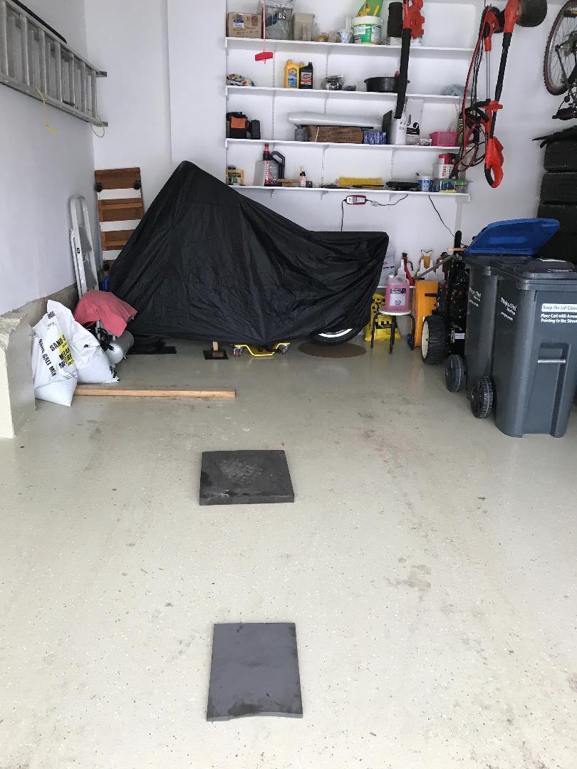

Sorry, no video as the bike is hibernating.....pics will do instead:
![[Image: e5f3c04308ef56176d3600f760836b08.jpg]](https://cb1100forum.net/forum/uploads/imp/202101/e5f3c04308ef56176d3600f760836b08.jpg)

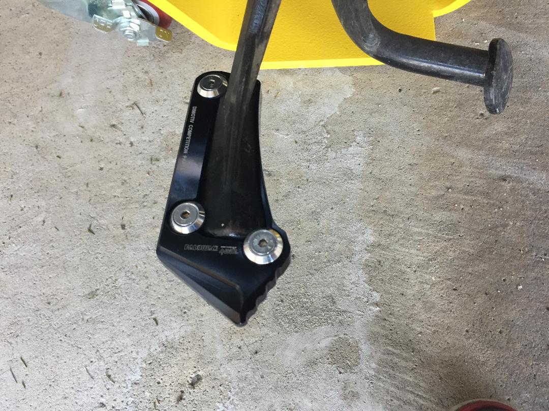

Rubber pads on garage floor, most likely 1" thick but also have a thiner one of 3/4"..or if needed any thickness
If rubber pads are too thick, any bike will tilt more as the side stand automatically becomes shorter. So use pad thickness from 3/4'-1"
I also have a side stand enlarger that will compensate the eventual issue to a satisfactory degree.
1. ride on rubber pads
2. side stand out, bike parked
3. yellow dolly under the bike with all 4 casters locked (1,100+ lbs weight capacity)
4. lift the bike on a yellow dolly which has hard rubber casters for easy manoeuvring
5. remove rubber pads
6. swing/maneuver your bike as desired
I have epoxy floor in my garage, easy to maintain and swing my dolly around.
Video clip while practicing most likely in March/April.
I bought my dolly 2 years ago from Canadian Twisted Throttle but is no longer listed..??
US info, courtesy of our Lord Popgun:
https://admorelighting.com/product/park-n-move/
Made in Canada
P.S.
You can even park yours parallel to or behind Djang's
Seems like quite the apparatus and floor area. Hmm.
Nevertheless, should be cool to see the CB floating around to wherever it needs to nestle.

What is going on just to the left of the dolly? Some yellow thang.
Why bother with a "pad" (?) under the rear tire? Isn't the tire off the floor?
