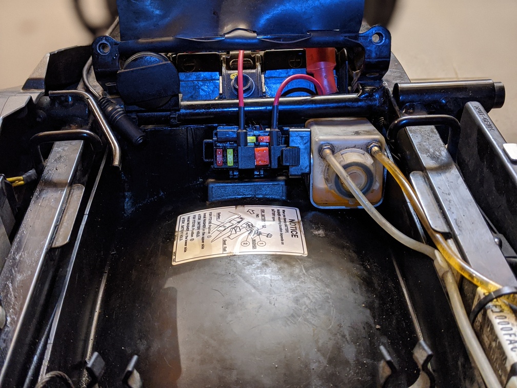

The fuse box is in the compartment under the back seat. A lot of road debris from the rear wheel comes in. Riding on salted winter roads may pay its tall here.
[Image: 1bdc46ad7a294a0830c2f060dd2ef771.jpg]
[Image: 87b391fa0aebc622bf5b141e242b1b49.jpg]
There seem to be no terminals at the end of the cables. Looks like they are directly crimped to the fuse sockets. So, the easiest way to come around for me was to use these kind of fuse plugins. Don't know how to call that in English. Here I crimped one to the red power supply:
[Image: c81413ac93a73522f0829739aee3c1f3.jpg]
Then it fits into the fuse socket, the right one. The left one is a tap to connect my Garmin GPS device.
[Image: 14cabcc447d200c1c89c479dc7aa301f.jpg]
[Image: bf7902aea87b1a6f9179d34e240fc03a.jpg]
Used a lot sulfit cleaner
[Image: 1cbc6e4fb39255643dc91e2806633f2a.jpg]
and greased it after that. Hope this workaround works for a while.
