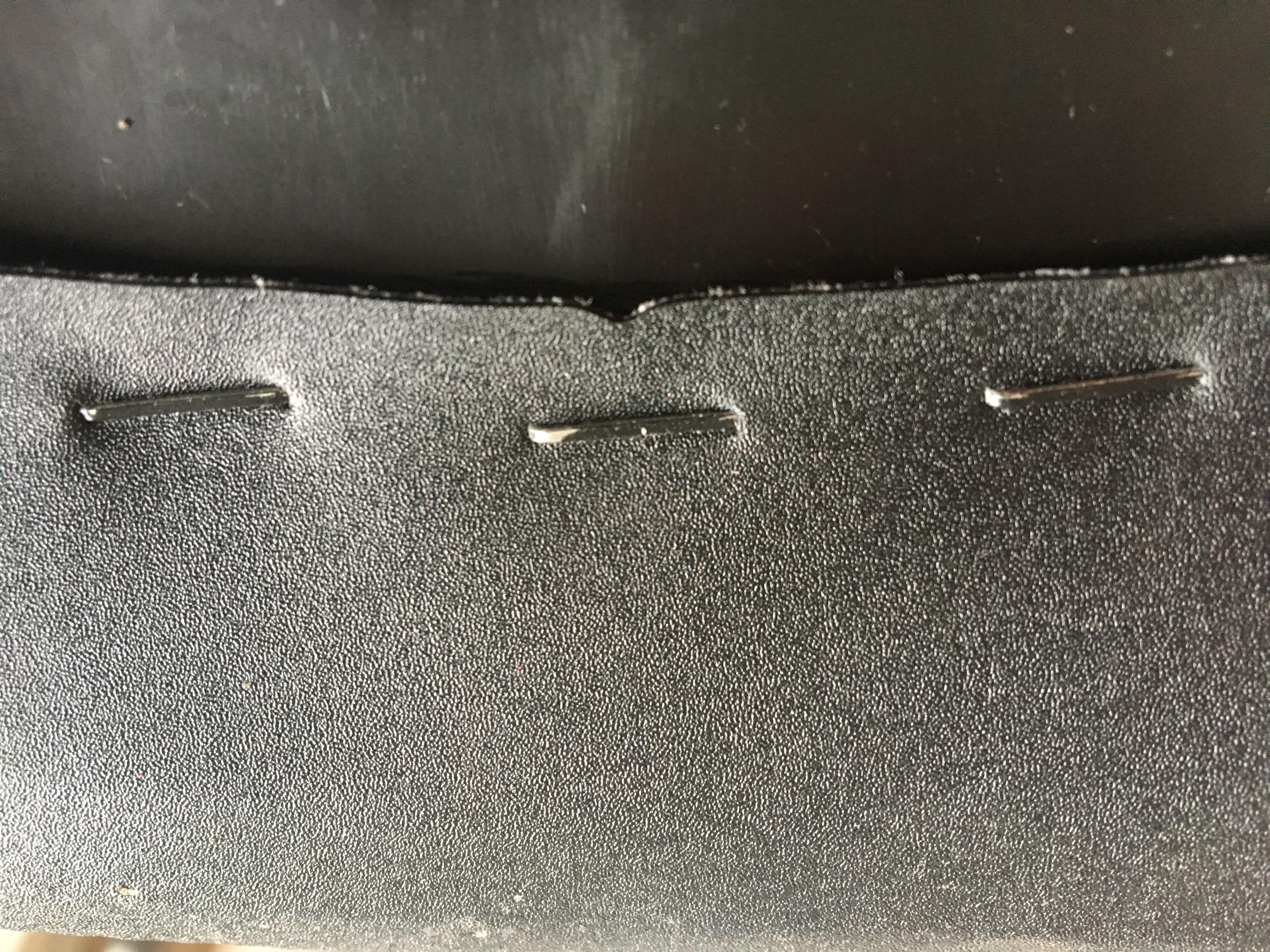

Thought "what the heck?!, how did that get there?" Then I placed the seat back on w/out snapping into place to see what might be the cause. I slid my finger under the front edge of the seat and could feel one of the seat staples protruding out a bit more than the others and this lined up exactly with the wear on the tank.

You can see where the middle staple is worn on the edge:
[Image: ca33fce28d9030508cc5217d59bd595b.jpg]

If you own an 17'EX type of tank, you might check the staples on the leading edge, and if they protrude at all, tap them back in.

and take a tack hammer and hammer the staple in
(01-12-2021, 12:44 AM)The ferret_imp Wrote: and take a tack hammer and hammer the staple in
Big GrinBig Grin that would have been my first suggestion. Tackle the offending problem first.
