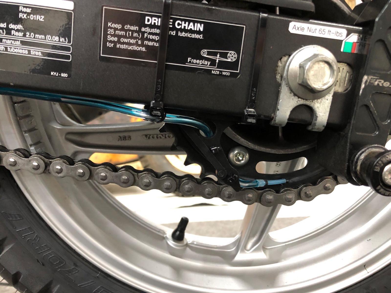

(02-18-2019, 12:54 AM)GoldOxide_imp Wrote: (02-18-2019, 12:39 AM)The ferret_imp Wrote: GO how about a close up pic of the unit mounted on your bike?
I elected to mount externally, however, the alternative was in my under seat "storage" cubicle near the battery. But my cubicle was full of stuff and at the time I was unsure how well the Tutoro would perform, so I mounted it externally thinking I could easily remove it if I didn't like it. It has been in place for four years.
And the close-up ...
The drip tube basically runs down, then along the swingarm, and then lays on the lower hemisphere of the rear sprocket just above the passing chain links.
HT to @GoldOxide on this one! Really awesome piece of kit.
Hey ya! Clever Stich.
Have you put some mileage on the device? Where do you find your setting? e.g. 1 turn, 2 turns, 3/4 turn? ... etc. at say temperature of 68F.
Currently my Africa Twin it is set to 1 turn. By summer it will be about 0.75 turn. Winter it is about 2 turns.
