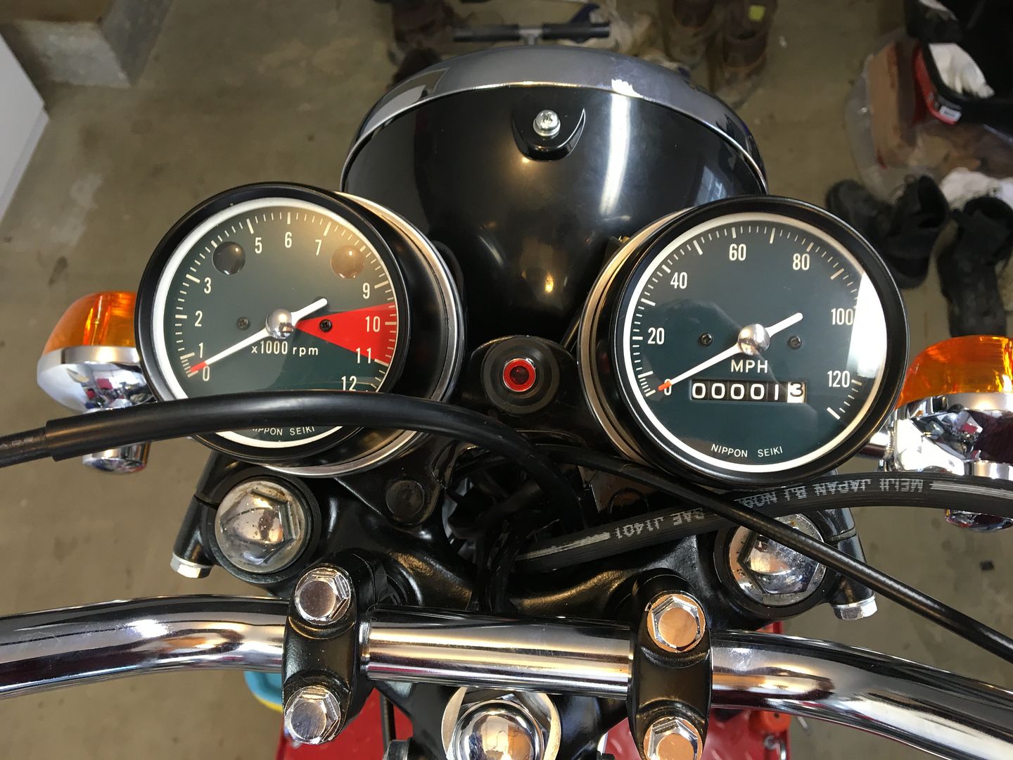

I wasn't happy with the fitment of the gauges. I was having clearance problems hooking up the speedometer cable, it was hitting the headlight bucket. I got a different mounting bracket with the high beam indicator in the center of the bracket. That moved the gauges farther apart and gave me the clearance I needed. I like the look too.

Looks good, Mike. Wasn't the original high beam indicator the left hand light in the tachometer?
02-20-2016, 09:23 AM
(02-20-2016, 08:29 AM)Cormanus_imp Wrote: Looks good, Mike. Wasn't the original high beam indicator the left hand light in the tachometer? That's the neutral light. It was originally in the top of the headlight bucket. I'v got a disc brake front end on it so the gauges aren't original to the 68. I think its a 72 front end. (02-20-2016, 08:18 AM)Chapomis_imp Wrote: Nice work Mike, very inspiring. I need to find a worthy opponent for my efforts.Pick up a 750, there are plenty of parts around.
02-20-2016, 09:24 AM
Of course it was. Thanks Mike.
