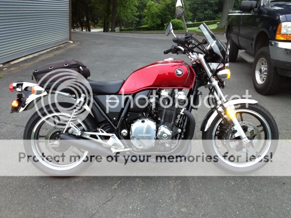

OK shield is mounted up. Got to say I'm no real fan of the look, but I'm going for function here, so if it works I don't care what it looks like.Once it gets a little warmer (20 degrees below normal right now) it will go back to the naked bike I love unless I really really like it. I am at just over 10 1/2 above ign. May get to test ride Tuesday when it warms up a bit.

The shield is to upright, has to follow the angle of the front forks. Push forward the bottom and pull in the top so its more inline.
[url=http://s1034.photobucket.com/user/cipolla57/media/CB_zps2f6aa630.jpg.html][Image: 6c961d9561312334f7ae697668503e7f.jpg]
Bring it right to the edge of the headlight:
[url=http://s1034.photobucket.com/user/cipolla57/media/photo2_zpsf4378abd.jpg.html][Image: 18234a6a701e01b8e0a574256ef8490f.jpg]

CIP had it pulled forward but was getting some headlight reflecting back in it on the right side for some reason. Do you see any light in yours? Also I have the chrome cups and don't want the shield rubbing against them. I can' probably adjust it a little more.
Ok just went out and brought the front all the way out to the edge and the top in a little more. Will see how it goes. Just need to test ride with big crescent wrench for top nuts if adjustment is needed lol.
Trey CIPs is a 2013..different gauges, different headlight height. My headlight is 1" closer to the gauges. Makes that angle different on the shield.

Where mine is now i don't get any headlight reflection at night, more forward lights up the shield. I set mine on the gauges then backed off 1/8" not to get any vibration.
