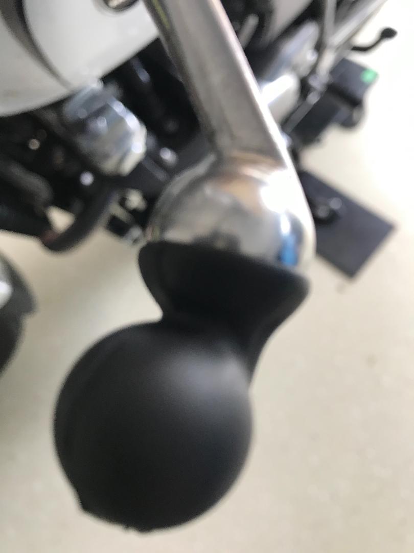

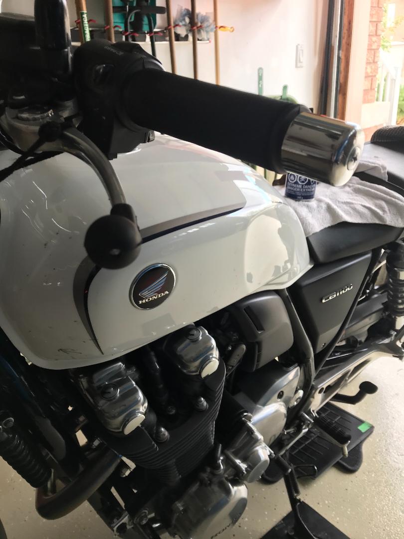

I love your reports 9m...hope you don't mind if I present my small modest update Tongue
[Image: 26369d8d072b748ffb7fd146b693d4bc.jpg]
[Image: c3a7d6a2098954dd786ed637e127aac6.jpg]
[Image: ff15800d28531277134d1976cd164d3a.jpg]
Big GrinBeer
