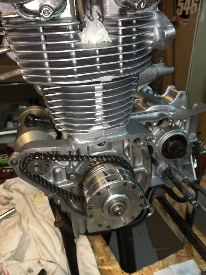

Starter is in and operating. The starter clutch,chain and everything behind the flywheel was missing when I bought the bike. Had to find the parts and rebuild the starter motor, all that would do is screech.
[url=http://s1190.photobucket.com/user/Mike_Bova/media/CB450/EBD72805-BBB2-4FC1-8C7A-0FF991A3D0CB_zpsy2co6opd.jpg.html] ![]() [url=http://s1190.photobucket.com/user/Mike_Bova/media/CB450/58734703-1511-41D5-A81F-FD0D296232E5_zpsnlbb36kw.jpg.html]
01-19-2016, 11:12 AM
Dang it is looking pretty!
