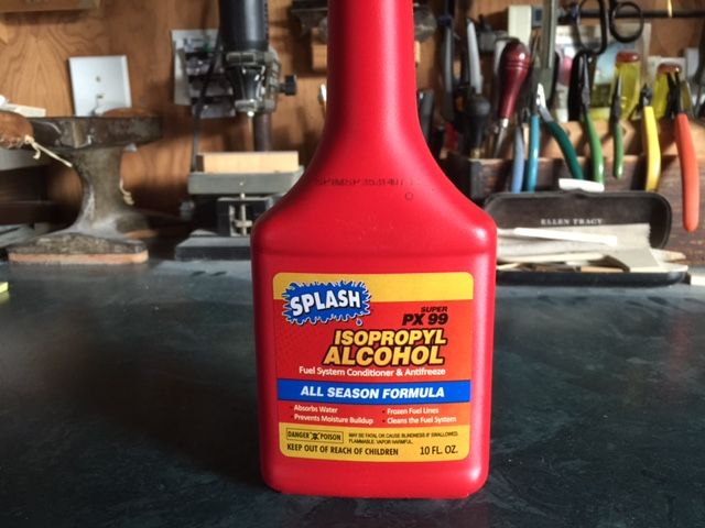

My CB started sputtering about 3/4 the way through its first tank of gas from the dealer, I stopped at a gas station and all they had for additives was this.
[url=http://s1298.photobucket.com/user/aswreed/media/Gas%20Treatment_zpsg74n9epm.jpg.html][Image: 07385caa306ba1c00145ae6106688e69.jpg]
I added about 3oz and topped the tank off. I have ridden it twice since, about 1/4 tank, and it hasn't sputtered at all !
It wasn't what I would have chosen for an additive, but its all they had and it seems to have helped.

(04-23-2015, 07:12 AM)Chapomis_imp Wrote: My CB started sputtering about 3/4 the way through its first tank of gas from the dealer, I stopped at a gas station and all they had for additives was this.
Yeah gas is horrid after three months these days. Down the Cape it would find a way to collect all kinds of moisture.
