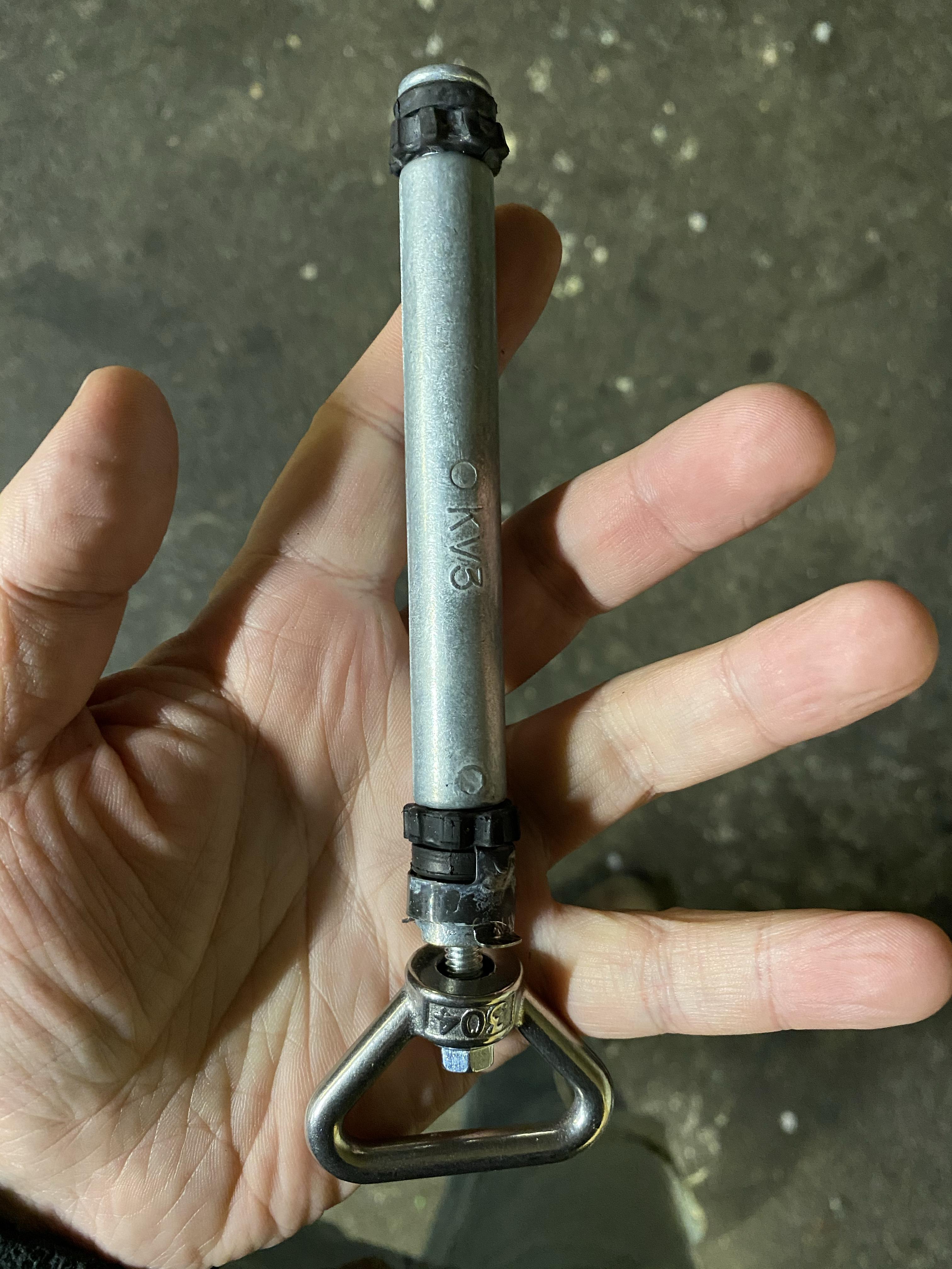

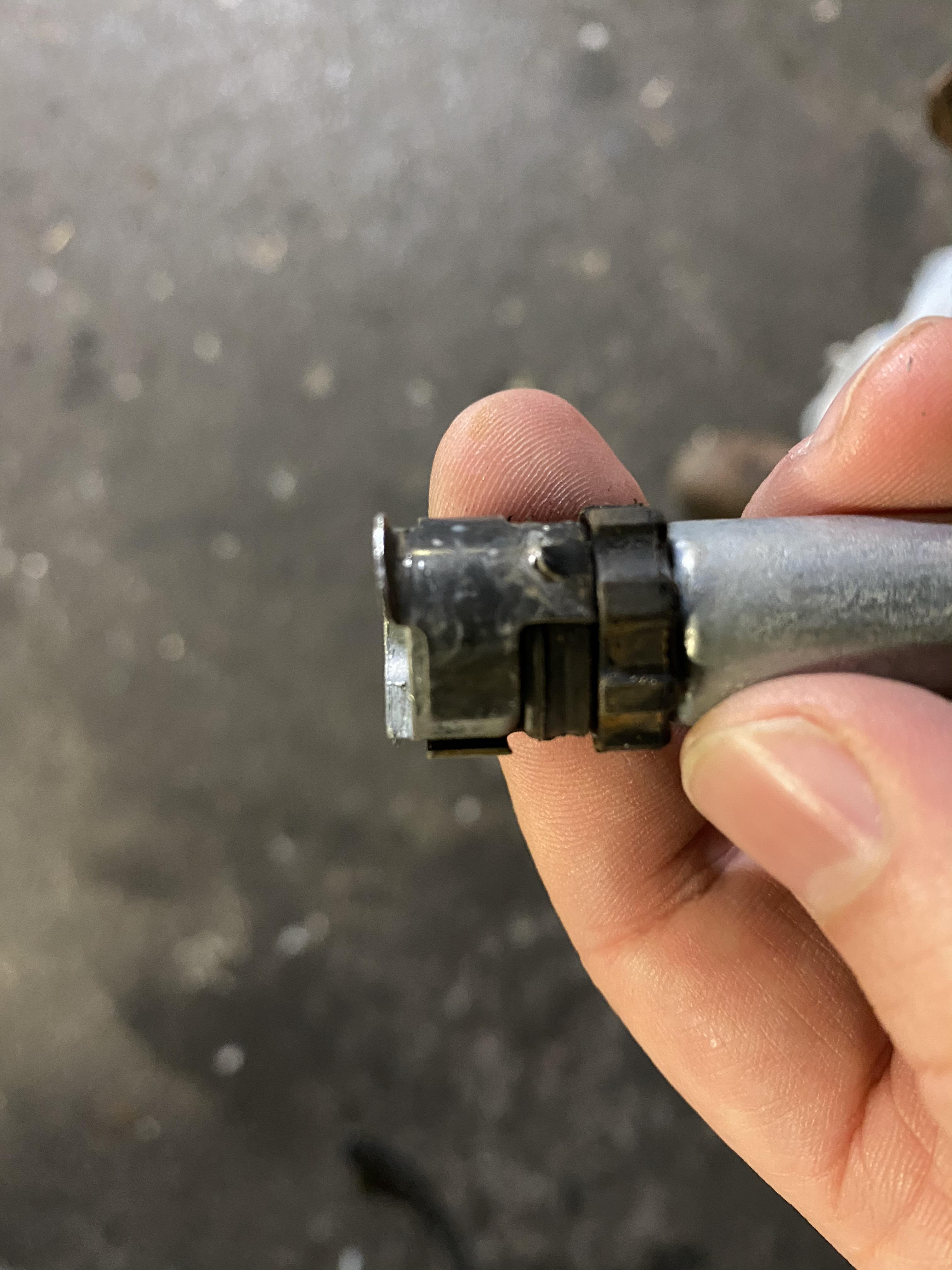

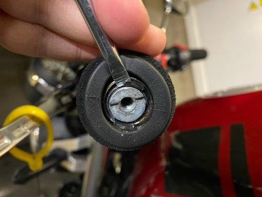

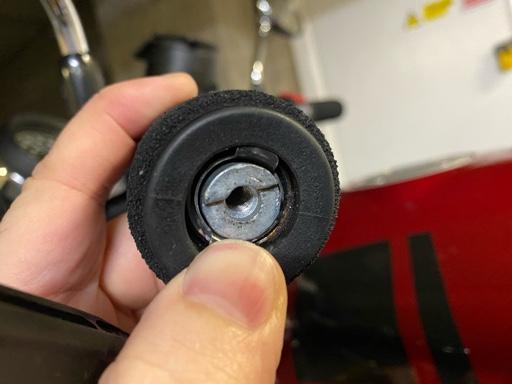

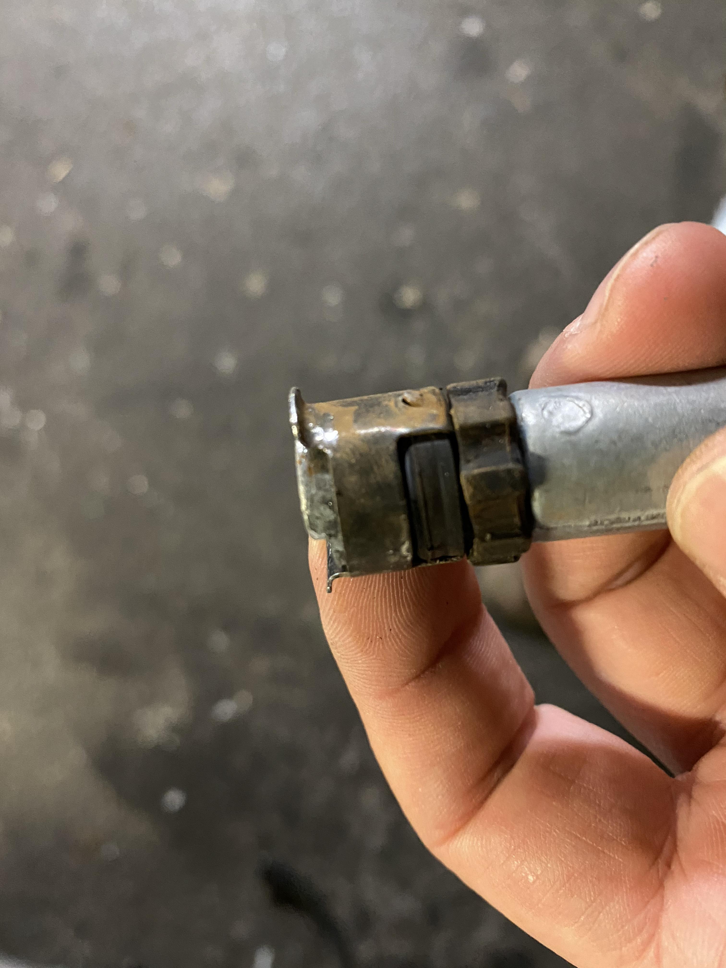

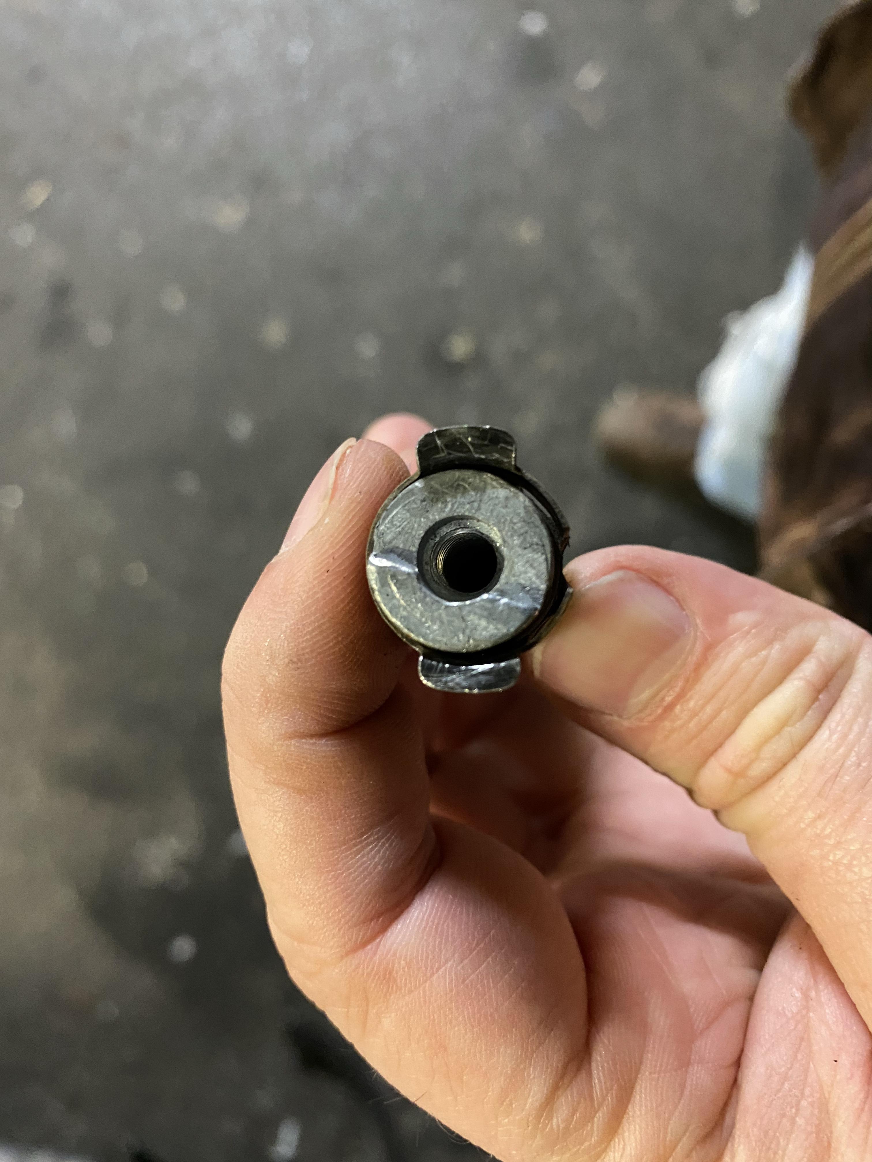

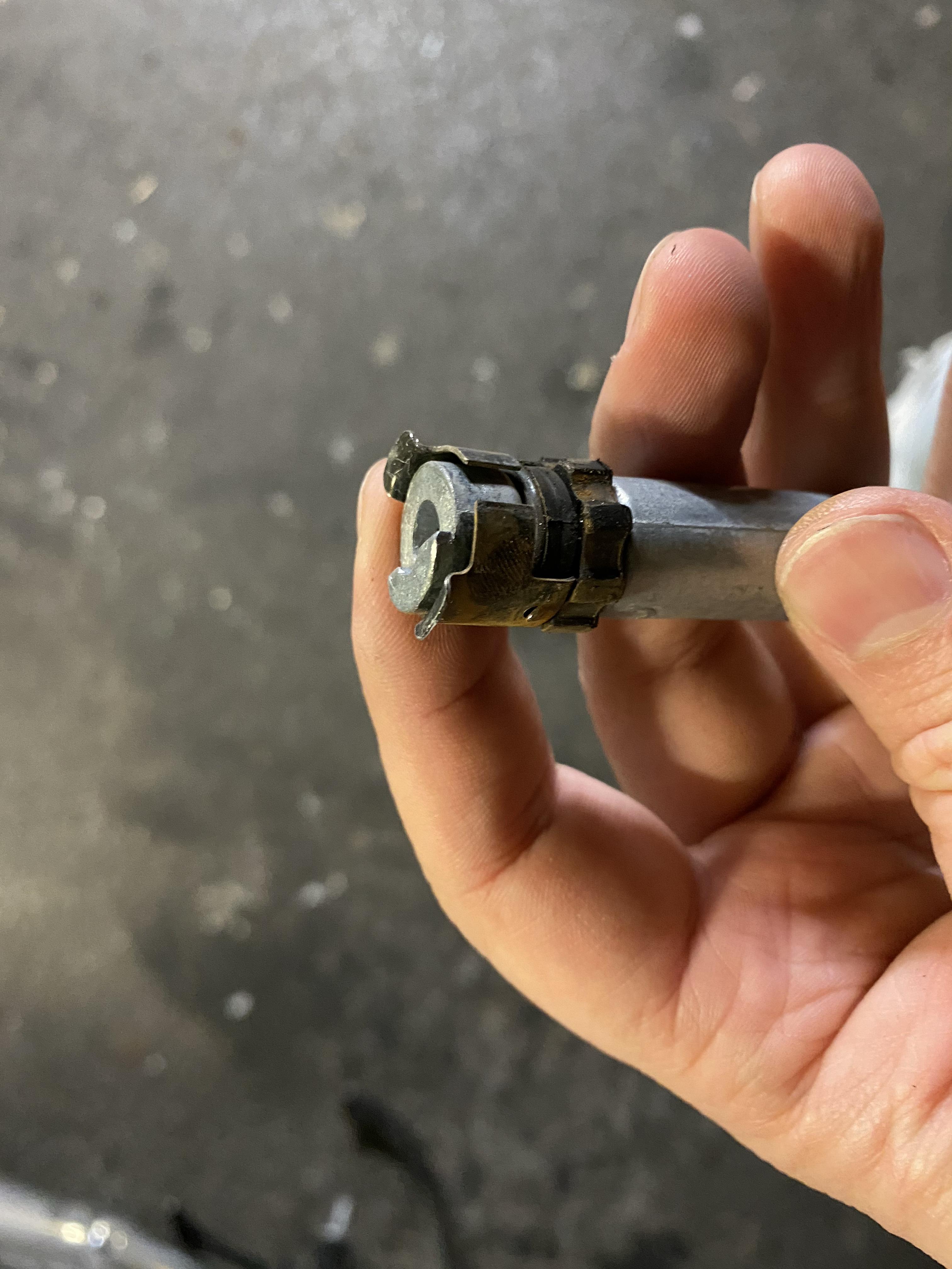

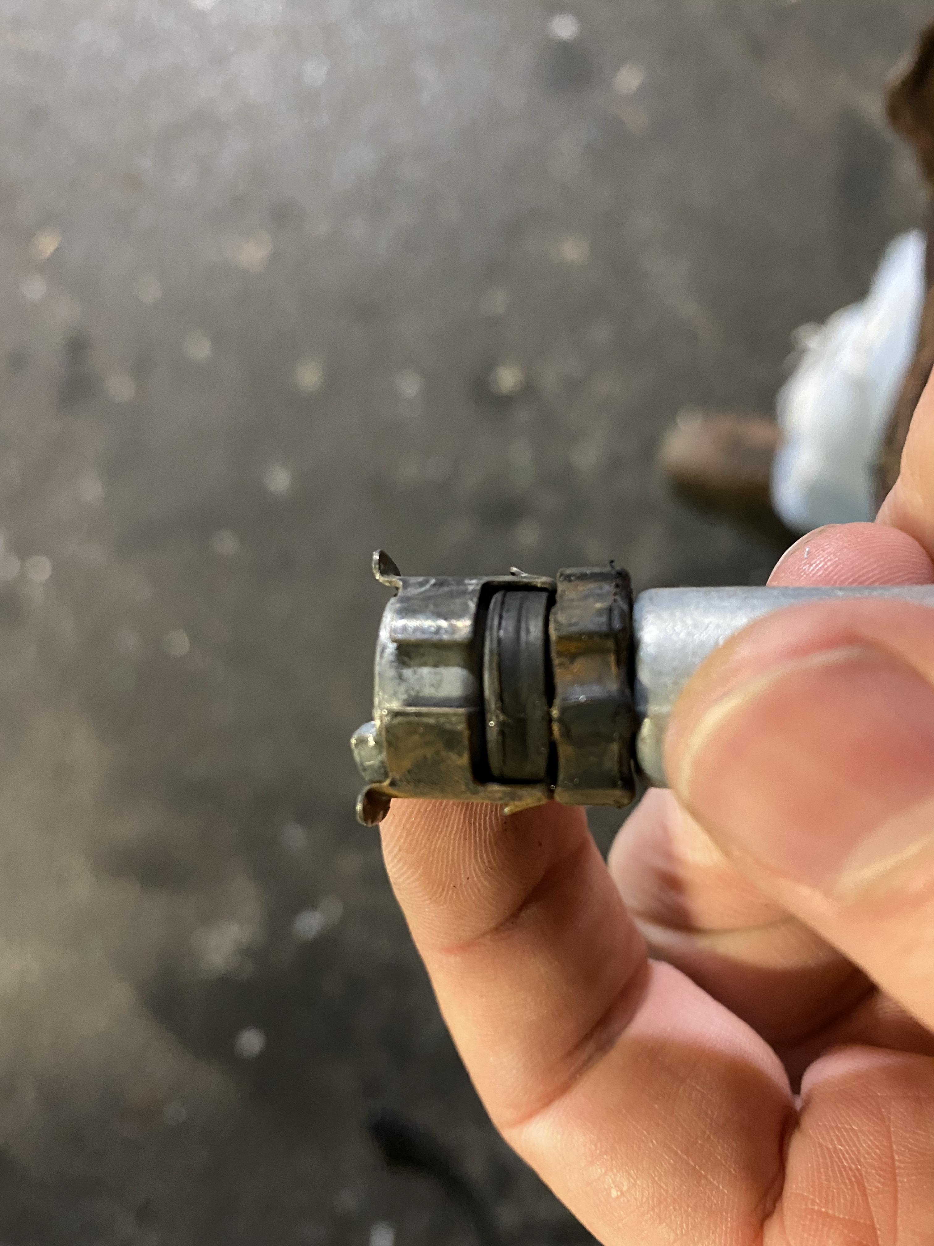

Hey, even though no one asked how to remove Honda’s cartridges from the handlebar - I found on YouTube lot of mysteriousness in the process. So I wanted to show that It’s actually a very simple job, and you don’t need to break anything. You only need to push two pins, and it comes off. See pictures.

Useful information, mrded. I see you've also posted it in the 'how to' section. Thanks.
