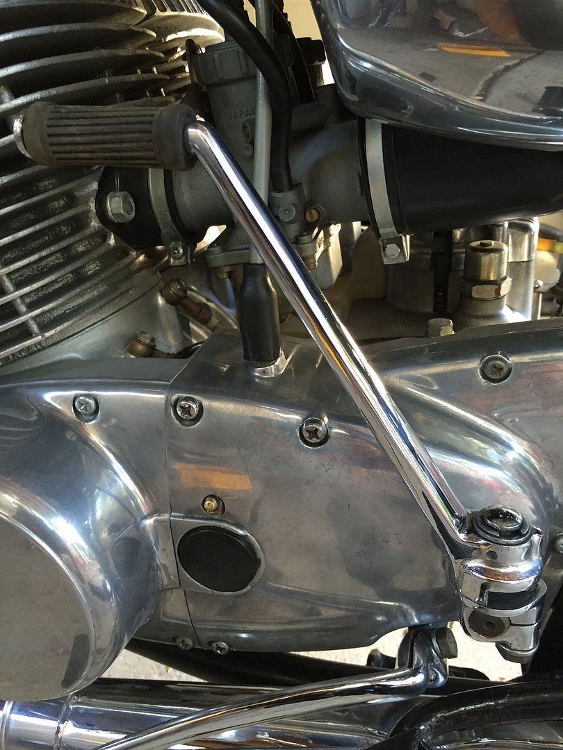

Whatever happened to the good old days when all motorcycles had one of these. My kawasaki Z1 has both kick and electric leg...Only because it had a habit of boiling the battery dry.

I will admit I kinda (okay, fully) wish that bikes still had kickers. There is something about kicking a bike to life vs just hitting a button that makes the man/machine interaction that much better. Yamaha made the new SR400 kick-start only, but other than that, I think the idea is dead.
