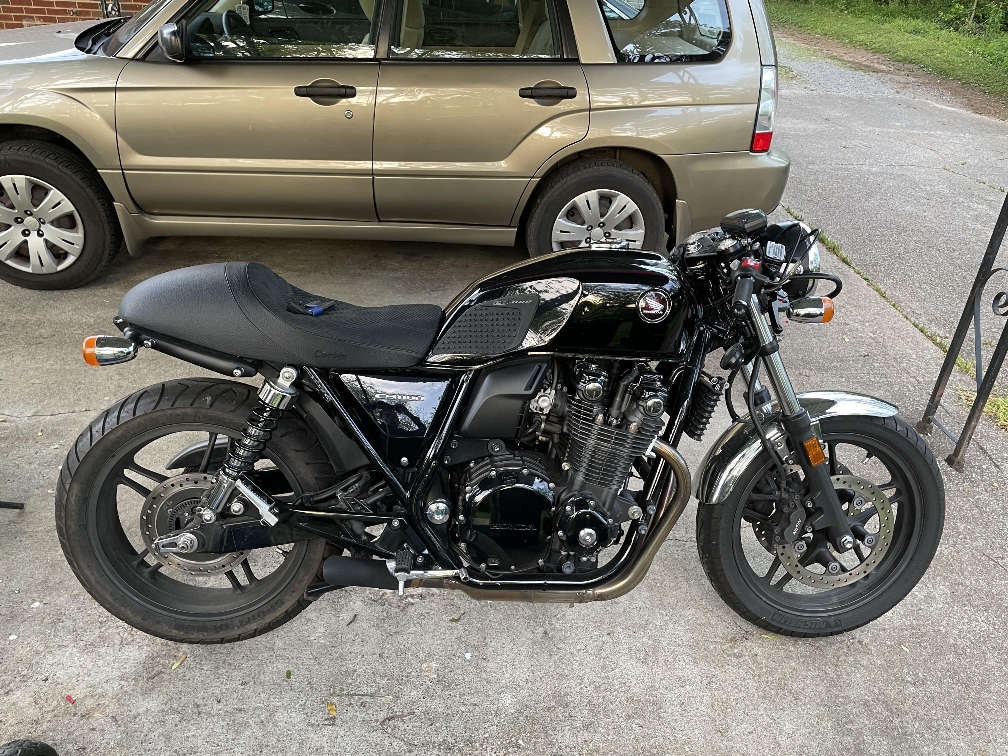

Hey guys, OP posted in the reddit cb page also so I'm posting the photos he had trouble posting here.
This is the Gauge computer he got from ebay and this is his bike with the low profile gauges installed now. Maybe the image of the computer will help the diagnosis.
I'm with Gone thinking that the gauge doesn't know what bike it's on so it is displaying the wrong RPM on the screen but I think the bike is behaving normally and the gauge is calibrated wrong and telling him he's at 5500rpm when he's really at the 8k redline.

I'm terrible at using this forum. The display on this meter is really clear and bright. I'm really impressed with the display. When I set it to 2 cylinders it seems to be the most accurate in it's rpm reading. It reads that it's idling around 1,000 rpm and it's rev seems accurate. The problem is that it redlines around 5,500 rpm. I rode the bike for a year before I changed out the meter so it feels like it's actually at 5,500 rpm, it's just acting like that's its new limit now.
I've read somewhere else on this forum that the bike ECU will limit the rpms in say 6th gear at about 5,500 rpm, and that using aftermarket meters could be giving the ECU a false gear reading making the ECU think it's always in 6th gear.
